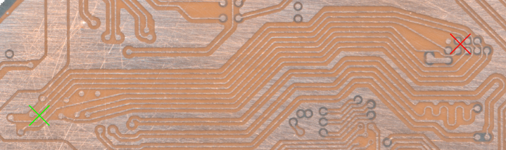

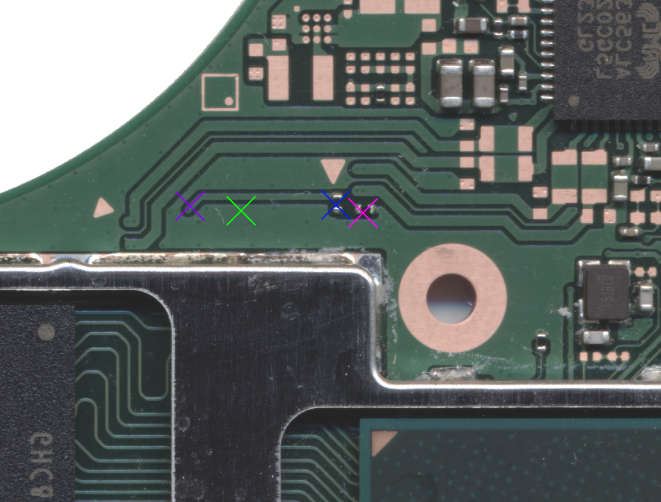

Rats! Aight... any safer place for drilling? xD
there are only two possible places, the one with an arrow on the PCB, and the one close to the CPU cover (requires desoldering part of the cover)
in both cases it is very easy to cut the trace in the process, so reballing is your choice, unfortunately

I hope someone develops a better "ankor" then. What I read it seems to be kind of hit and miss.

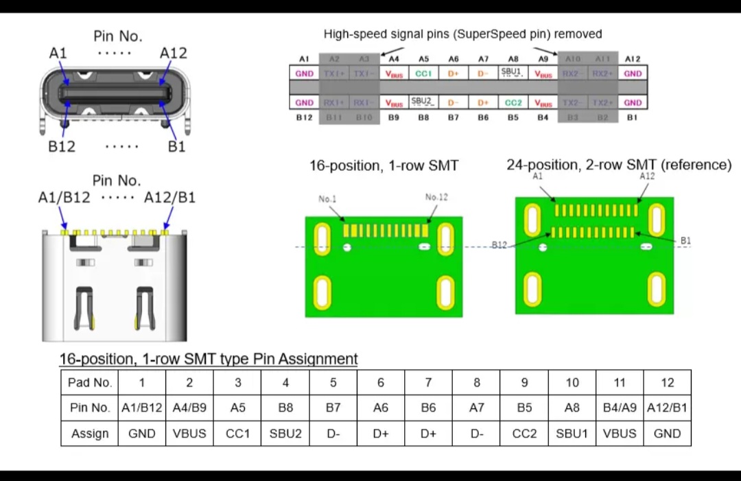

Looks ok to me i tested another pico with a usbc to micro adapter and couldnt get it to detect so thought maybe it uses the cc pin however it turned out just to be my old cables
also on your photo one of the boot button pads is lifted im not sure what out of the four need to be bridged

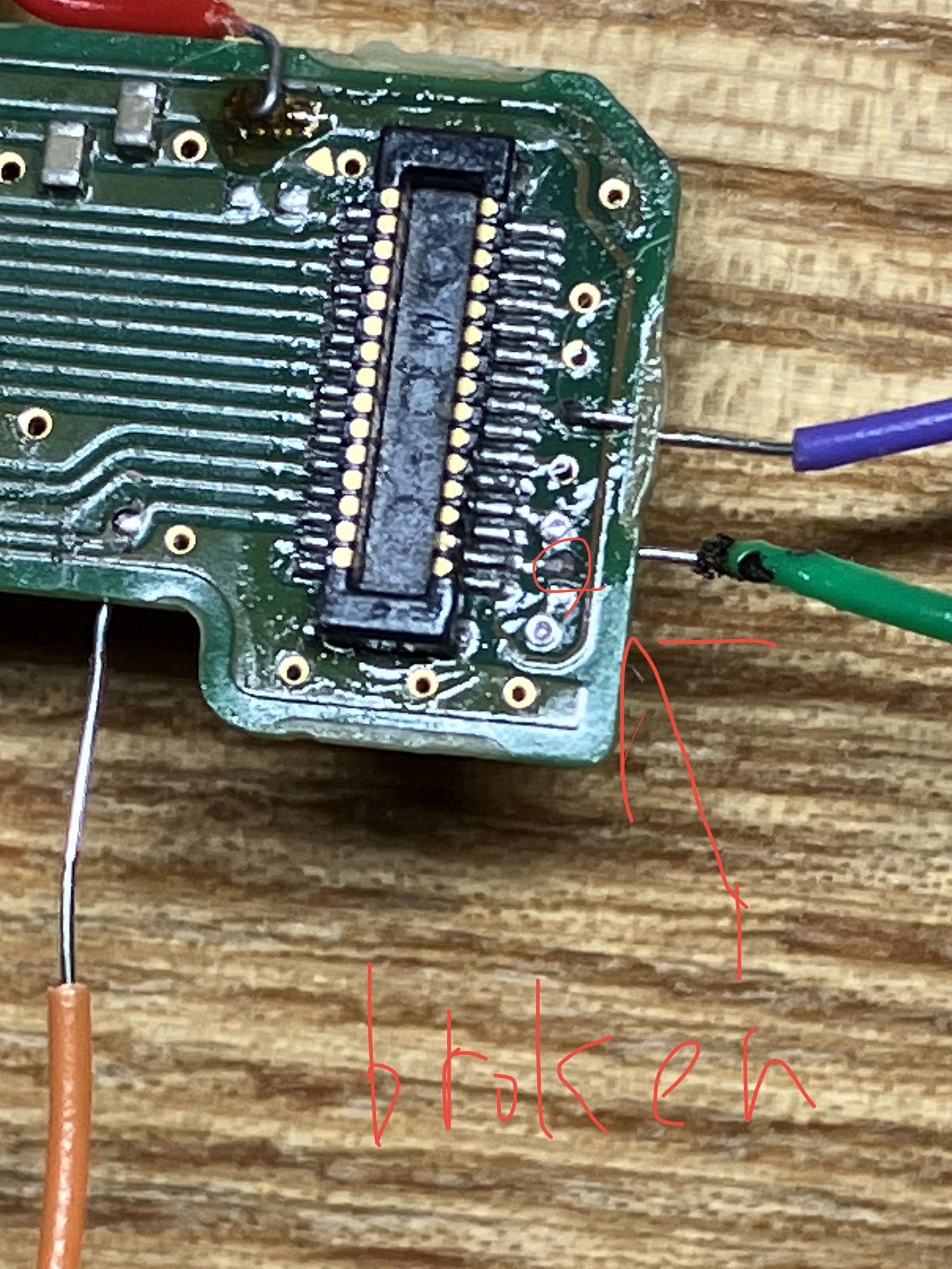

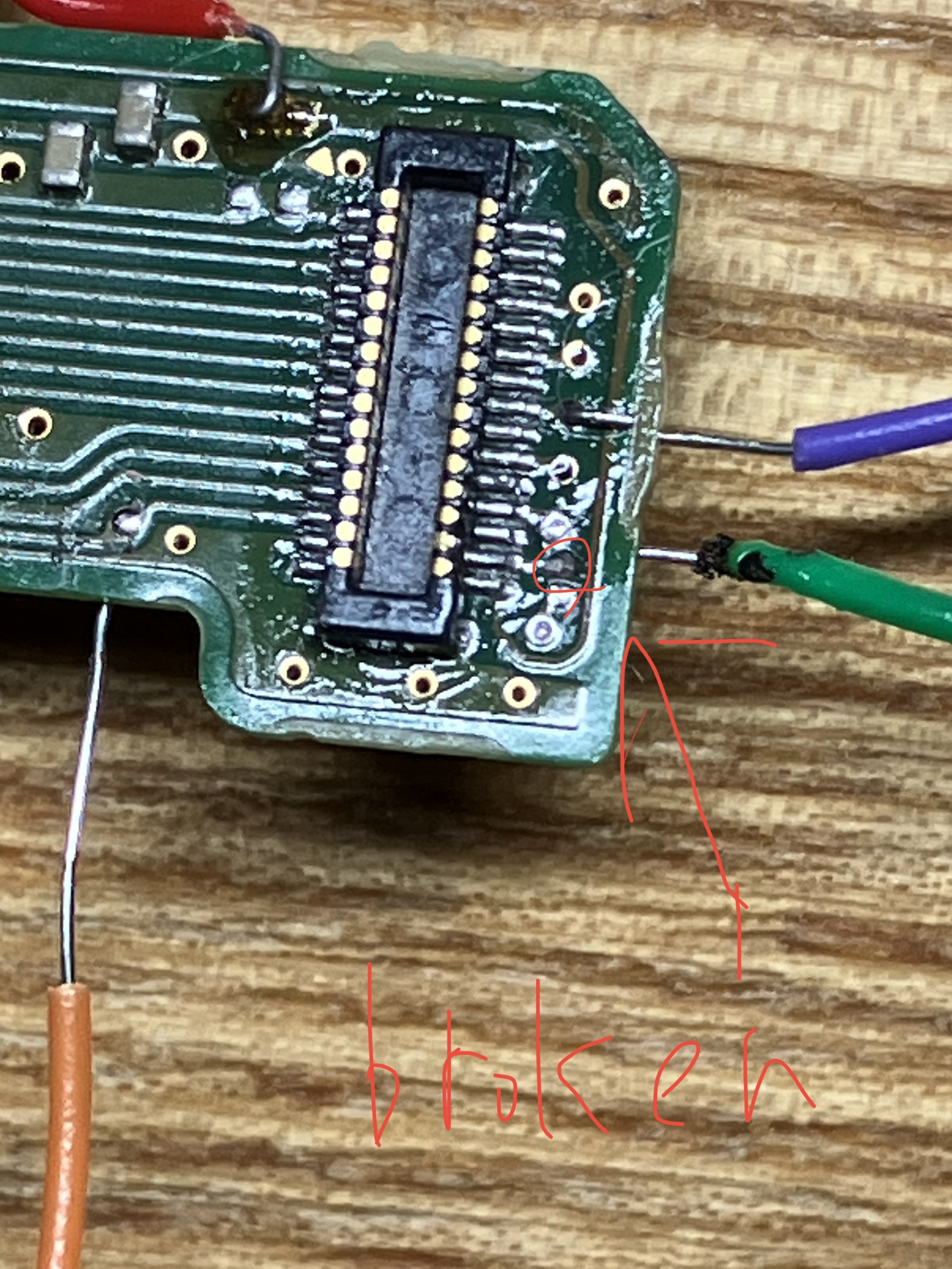

Help me!
mariko v2
I tried to solder to the RST point of the eMMC, but it was too small and in the process, the land was removed. How can I connect to the RST now? Should I jumper to the left connector?

Each of the cc pins of the 16-pin Typec interface is connected to a 5.1KΩ pull-down resistor

This is the great of temp, we have tempers from around the world, and sometimes this happen, by example recently I put a post about a condenser (which is a wright term) but on USA is more often used capacitor and the thread get confused, I am sorry for causing it.
I think land refers to the pad or the via (track) get lifted.
Normally you need to track the via and find another test point.

soldering still feels too difficult for me...

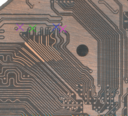

Anyone got a modchip on a OLED installed and a multimeter (and possibily the courage to do some scratching of soldermask?).
RED = DAT0, the image moves so I think it's the 2nd bottom.
GREEN = possible area it leads to.
BLUE, PURPLE, PINK = Areas that needs to be probed. Since they seem to go to the CPU after their transistor.
View attachment 360890View attachment 360891

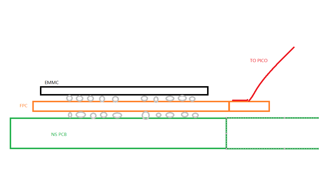

It's still too risky, take the EMMC off and add an FPC between the PCB of EMMC and NS may be better
Yes there are boards on the market of two types one the described on that picture, you desolder the EMMC chip and reball the PCB between the EMMC chip and the console PCB, are other type where you insert a flex adapter by the side and a little tab makes contact to the actual ball of the DAT0. booth are the current options.
also on your photo one of the boot button pads is lifted im not sure what out of the four need to be bridged View attachment 360903
Thank you for the confirmation. Yes, I was aware of the lifted pad but knew I could use 2 of the remaining 3.

Ye, but won't it get to "high" up if so? Plus extra amount of failure points because of all the ball joints.
At least better than drilling a big hole in the PCB :P
If the wire is accidentally broken during drilling, the entire PCB is scrapped, and the failure of the solder ball connection can be removed and reinstalled.
There are no test points added to the PCB, which is very uncomfortable
