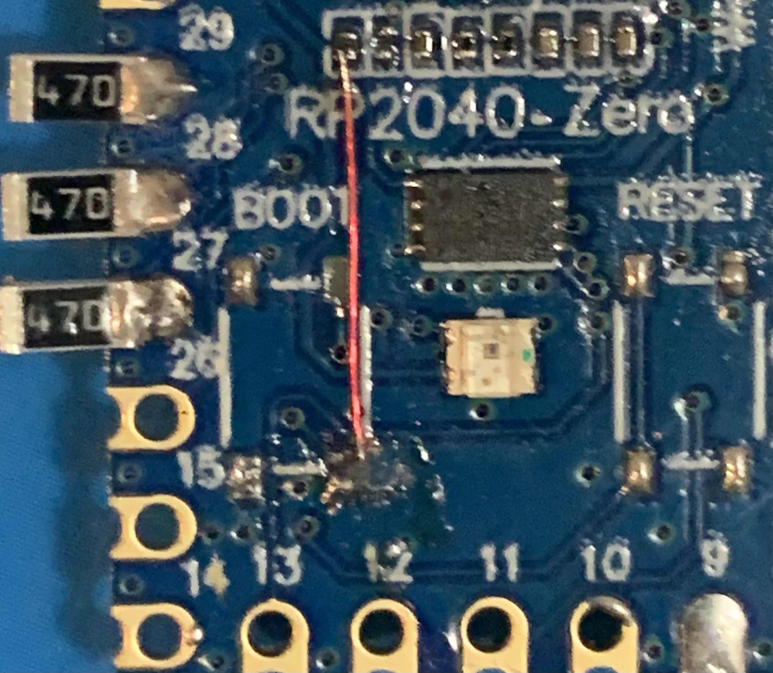

Thank you for the confirmation. Yes, I was aware of the lifted pad but knew I could use 2 of the remaining 3.
Just an update in case someone is following the wiring, 6 and 7 were the same so used 7,8,11 and any ground. Also if you lift that pad on the Boot button the bottom pad loses connectivity to I think a resistor, so it has to be redone. I used magnet wire in order to jump the two bottom pads with a tweezer. Hope that helps someone out.
