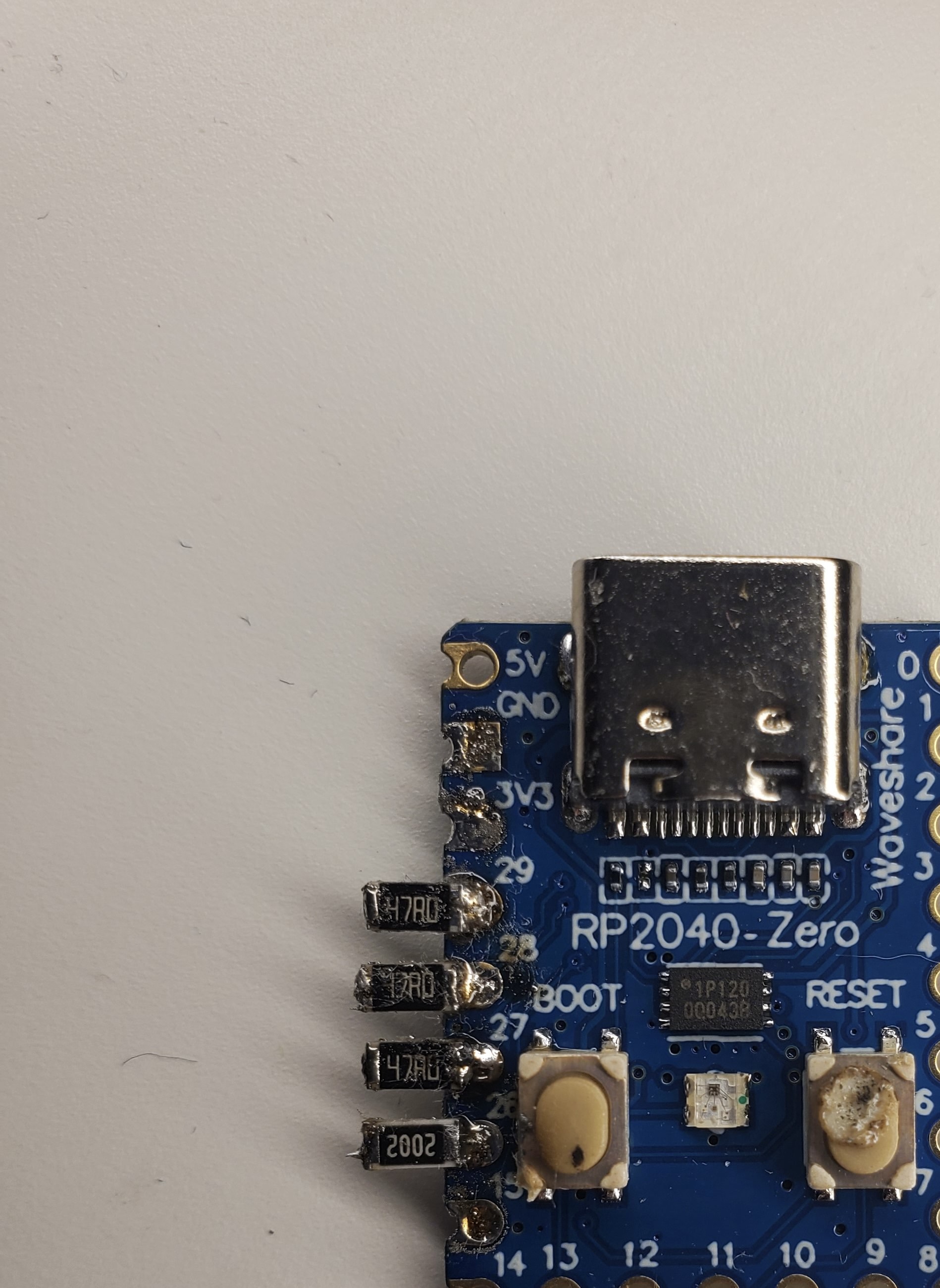

Works great! 😁 The only probem is when i solder the mosfet with wire to the cpu cap it won’t glitch well and boot straight to sysnand HOS so i have to solder the mosfet directly to cpu cap and now everything is good and boot to hekate ..Thanks all for your hard works!
