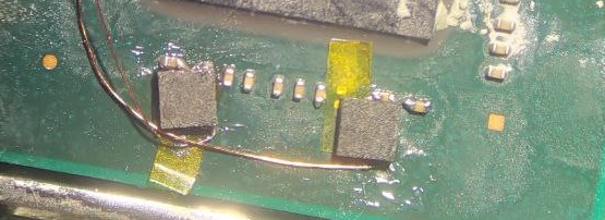

Well... there is ways to restore with a donor nand... BUT... Just use resistors.
Right, thank you.
Didn't want to have 97 resistors lying around since 100 is the lowest quantity I can find :)
Also, does 4.2 ohm works? Just in case :)
Better than nothing, but I read that 47 to 50 is recommended. Sure you can't just order some? Better to wait a couple of days than to destroy your switch.
"47-50 ohm resistors - SMD 08085 or smaller"
Yeah, I'm not in a rush for sure, just gathering info)

If you want to boot original firmware, you need the resistors. They are for signal integrity (at higher speeds the impedance mismatch will F up the emmc signals without resistors).
If you don’t install them, you will only ever be able to use the unit with emu mmc (all running from a flash card).
TLDR: don’t skip them, it’s stupid to do so.
do u mean d a c points need 47ohms resistor?

Installed on V2 and working. :)
Thanks to all the community!!
