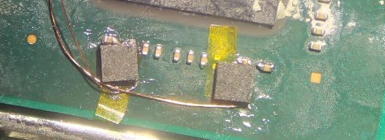

photos, please. + mosfet part number
here u go

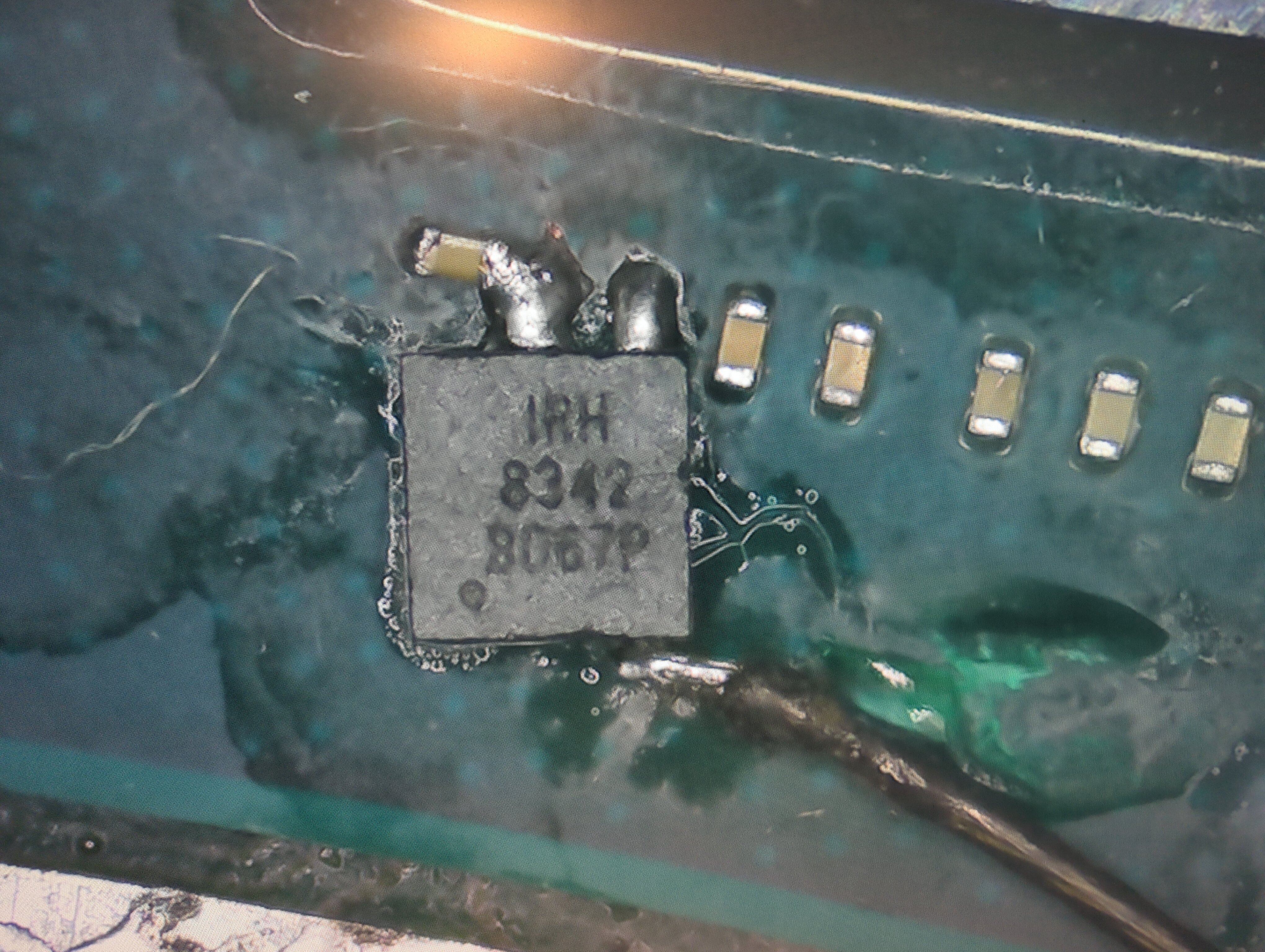

This is the maximum that my camera is capable of, I don’t have a microscope. Front side switch lite.
I agree that it just looks bridged (solder blobs happen). Sorry, I cannot tell you exactly what that component is though (diode?).
I'd throw some flux on it and redo the solder joints, either by running an iron across them (special tip) or using a hot air wand until you see the 'left' capacitor is clearly separated from *that component's 2 (3?) pads. All else fails, remove the left cap and the *component* (edit: with solder braid and iron), clean up all pads and re-place.

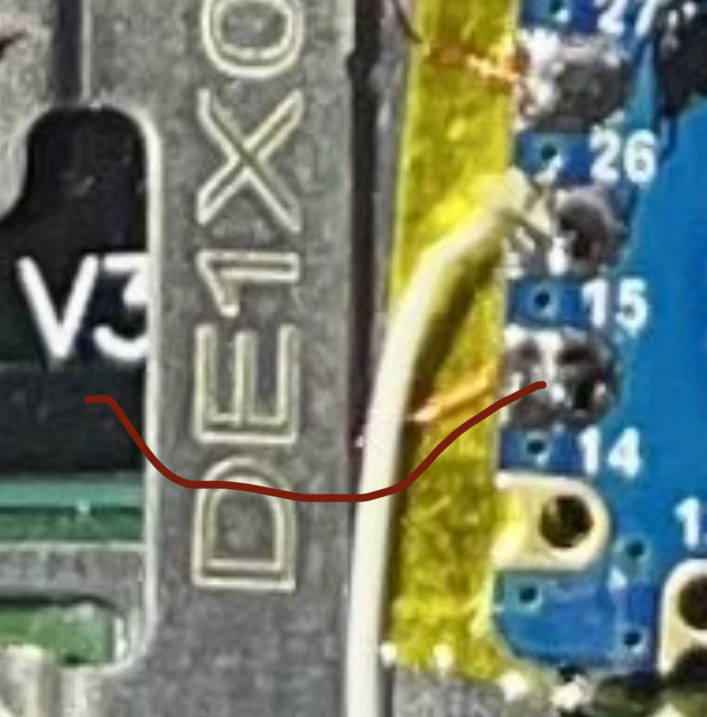

GND / VCC are really solid, yeah
ensure the control wire is properly connected, once I had it staying there on the flux only.
also you can ensure the wire itself is neither broken nor cold-soldered to the other side. can we also have pictures of the rp2040?
Other than that, looks identical to what I have used before. There is a small chance your console is robust and requires two mosfets, however you can try rebooting from HOS several times

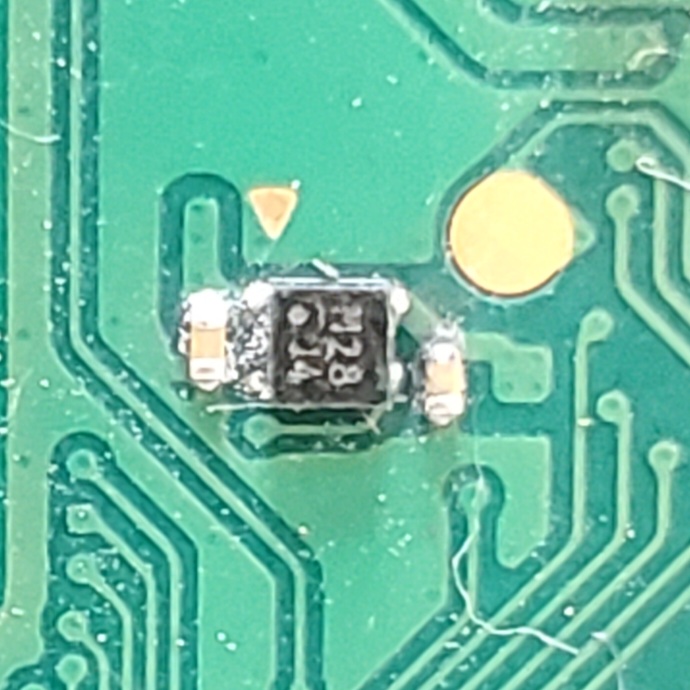

Can someone tell me, please, what is this component m28? It seems I burned it (short circuit) and now my switch does not turn on :cry:
That capacitor next to the chip looks shorted. The chip’s legs too.
You probably need to unplug battery (keep unplugged until fixed), get a solder wick, and clean that solder up.

Cut a small piece of wick, dunk it in flux, hold it in tweezers (if you thermally isolate the piece of wick from the tweezers or you have ceramic tweezers it will be easier), and slowly try sucking that solder away by heating the spot with an iron through the wick. Should suck the excess solder away.
Do NOT yank, push, pull, twist, etc. let it heat up through the wick under contact but minimal pressure. Or you yank the cap off. Or worse.
