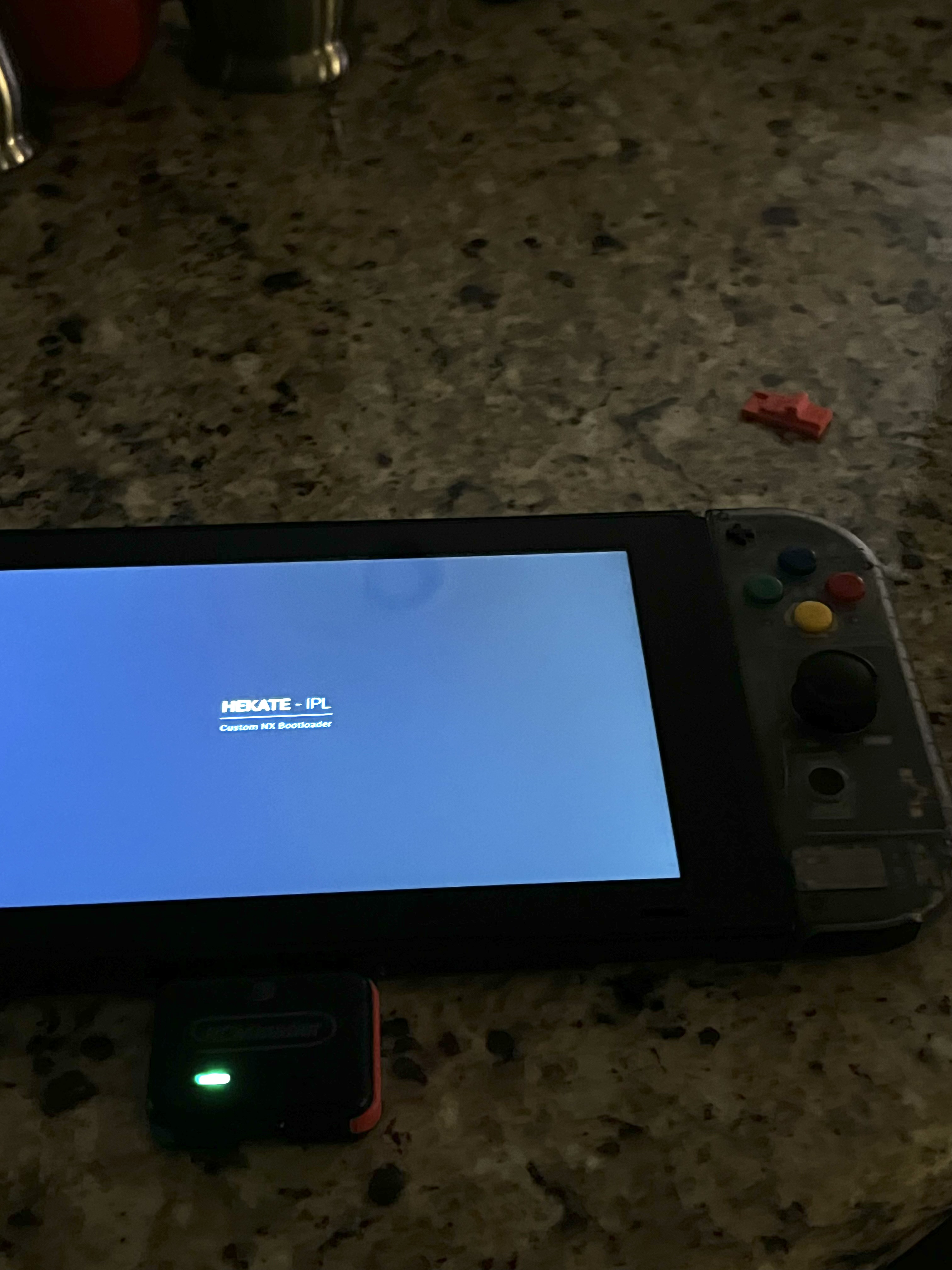

I'm new to Switch modding and *somewhat* understand what resistors do but I don't understand what the resistor is doing here. How does it make it a jig sometimes but act normal other times? What puts this into jig mode? If someone can explain how this resistor is accomplishing this I will do this over the mod that runs wires from the 1 & 10 pads up to the joycon release button (this closes the circuit). It's mechanical, not fancy and is undetectable but certainly does the job. Sorry for the noobish question.

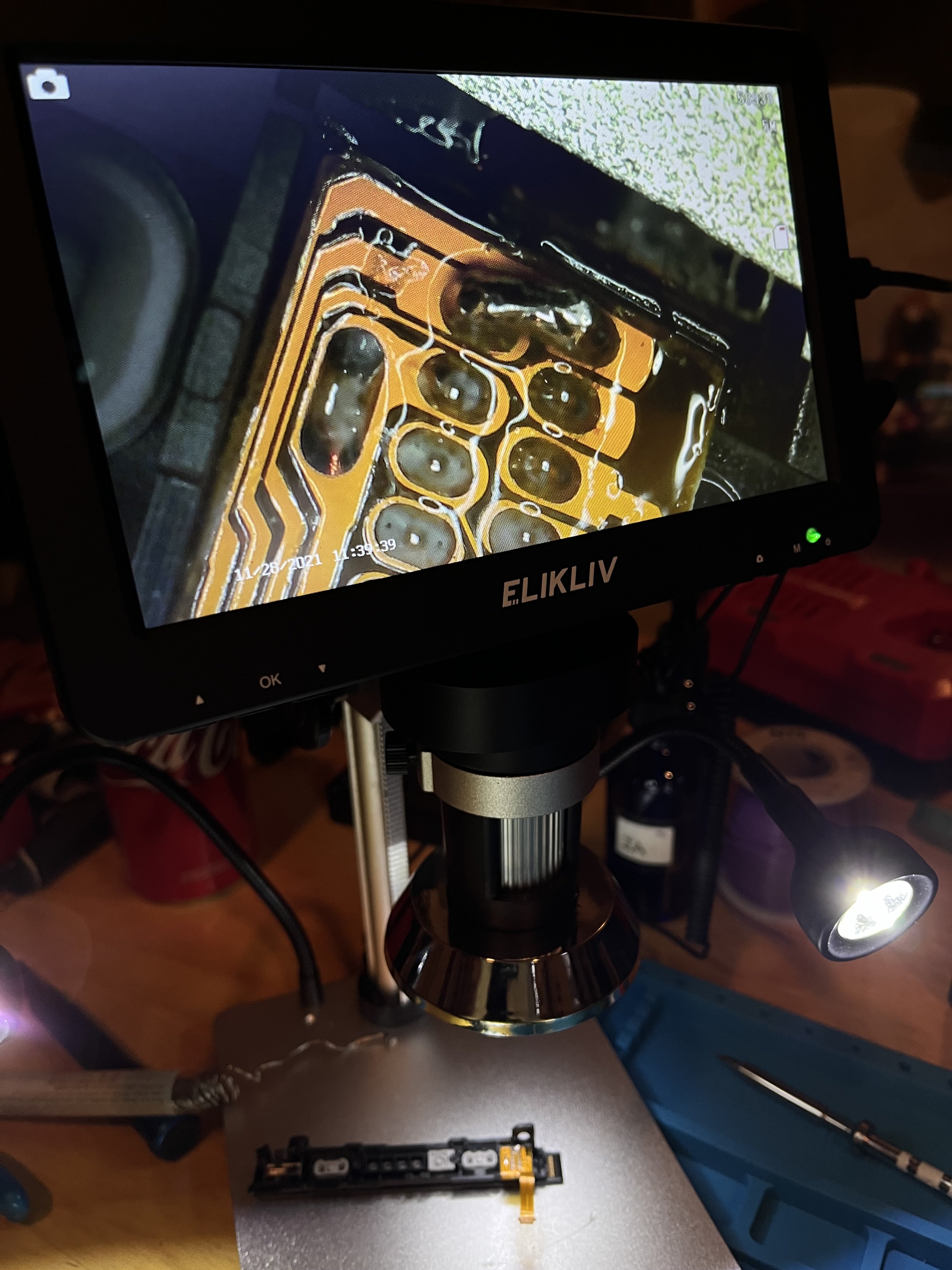

After a whle I decided to desolder the points just because off the weird bugs with not being able to go into wireless mode and overall glitches. I was able to remove the solder from both pins and happily it still works as normal! Not so permanent. :)

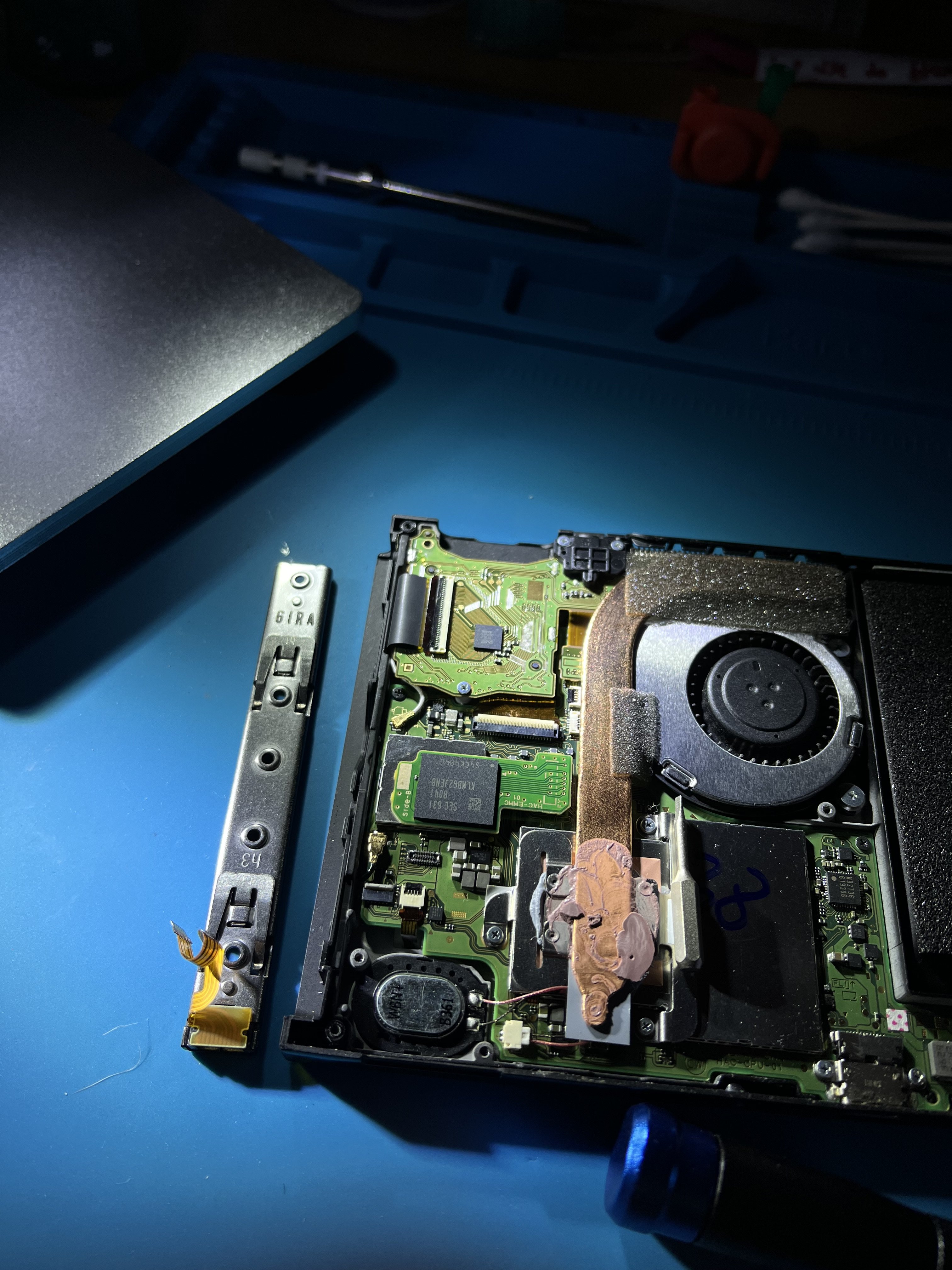

I did this mod to an old JoyCon rail that had a damaged ribbon cable, but still works to do the mod with.
Lost my jig so it was the quickest way to get back into RCM.
Don't recommend permanently modding your actual JoyCons anymore but if you have a spare rail, this is a good mod to do. And the spare rails are only a few bucks. Recommend removing the plastic lock to make disconnecting the rail from the Switch easier.
I did pin 1+10. Pin 9+10 is easier to do, but Pin 9 is not actually a GND, so it's not a recommended pin to use. 1 and 7 are both GND. You need a wire if doing pin 1 or 7.
