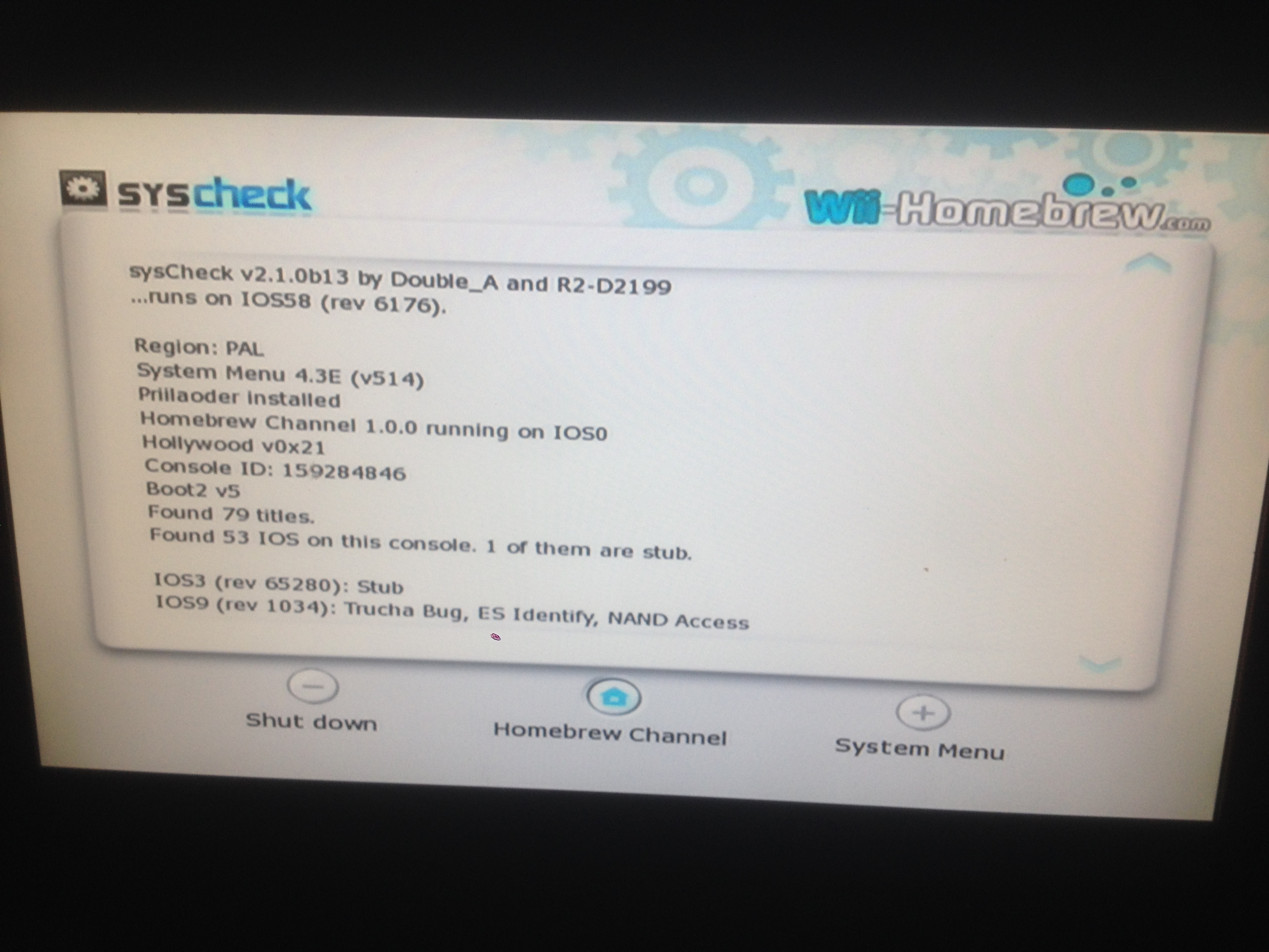

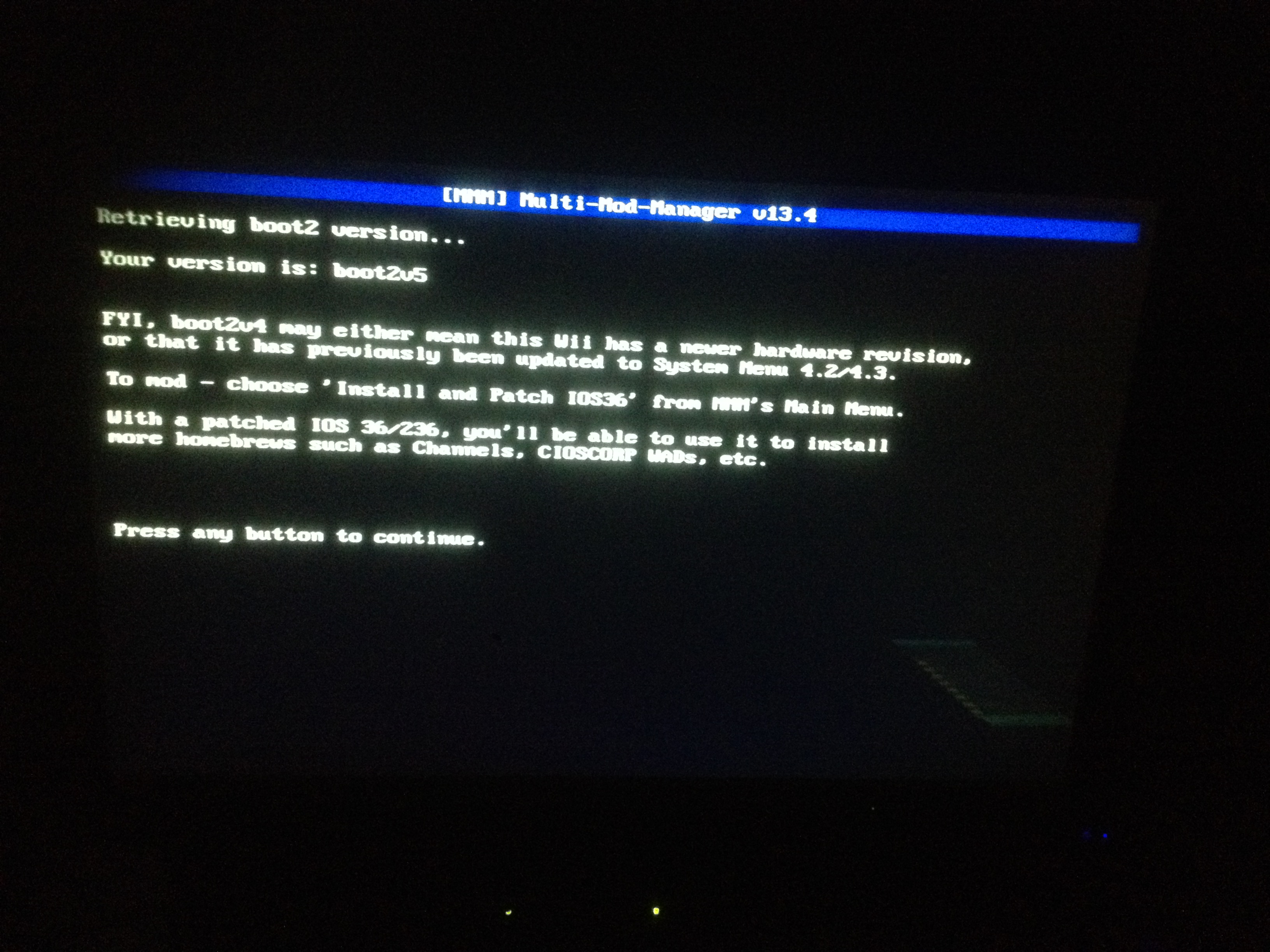

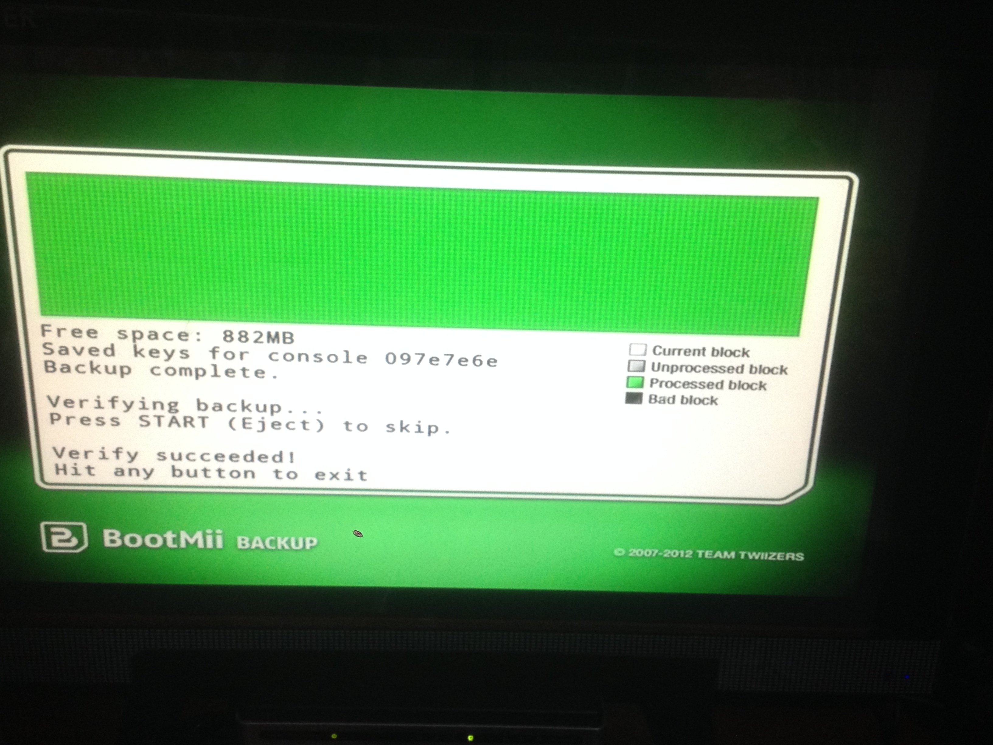

Hello everyone i have ran into a problem with a certain wii black rvl 101
it does't work with my hp16gb usb on either wii usb loaders or nintendont
but that same usb works on my other wii white rvl 101 wii both wii usb loaders and nintendont but my other personal 8gb kingstan usb works perfectly on my white rvl 101 as well as this black rvl 101. i have install all cios as well.
But the strangest wii of all I have seen is this Wii rvl 101 black.Strange thing is:
1: This wii has Zero bad blocks in bootmii nand dump.
2: In hackmii installer 1.2 it shows this Boot2 injected with bootmii loader fail to pass consistency checks.
3: USB loaders sometimes work with. This hp 16gb usb and nintendont shows game but is always stuck on init game.
4: Strangest thing of All of it is that in syscheck report Boot2 is shown as Boot2 v5.
5: I have tried to install boot2 v4 with
WAD Manager v1.5 and it gave me
error stating(aborted for safety of wii)
6: This Wii black rvl-101 boots
Wii games from internal 8gb sdcard
just fine no lag or hang.
This version v5 of boot2 is not available
anywhere on internet and even in nus
downloader latest available version is
Boot2 v4. I have checked.I think I might be first one or one of these rare ones who encountered it.
Can i extract this boot2 v5 from this console nand dump. Is it possible ?.
Is this whats preventing me from using my usb on this Wii black rvl-101.
I can't answer to all that's going on above other then recommend your 16GB flash drive is probably the problem. Even though it works on one they are finicky even between units.
I recommend getting an external hard drive with separate power supply or use a Y-cable to make sure it's properly powered and try it between both units to see if the issue persists. My recommendation for you would be to get a 2TB Western Digital Passport with Y-Cable and make sure it's formatted properly FAY32 with 32k cluster size.
As for the other stuff coming up weird I'm sure someone with knowledge will chime in shortly.
Reactions: Alexander1970
Its not mine but of a customer both Wii black rvl-101 console and the hp16gb usb.He just asked for the usb with games so i brought this hp 16gb usb transfers games to usb with wbfs and used on my own console and worked without problem. ITs still works on my console but not his console.
Not even nintendont it always gets stuck at Init DI...
i have encountered a bit similar situation before with 16 gb flash drive which was an sd card soldered to usb.it din't ran any wii games always got stuck at loading screen safety screen loader not responding.But worked flawless with nintendont.and my kinsgston 8gb works with wii usbloaders but with nintendont games are only detected if plugged right in when checking for storage drive is shown on screen in nintendont something i figured after a lot of struggle with to get BATMAN BEGINS to play on my white wii.
Any way i am thinking of giving him a different wii and keep this one to find out more about this Boot2 v5
