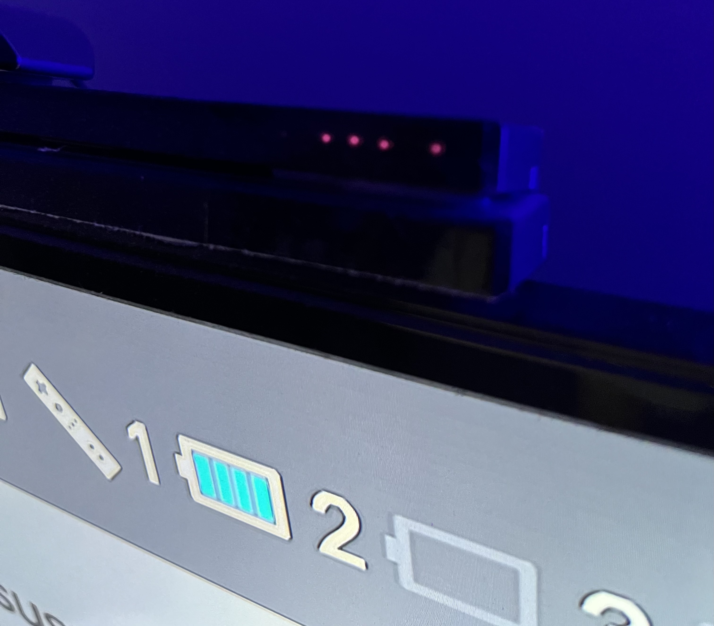

The Wii U GamePad has a Sensor Bar that turns on whenever the Wii Sensor Bar would turn on, if you had one. It is the top black bar with the camera in the middle.
If this makes no sense to you, Sensor Bar is just an array of infrared LEDs that the camera in a Wii Remote tracks to be able to point on a screen. It is designed to only be turned on when necessary to avoid burning out the LEDs. There are no sensors in it, that's merely a misnomer.
Just to be clear, you STILL need a Wii Remote of some kind, because the process of modding vWii requires it.
Wait, now I'm curious, does the Wii sensor bar only turn on when you're doing something that can use the pointer? Like, if you play a game that entirely uses button controls then it turns off? Kinda like how the Wii Speak only turns on when you're doing something that uses it? It's obvious on the Wii Speak because of the easily noticeable blue light when it's on but not as obvious with the sensor bar because it has a few pink lights that are hardly visible without a camera.
I think so. What I'm certain about is that while the console is in standby, it doesn't power the sensor bar. Aside from the fact it's unnecessary to have it powered on at all times, it prolongs the longevity of the IR lights inside of it.
It especially makes sense on the Wii U as the GamePad is the primary controller type, and it has its own array of IR lights that can can be powered on anyway.

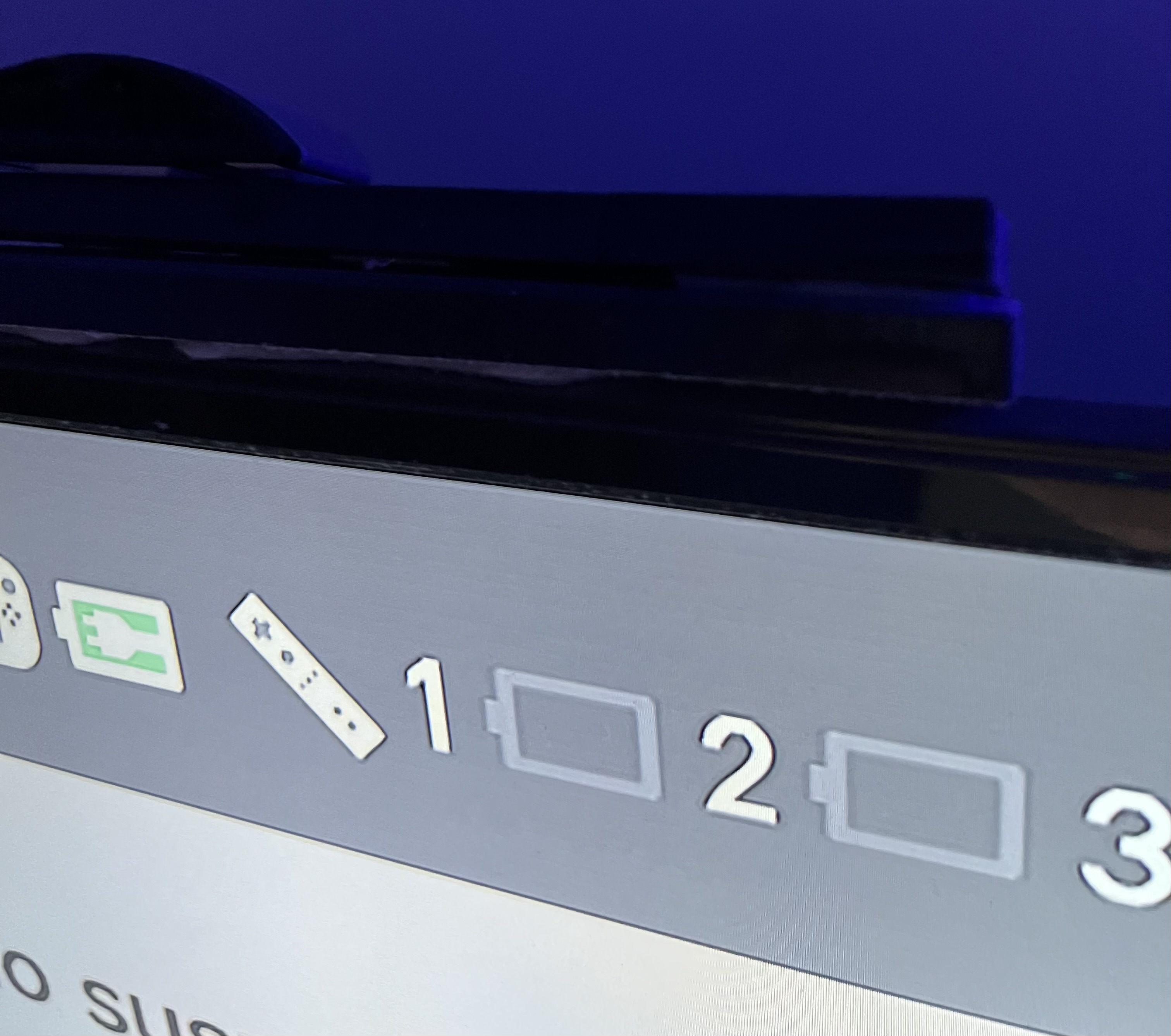

I just checked and it does in fact turn off if there's no Wiimotes connected (At least on Wii U)
(For those wondering what's on top of the sensor bar it's a Wii Speak)
