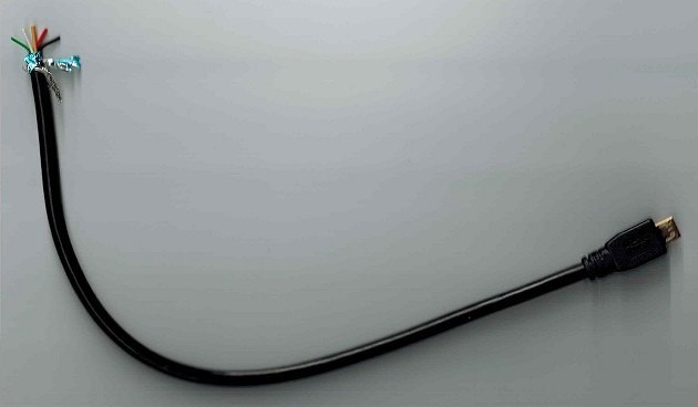

The other option is to be like me and buy a micro USB extension cable, the cut it in half and strip the now-exposed wires. :)
