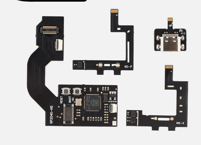

This is the RP2040 I ordered, it comes with a few extra things it looks like, including one that connects it to PC so that I can flash the picofly software onto it. Like I said my friend will be doing the actual soldering/modding part as I'm not knowledgeable about that, will this chip be okay? it says specifically for nintendo switch model, not the lite or the oled (they had different options for those) so I think it will be good
That looks like one of the Picofly clone boards I mentioned. RP2040 is the name of the chip on it, it's the same for all Picofly boards.
Unlike the generic boards recommended in the guide, those clones are designed just for Switch modding, and they can be faster to install, because there's almost nothing to wire by hand. It's probably fine, but their quality can vary wildly, you never know (e.g. resistor values). So if anything goes wrong, it can be harder to troubleshoot.
