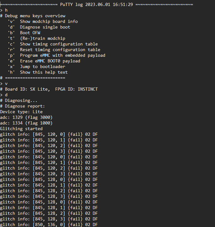

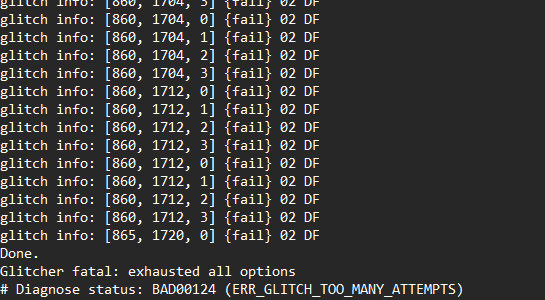

Incase any one’s wondering, I redid my cpu cable and switched back to the flex and it worked for some reason (all points still measured the same). But I did break the display connector 🥲
I had exactly the same problem as seen in your video. I redid all the solder points with wire instead of the flex. No fix. What do you think fixed yours?
I honestly don't know I just kept desoldering and resoldering all the points. Maybe try a different thicker wire for dat0. Because according to sthetix's video when it blinks purple red the issue is point c.
Thank you. I saw that video too that's why I changed the dat0 adapter.
I use the dame type of wire that he uses, I will try a thicker one.
My hwfly v5 switch (hynix mmc) having issue with booting ofw/sysnand, it just shows black screen but emunand is working fine. Anyone knows if it's caused by Hynix emmc or FPCB? I just don't want to loose my game saves😥
I've changed the cable to dat0 adapter to a thicker one. Got the same readings and same red led blinking.
I've attached some log pics.

@LPRM if you press vol up & vol down it boots to OFW also? Did you try to retrain it (r-option)? Your diode values in your other post are fine. Maybe CPU soldering, RST connection or FPCB are bad?
