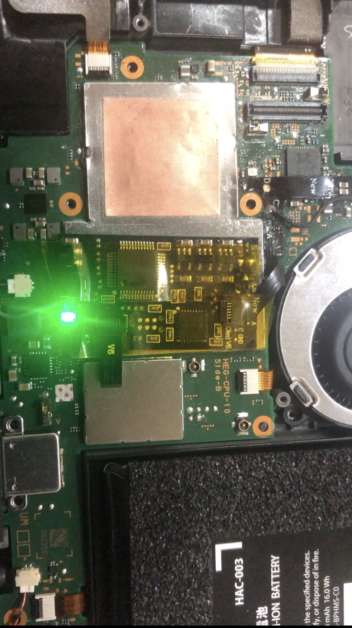

Guys plz help, I tried everything, using the flex cable, fly wires, thicker wire for dat0, and even using flex and connecting dat0 cable directly to the chip itself instead of the flex. I also reflashed the chip firmware and It still blinks yellow, purple, red, then boots to ofw.
the points diode values are:
3.3v = 0.85
D = 0.88
A = 0.84
C = 0.85
B = 0L
Incase any one’s wondering, I redid my cpu cable and switched back to the flex and it worked for some reason (all points still measured the same). But I did break the display connector 🥲
