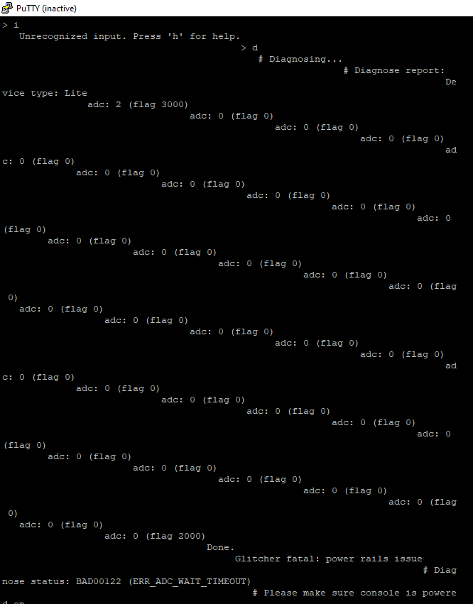

Thanks @doom95, i followed the putty intuctions you posted in another tread:
with usb + putty, option 'i' should print INSTINCT, if not its a bad chip. might be simple to fix, else just request replacement

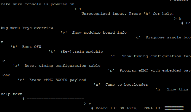

I used putty, but when i press "i" it sas "Unrecognized input, Press h for help"
Then i pressed "d" for diagnosis
This is the printout:
It asks to switch on the console
Then i press"d" again an this is what i get.
When i press "v" for modship board info, it says the "Board ID: SX Lite"

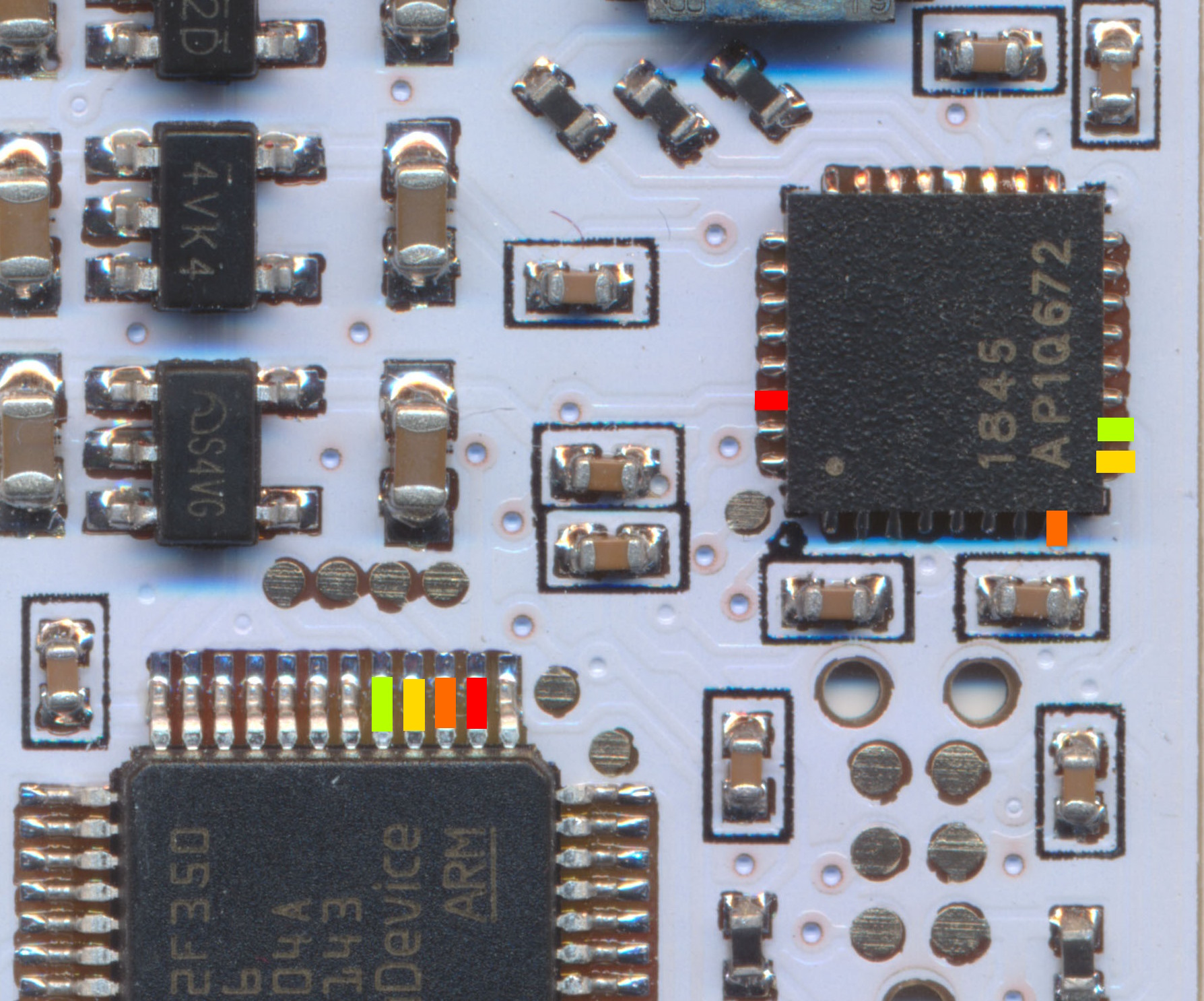

no.... your clk point (D) is no good
Ive just took the flex cable away and wired straight to the motherboard and soldered that to the chip and got a reading of 740
so its connected to what its supposed to be , same error though
The connection nerest the cpu the really relly small one and hooked it up to point D
