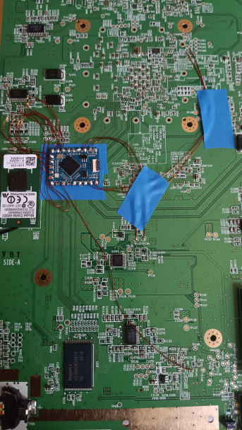

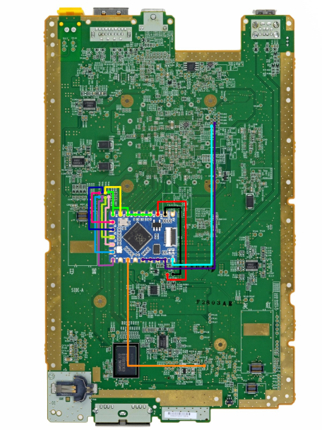

is there any other way to redeemable the data device,like UDPIH?
Not right now, no.

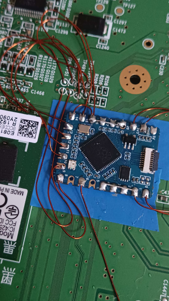

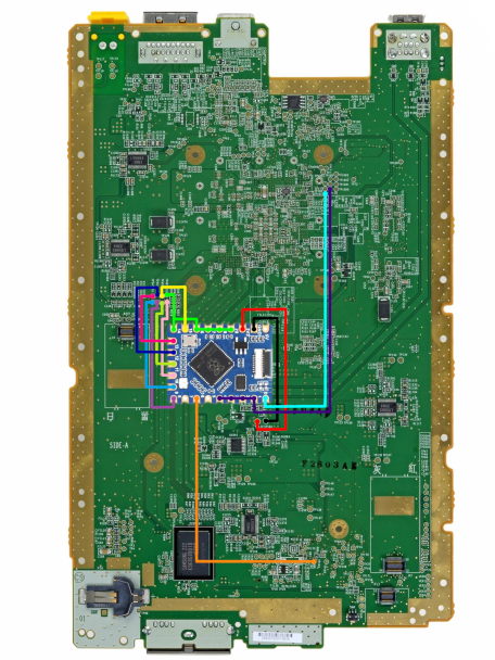

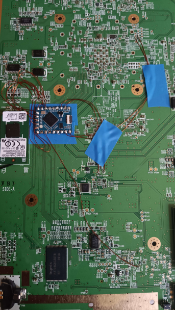

This is btw the reason I suggest to leave the RPI Pico inside of the console. Currently there are some bugs (working on it as soon as a package from china arrives as I got some hardware damage I need to fix before) preventing you from doing that, so you would have to disconnect the 3.3 V line.
BTW: There's also this: https://www.waveshare.com/rp2040-tiny.htm
It needs code changes in de_fuse but then it works just great and uses less space than the pico + you can route the cable to the extension board through the housing of the Wii U.
You just need to add a diode to the 3.3 V line as else a part of the board gets really hot when you connect it to USB but the Wii U isn't connected to wall power. Also the diode will drop the 3.3 V (I used a cheap diode I had lying around, it dropped the voltage to 2.3 V) but that's no big deal: The chip on the board itself works with anything between (and including) 1.8 and 3.3 V and the data lines of the Wii U also seem to be pretty high tolerance. Only "issue" is that the power LED on the extension board is barely visible but for me that's not important anyway.

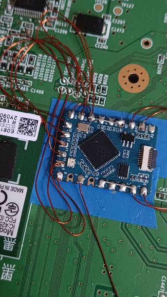

Would one of these work since it has all of the connections and seems to be about the same size as the one you posted?
https://www.waveshare.com/wiki/RP2040-Zero
Just curious as I have a couple of these that I bought and was thinking about using one of them if I do another console. They do work for udpih loading of the recovery menu.
fringle
Apr 16, 2009
704
1,108
I don't have the time to check right now but from a quick look it might work for de_fuse (with codechanges who aren't public yet). For UDPIH you don't need the pins, so that works anyway.
Here btw some pictures of the Tiny board in action:
Nice. The one I posted has all of the connections. Some of them are just solder pads on the underside rather than castellated hole connections. I may give it a try just to see if it works this weekend since I have another disassembled Wii U here and can easily be removed if it's a no go.

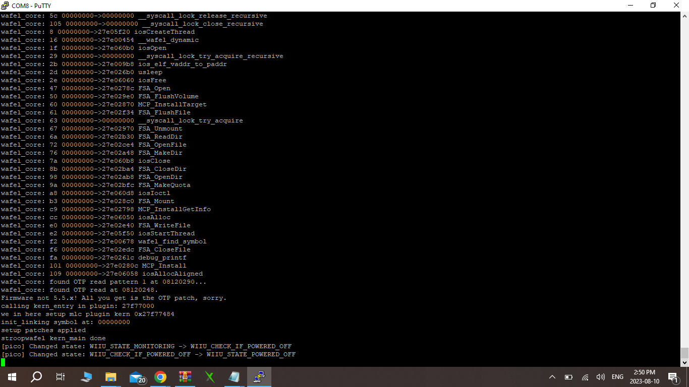

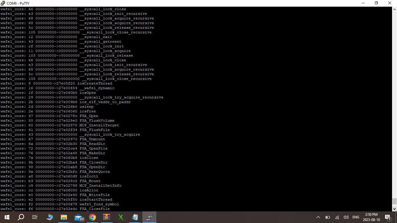

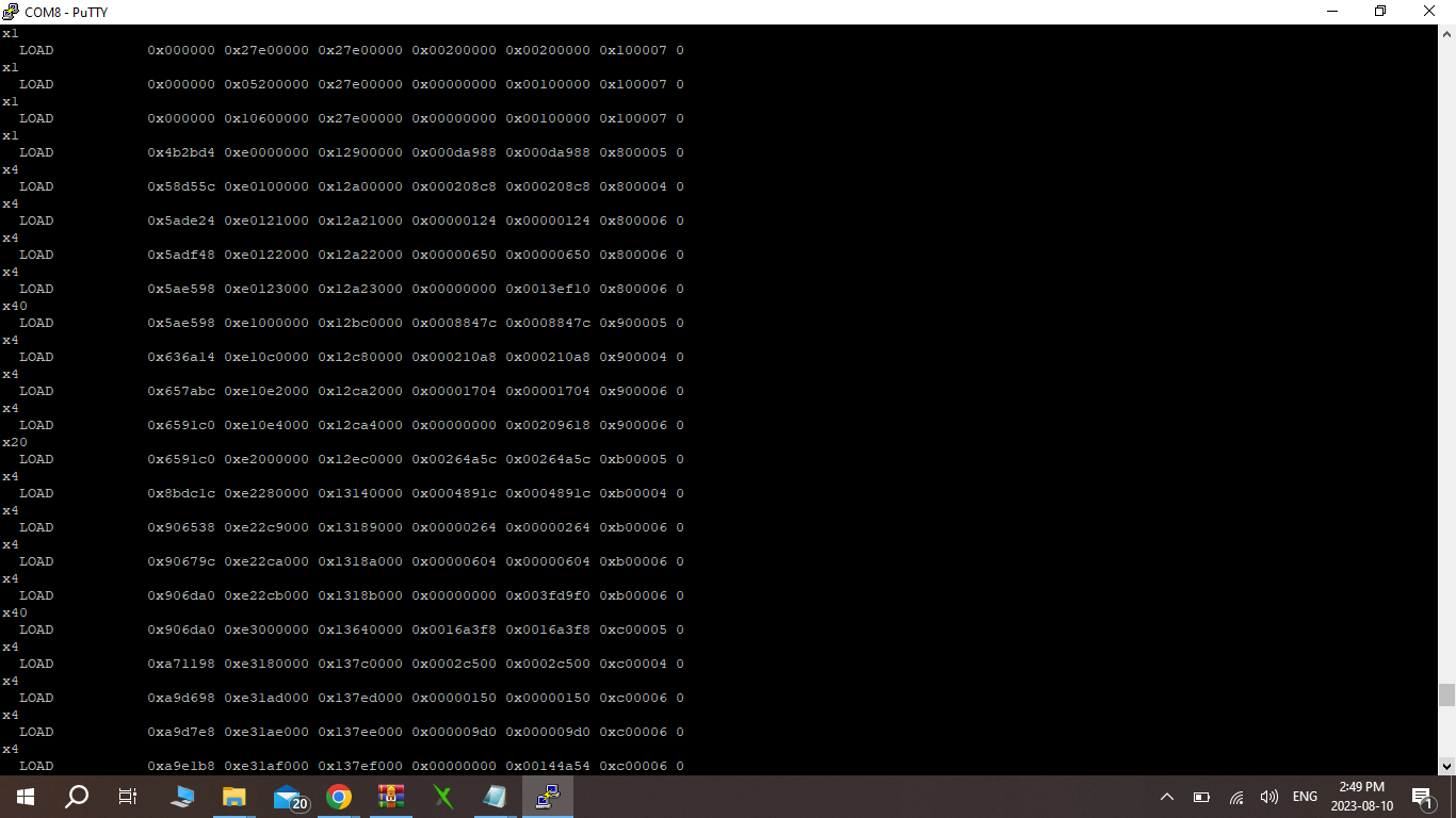

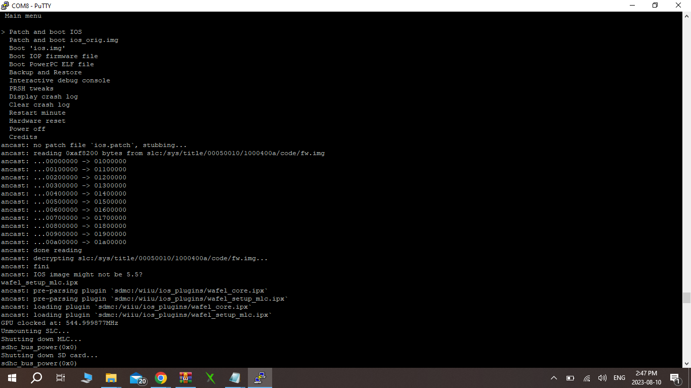

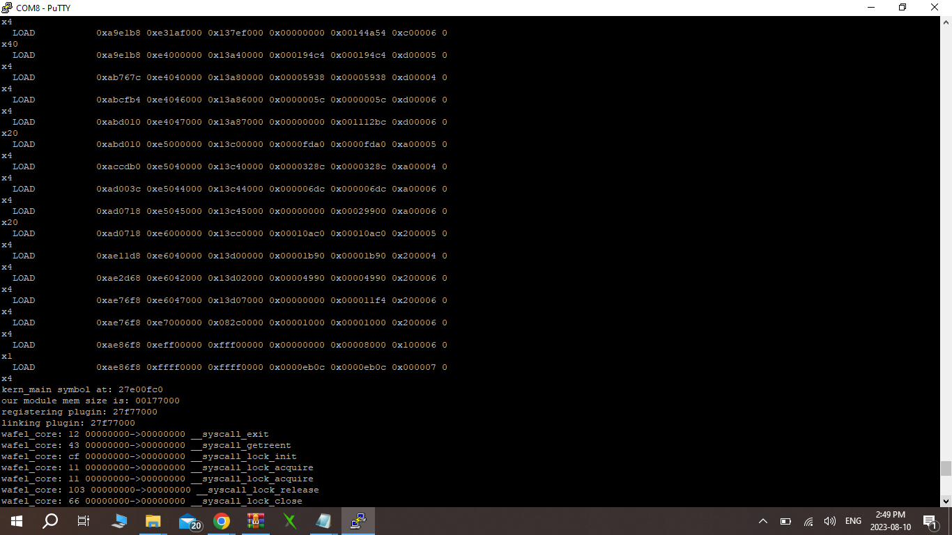

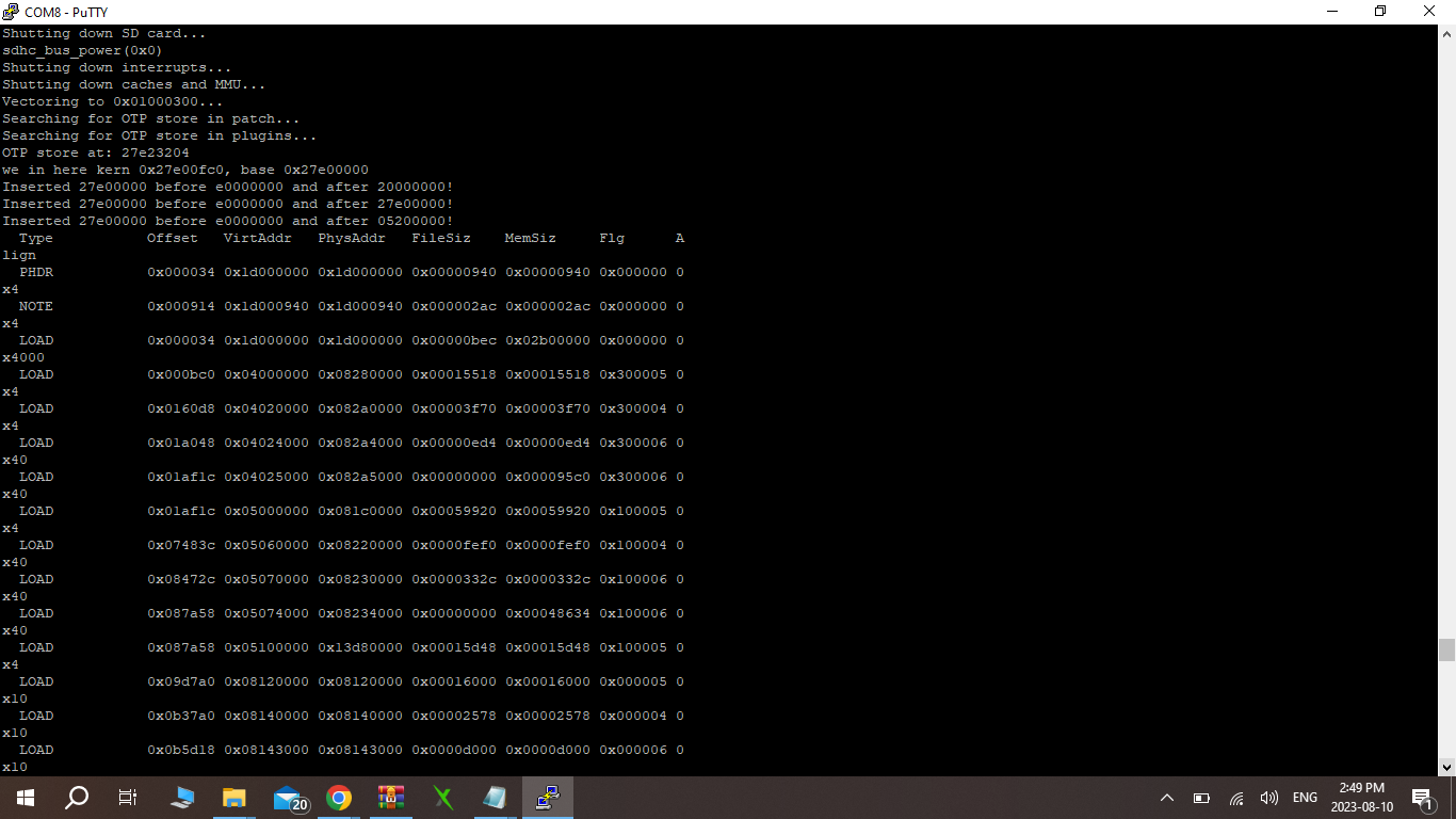

Hey!
So i have a wii u that someone removed the emmc from. I defused it and got it to boot on the tv, and able to see it through puTTy. I soldered in a nand aid, followed this tutorial, and i keep getting (at the end):
wafel_core: found OTP read pattern 1 at 08120290...
wafel_core: found OTP read at 08120248.
Firmware not 5.5.x! All you get is the OTP patch, sorry.
calling kern_entry in plugin: 27f77000
we in here setup mlc plugin kern 0x27f77484
init_linking symbol at: 00000000
setup patches applied
stroopwafel kern_main done
when i run the first option, and it just sits there with purple light on. says firmware not 5.5.x, how would i go about fixing this? Sorry for all the pics, i just want to make sure im including all the info i have haha
using a 64gb samsung pro edurance and nandaid

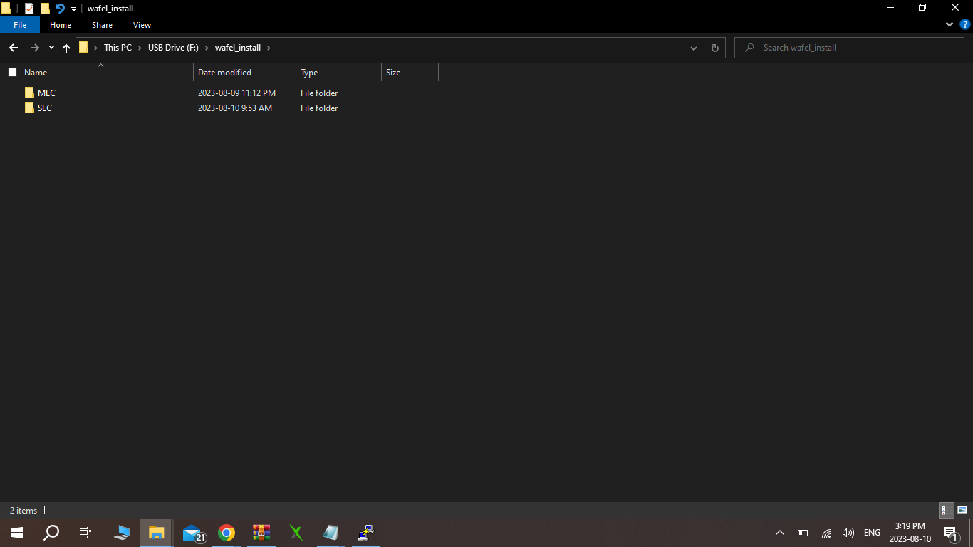

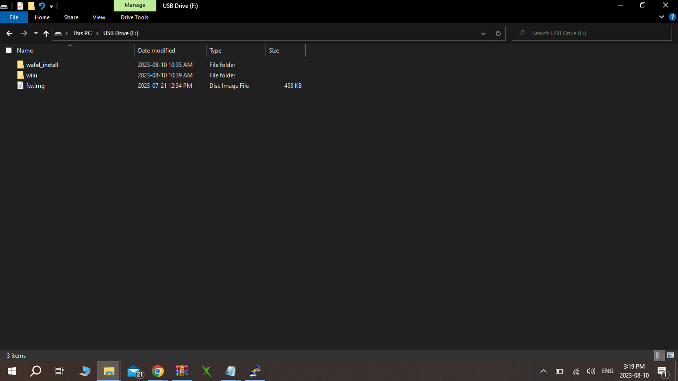

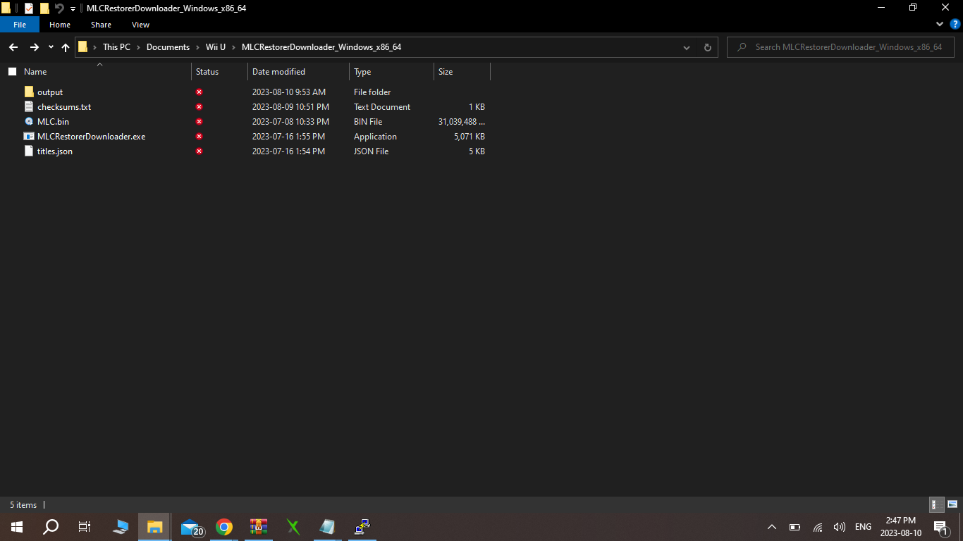

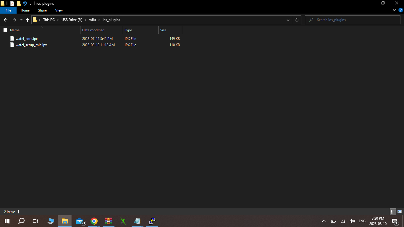

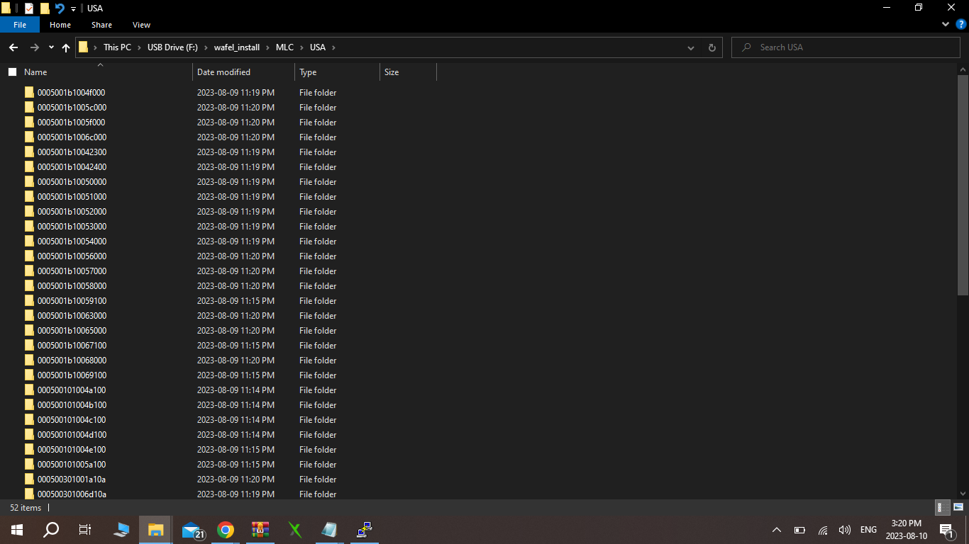

Use JNUSTool to download OSv10 (Title 000500101000400A) get the fw.img from that and put it on the SD as ios_orig.img.
Then use the MLCRestorerDownloader and download the SLC titles in addition to the mlc titles and put both the mlc and the slc ctitles in the wafel_install folder.
Then use the second option in minute "Patch and boot ios_orig.img"
This way we are loading the current 5.5.5 IOSU from SD, so all the patches work and also upgrade the titles on the SLC during the setup of the MLC. So after that your Wii U is on the latest firmware.
EDIT: how big is the SD you put in the NAND-AID? I would recommend at least 64GB to make sure it gets formatted and you don't run into problems with scfm.
Thanks for the reply SDIO
Im using a 64gb samsung pro endurance card that in trying to use in the nand-aid. I also have already aquired the slc and mlc files, so im good there!
but excuse my ignorance, how do i run jnustool? downloaded it but its a .jar file and i am not familiar.
Thank you, very excited to get this $20 Wii u going!

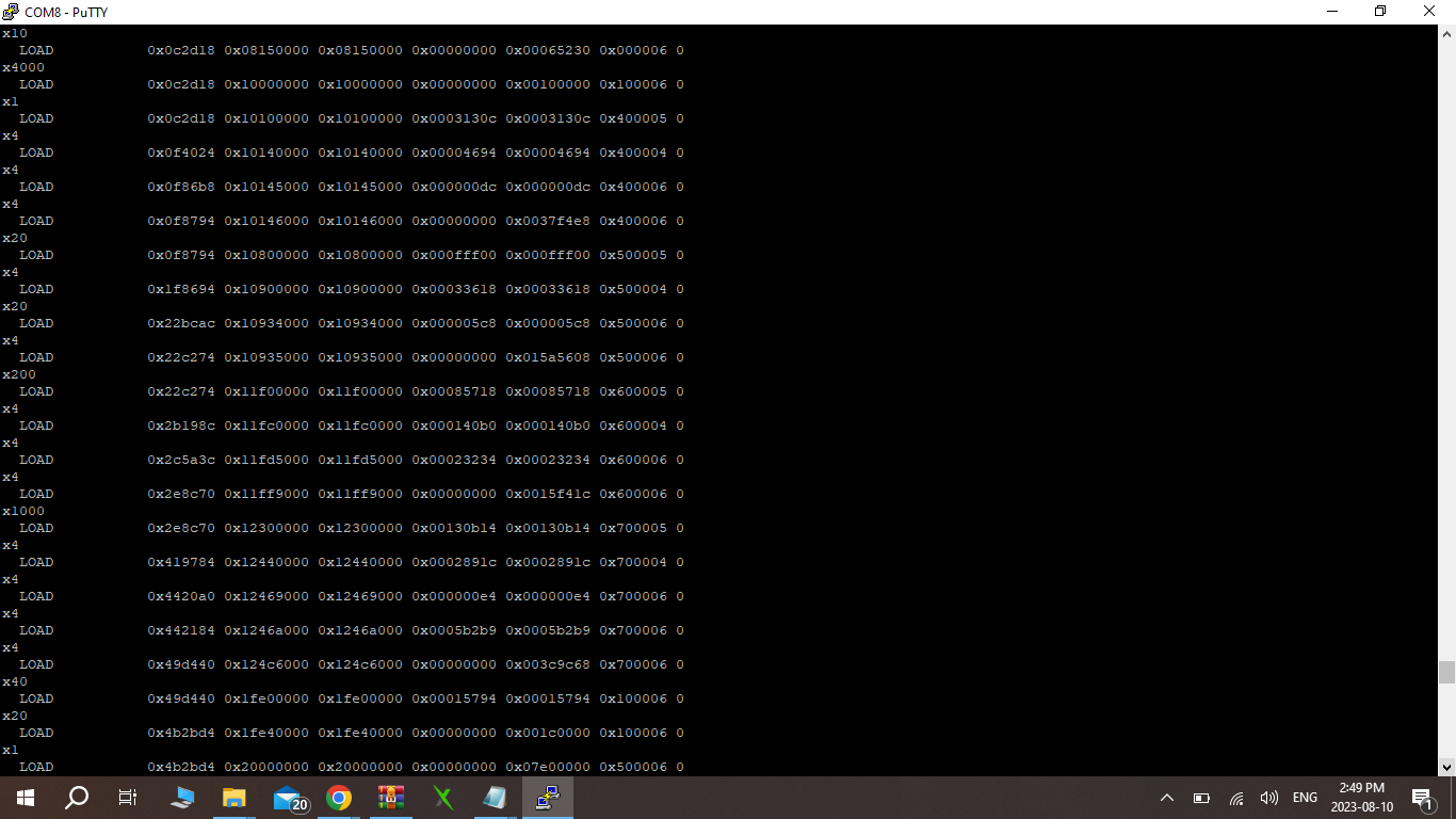

then wait till the led stops blinking and then show the install log, which got created on the sdcard
Tuner357
Aug 10, 2023
95
31
188
okay. it keeps scrolling this, its fine to turn off right now? solid orange light. just want to double check
Tuner357
Aug 10, 2023
95
31
188
yes, turn it of and upload the log, so we can see what went wrong
awesome, here you go
MakeQuota;/vol/storage_mlc01/sys;-00000000
MakeDir;/vol/storage_mlc01/usr;-00000000
MakeDir;/vol/storage_mlc01/usr/boss;-00000000
MakeDir;/vol/storage_mlc01/usr/save;-00000000
MakeDir;/vol/storage_mlc01/usr/save/00050010;-00000000
MakeDir;/vol/storage_mlc01/usr/packages;-00000000
MakeDir;/vol/storage_mlc01/usr/tmp;-00000000
Flush;MLC;-00000000
OpenDir;/vol/sdcard/wafel_install;-00000000
OpenMCP;/vol/sdcard/wafel_install;-00000000
InstallInfo;SLC;-FFFBF3E2
InstallInfo;MLC;-FFFBF3E2
Flush;MLC;-00000000
SetInitialLaunch;0;-00000001
Flush;SLC;-00000000
I guess you have MLC and SLC folders inside of wafel_install and then the titles inside of them? That's wrong, put the titles directly into wafel_install.

Maybe you mad subdirectories there?
in the wafel_install folder you will have one subfoler for every title and this folder contains all the files. No other folders in between

@SDIO @V10lator def had them in mlc and slc folders. now i have this error log
MakeQuota;/vol/storage_mlc01/sys;-FFFCFFEA
MakeDir;/vol/storage_mlc01/usr;-FFFCFFEA
MakeDir;/vol/storage_mlc01/usr/boss;-FFFCFFEA
MakeDir;/vol/storage_mlc01/usr/save;-FFFCFFEA
MakeDir;/vol/storage_mlc01/usr/save/00050010;-FFFCFFEA
MakeDir;/vol/storage_mlc01/usr/packages;-FFFCFFEA
MakeDir;/vol/storage_mlc01/usr/tmp;-FFFCFFEA
Flush;MLC;-00000000
InstallInfo;0005001010045100;-00000000
Install;0005001010045100;-00000000
InstallInfo;0005001010047100;-00000000
Install;0005001010047100;-00000000
InstallInfo;0005001010048100;-00000000
Install;0005001010048100;-00000000
InstallInfo;0005001010049100;-00000000
Install;0005001010049100;-00000000
InstallInfo;0005001010062100;-00000000
Install;0005001010062100;-00000000
InstallInfo;0005001010066000;-00000000
Install;0005001010066000;-00000000
InstallInfo;0005003010010109;-00000000
Install;0005003010010109;-00000000
InstallInfo;0005003010011109;-00000000
Install;0005003010011109;-00000000
InstallInfo;0005003010017109;-00000000
Install;0005003010017109;-00000000
InstallInfo;0005001b1004f000;-00000000
Install;0005001b1004f000;-00000000
InstallInfo;0005001b1005c000;-00000000
Install;0005001b1005c000;-00000000
InstallInfo;0005001b1005f000;-00000000
Install;0005001b1005f000;-00000000
InstallInfo;0005001b1006c000;-00000000
Install;0005001b1006c000;-00000000
InstallInfo;0005001b10042300;-00000000
Install;0005001b10042300;-00000000
InstallInfo;0005001b10042400;-00000000
Install;0005001b10042400;-00000000
InstallInfo;0005001b10050000;-00000000
Install;0005001b10050000;-00000000
InstallInfo;0005001b10051000;-00000000
Install;0005001b10051000;-00000000
InstallInfo;0005001b10052000;-00000000
Install;0005001b10052000;-00000000
InstallInfo;0005001b10053000;-00000000
Install;0005001b10053000;-00000000
InstallInfo;0005001b10054000;-00000000
Install;0005001b10054000;-00000000
InstallInfo;0005001b10056000;-00000000
Install;0005001b10056000;-00000000
InstallInfo;0005001b10057000;-00000000
Install;0005001b10057000;-00000000
InstallInfo;0005001b10058000;-00000000
Install;0005001b10058000;-00000000
InstallInfo;0005001b10059100;-00000000
Install;0005001b10059100;-00000000
InstallInfo;0005001b10063000;-00000000
Install;0005001b10063000;-00000000
InstallInfo;0005001b10065000;-00000000
Install;0005001b10065000;-00000000
InstallInfo;0005001b10067100;-00000000
Install;0005001b10067100;-00000000
InstallInfo;0005001b10068000;-00000000
Install;0005001b10068000;-00000000
InstallInfo;0005001b10069100;-00000000
Install;0005001b10069100;-00000000
InstallInfo;000500101004a100;-00000000
Install;000500101004a100;-00000000
InstallInfo;000500101004b100;-00000000
Install;000500101004b100;-00000000
InstallInfo;000500101004c100;-00000000
Install;000500101004c100;-00000000
InstallInfo;000500101004d100;-00000000
Install;000500101004d100;-00000000
InstallInfo;000500101004e100;-00000000
Install;000500101004e100;-00000000
InstallInfo;000500101005a100;-00000000
Install;000500101005a100;-00000000
InstallInfo;000500301001a10a;-00000000
Install;000500301001a10a;-00000000
InstallInfo;000500301006d10a;-00000000
Install;000500301006d10a;-00000000
InstallInfo;00050030100111ff;-00000000
Install;00050030100111ff;-00000000
InstallInfo;000500301001010a;-00000000
Install;000500301001010a;-00000000
InstallInfo;000500301001110a;-00000000
Install;000500301001110a;-00000000
InstallInfo;000500301001210a;-00000000
Install;000500301001210a;-00000000
InstallInfo;000500301001310a;-00000000
Install;000500301001310a;-00000000
InstallInfo;000500301001410a;-00000000
Install;000500301001410a;-00000000
InstallInfo;000500301001510a;-00000000
Install;000500301001510a;-00000000
InstallInfo;000500301001610a;-00000000
Install;000500301001610a;-00000000
InstallInfo;000500301001710a;-00000000
Install;000500301001710a;-00000000
InstallInfo;000500301001810a;-00000000
Install;000500301001810a;-00000000
InstallInfo;000500301001910a;-00000000
Install;000500301001910a;-00000000
InstallInfo;0005001010040100;-00000000
Install;0005001010040100;-00000000
InstallInfo;0005001010041100;-00000000
Install;0005001010041100;-00000000
InstallInfo;0005001010043100;-00000000
Install;0005001010043100;-00000000
InstallInfo;0005001010044100;-00000000
Install;0005001010044100;-00000000
InstallInfo;0005001010004009;-00000000
Install;0005001010004009;-00000000
InstallInfo;00050010100040ff;-00000000
Install;00050010100040ff;-00000000
InstallInfo;000500101000400a;-00000000
Install;000500101000400a;-00000000
InstallInfo;0005001010004000;-00000000
Install;0005001010004000;-00000000
InstallInfo;0005001010004001;-00000000
Install;0005001010004001;-00000000
Flush;MLC;-00000000
Flush;SLC;-00000000
SDIO
Feb 13, 2023
2,469
28
1,730
Germany
this is fine. The folders were stimply created by the first run, but all the installs were successfull. The Wii U should now boot without defuse. (just remove power (3V3 and USB) from the pico)
