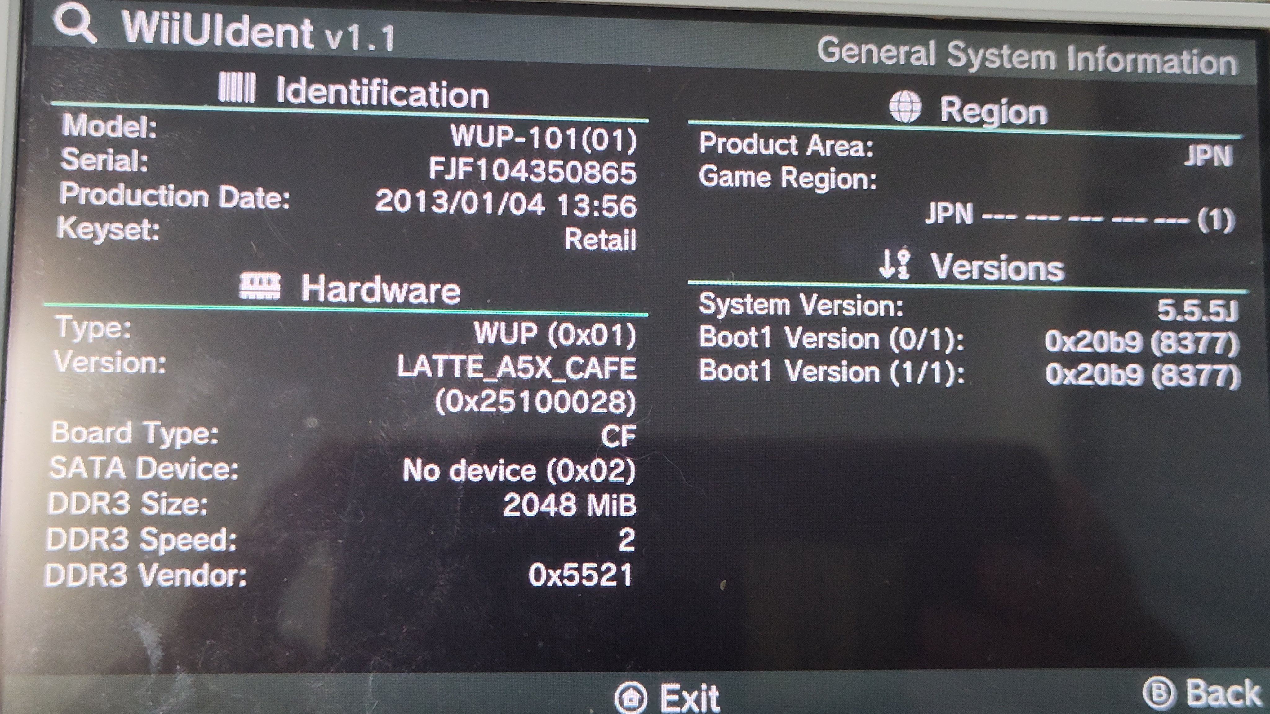

Just feedback some information.
This console was first published here, I tried using DE_fuse, but it seems that MLC is not working well.
  • minute.txt
  • setup.txt

A new question: vWii not work. I can go into vWii interface, whenever I click any app icon it went black screen and throughout a error message,white word on black background.
Then I tried :
vWii-Decaffeinator, erase the vwii title and use system update to reinstall vwii,
System initialization,
Restore slccmpt backup,
same result,not work.
Ysecond
Apr 27, 2023
187
26
493
China
Then I tried :
没接光驱吧?
