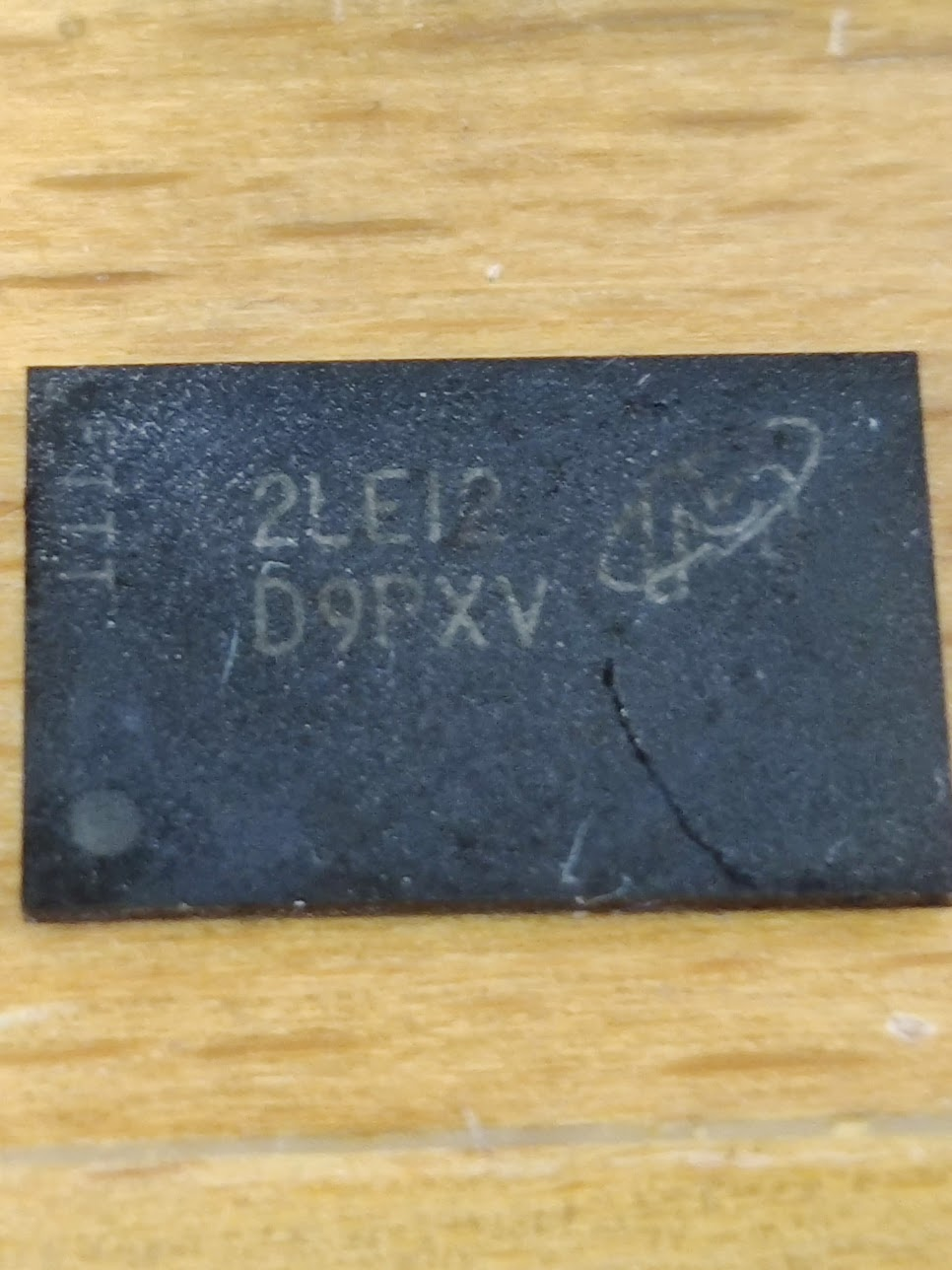

Though I did take one chip off already, waiting on a stencil and balls from AliExpress to arrive, so no real rush.

if you already taken a chip off, that could help us mapping the addresses to the physical chips. If you defuse the console we can run a boot1 from SD without ever touching the DRAM. then we can check which addresses work and which don't. That then can us help diagnose which chip is bad
I will look for replacement memory or wait till I have a donor.
What Manufacturer of memory does your Wii U have? Maybe @Lazr1026 could provide you some. She has a bunch of donor boards.
Looks like Micron

This is very strange. I hope it's not bad DRAM. Make sure you have the latest wafel_core from here: https://github.com/jan-hofmeier/stroopwafel/releases
yea that is the one im using This happened when i rebooted after attempting ios_orig

I attached two memtests. You flash them to the sdcard like you did with the boot1.img
You first flash one, run it and then repeat it with the other.
Remove the fw.img from your card, while running the tests. If the test is finished it should print EE EE EE EE FA FB FC FD and the LED will probably flash orange.
Copy the what you see in putty here after each test.
If it starts printing lots of stuff it probably failed and it would take a long time to finish. In that case turn the console off and copy a screen full of the output here
Wait, I just looked closely at your output, this is your problem:
ancast: loading plugin `sdmc:/wiiu/ios_plugins/wafel_core.ipx` to 27c00000
ancast: loading plugin `sdmc:/wiiu/ios_plugins/wafel_cores.ipx` to 27d78000
You have the wafel_core there twice. Delete the wafel_cores.ipx and it should work

Omg i feel so dumb I thought renaming it would keep it from trying to read it when i changed between files lol. I guess it just tries to load anything in the ios_plugins folder? Thank you so much that worked and i have a working wii u again. You have been an amazing help @SDIO
