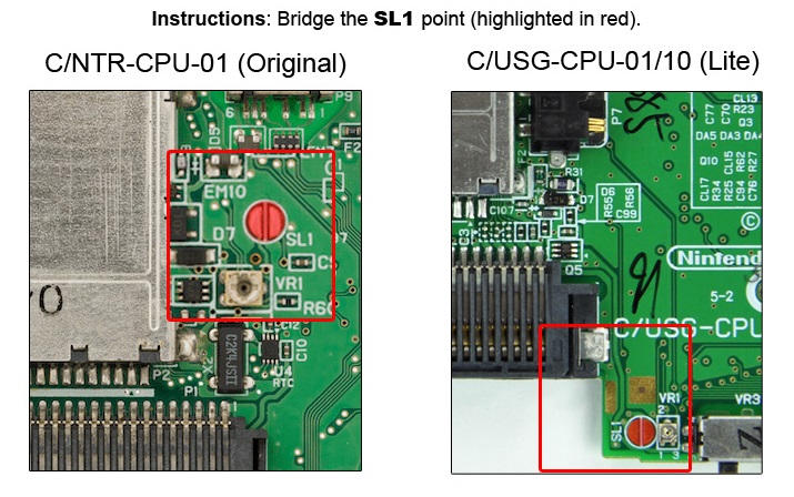

Here's my diagram showing which point you need to shorten to flash the new firmware. The later DS revisions don't allow you to re-write the firmware.

The DS firmware has a write protection on it to stop it being written beyond the settings (name, birthday*, touchscreen calibration, favourite colour, wifi info which this might lack by the way and who knows what will go if you try to run a wifi bearing game that tries to overwrite things) but presumably as a repair option you can enable writing by bridging a couple of pins on the board for both the original and the lite family. This is pin SL1 and can be reached by opening the battery cover. DS originals are pretty easy and you can shove a bit of tin foil, screwdriver or whatever down there and it will probably work just fine. DS lites are still available but also in there is a pad that if shorted to will shut down the DS, not ideal when you are writing a firmware (presumably in this case without a minimum boot restoration feature like flashme has), so people used to use more complicated tools to bridge things (think plastic clicky pen but to short something out instead), or take off the back panel to do more easily (and have to power the thing externally).
