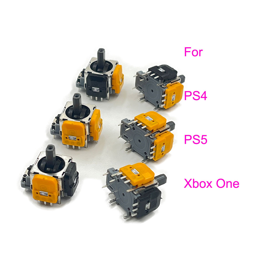

@AKNES Do you sell Hall sticks for normal controllers like this ones:
or:
thanks.
Not, GuliKit works for this.

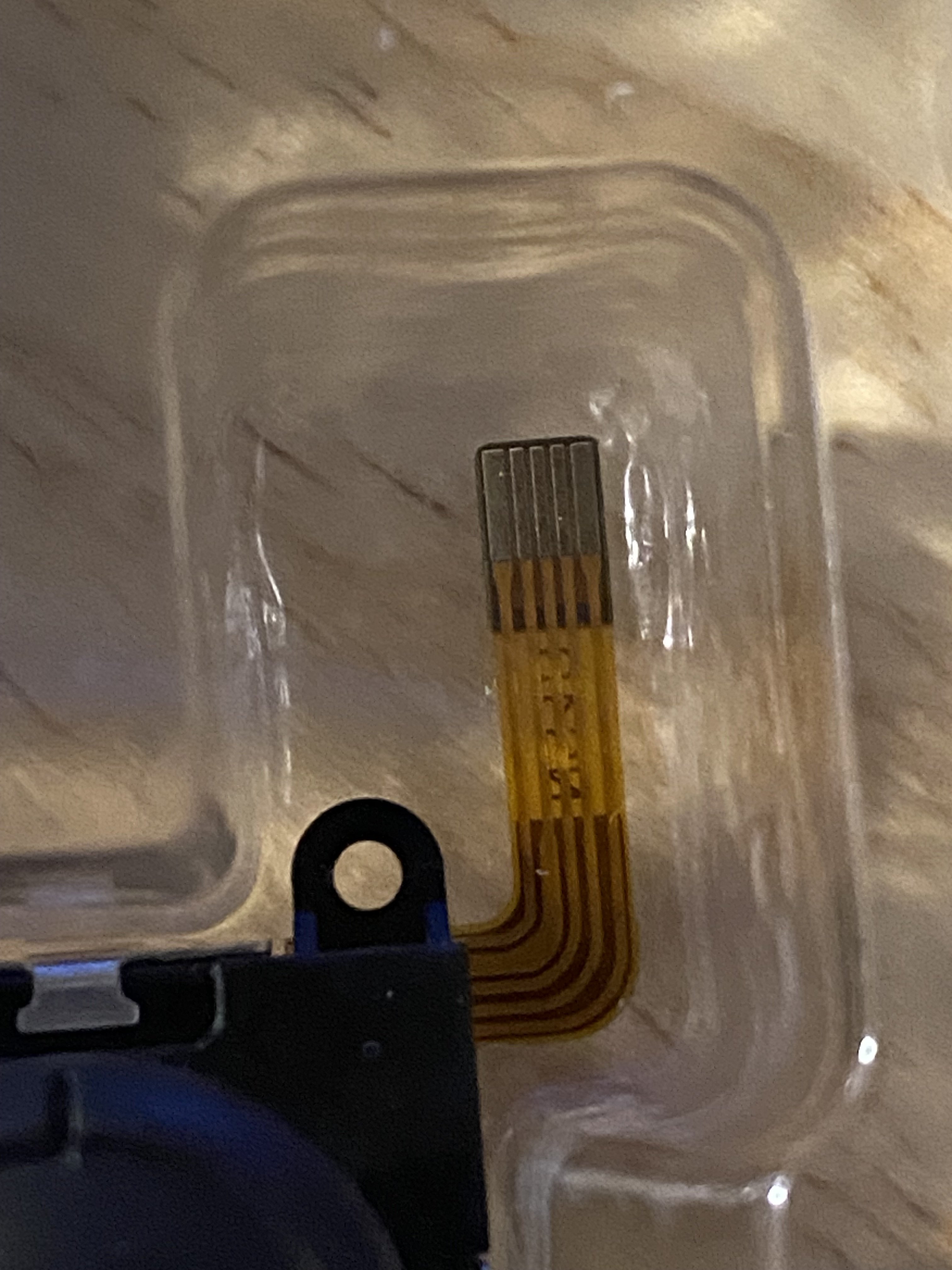

If this is the original joystick and you don't want to replace the controller, you can only buy a replacement joystick from the market first and replace it yourself.

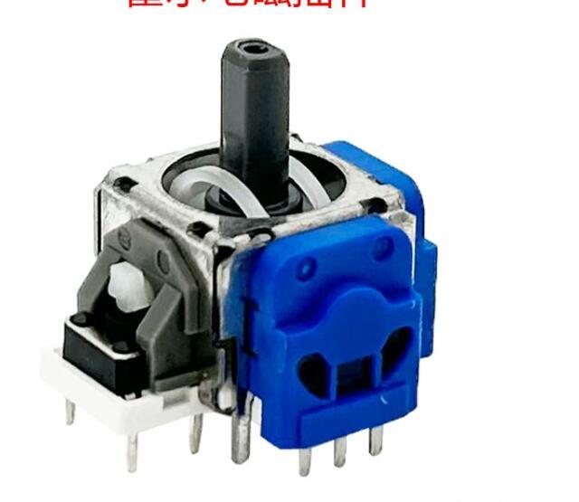

they have any bulit in calibration? or i need to add some potetiometer to them? Or iam that stupid and i still dont know how to calibrate dualsens and sualshock 4 :D ?
that ones on aliexpress have a basic mechanical calibration putting a needle on the potentiometers to move the magnets, but in some cases you could need that flexible PCBs which solder underneath.
Reactions: AKNES
If dualsense or dualshock, i don't know how to calibrate them also.:unsure:
