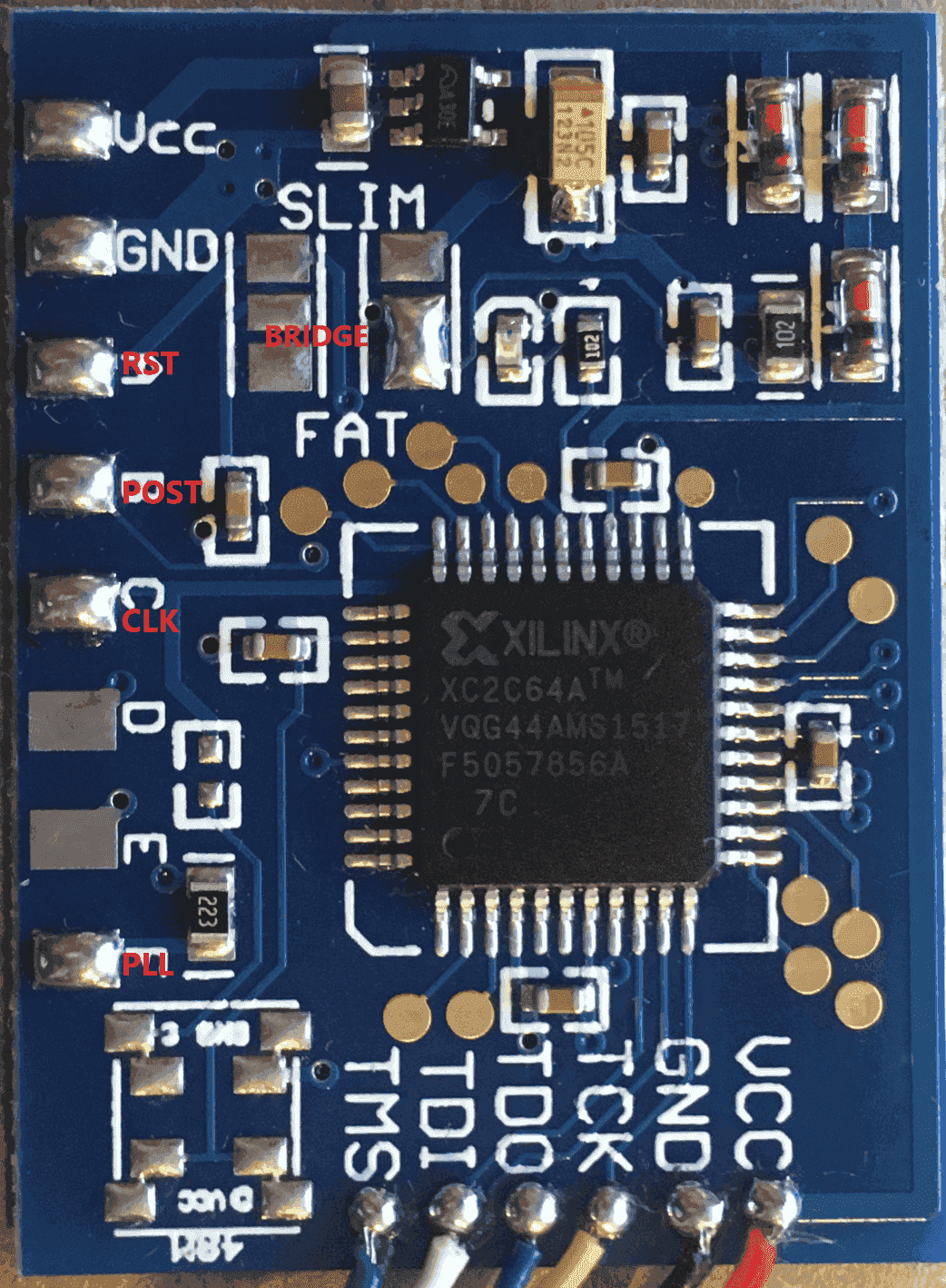

RGH.
This is pretty much the same as the JTAG.
However it has some differences.
First of all this hack is achieved with a special modchip that glitches the 360's boot process.
Then once it's "glitched" you can do everything a JTAG can do.

RGHing your 360 comes with a few extra steps.
First of all, determine what RGH type you'll need to use by your Dash version.
RGH1:
RGH1 is used for Phats with a dashboard equal or lower then 14699.
RGH1 uses only a few wires and is faster then RGH2.
RGH2:
This hack is designed for the Slim, but is also used on 14717/14719 and 15572+ Phatty 360's.

RJTAG is a hacking method developed by Team Xecuter which utilized a JTAG image through a glitching method. It was a very promising development, however due to problems after release of the CR4XL with phat console compatability, and the abandonment of the original RJTAG chip, it has been abandoned in favor of RGH 1.2 by most, if not all Xbox 360 hackers.
RGH 1.2
RGH 1.2 is a method of hacking phat Xbox 360's created by Russian hacker 15432. It utilizes the original wiring of RGH 1.0 while also enabling RGH 2.0 Nand images. This means it will work an any Phat Xbox 360 console regardless of current dashboard. It is suggested you be on at least 17150, as that was the dash it was created on, though in theory it will work on any RGH2 dash.
This method requires custom programming of the used modchip, and we will detail the process below. The most utilized modchips in this process are the Matrix Glitcher V1,
The Xecuter Coolrunner Rev C, And the Ace V3 although it requires some modification to be used. The Ace does have a special feature which auto-tunes itself when the self-timing file is used. In this tutorial we will be using a Matrix Glitcher V1 modchip.
Supplies: A PHAT Xbox 360 console(preferably Jasper or Falcon Mobo, Xenons and Zephyrs have a low successful glitch rate), Jrunner program, RGH 1.2 timing files, a compatible modchip, 26-30ga wiring, solid strand preferred for bottom points, JRProgrammer V2 kit,
25-35W soldering iron, flux, thermal paste, 91% IPA or MEK, office tape, and Qtips. A hot glue gun is also highly suggested.
Preparation: Disassemble phat Xbox 360 down to the bare mobo with Xclamps removed, clean old TIM off of CPU, GPU(not necessary but highly recommended) and heatsinks, clean soldering points well, might as well clean the whole board if you can at least with a can of duster, tin(pre-solder) your modchip pads(including xilink connections on modchip if using Matrix) and soldering points on mobo, attach nand wiring to mobo, attach xilink connection wires to modchip, program modchip with file 19 for Falcon mobos and 21 for Jasper mobos.
View attachment 122857 View attachment 122858 View attachment 122859 View attachment 122860
Programming the modchip is done through the "Advanced" tab in Jrunner. Click it, and navigate over to "Custom Nand/CR functions. You'll see a tab pop up. Click the browse box, and navigate to where you've stored the 15432 timing file pack.
In this instance, we're programming a Matrix Glitcher for a Falcon mobo, so we'll use file 19 from the RGH1.2 pack. You'll have to navigate to the "if you mad" folder. Find file 19, and click "Run"
Go ahead and solder in the chip. Use the office tape to hold the wires down for now.
Soldering points: All of your points will be on the bottomside, other than GND and VCC(3.3v)
PLL/RST-View attachment 122864
(Note, these points are especially difficult as they're quite small, located very close to other components, and will RROD the console if damaged. Be very cautious and be sure to tin the points before attaching wire)
CLK-View attachment 122871
POST-View attachment 122875
GND-View attachment 122876
VCC(3.3V)-View attachment 122877
Dumping the Nand: First, you'll want to attach your JR Programmer V2 to the Nand connection wires and your PC. Make sure you have the console plugged in, but NOT ON. Dumping the Nand is quite simple with Jrunner. It was created to be linear so obviously, click "Read Nand." This will read the Nand twice and automatically compare to verify a good read.
View attachment 122878 View attachment 122879 View attachment 122909 View attachment 122887
Creating/writing the ECC: After you've backed up the 2 Nand reads which are located in the output folder of Jrunner to another folder, move immediately to the right and you'll notice a button that says "Create Xell Reloaded." This is for JTAG or RJTAG so we dont want this option. Simply clitch "Glitch 2" over in the xebuild options, and click "Create ECC" where "Create Xell Reloaded" was previously.
Now, with your programmer connected, go ahead and click "Write ECC" which is also immediately to the right. Jrunner will now write the program you need to retrieve your CPU key to the console.
Booting Xell and retrieving CPU key: After the ECC is written to the Nand, unplug the JRProgrammer V2 from the console, reattach the heatsinks with new TIM, pop the fan out of the cage, and place it blowing towards the heatsinks. Plug in the RF board, your A/V cable(it can be HDMI), and power supply. Press the little button in the middle and if all is well, Xell will boot and display your keys. Take a pic of your keys or write them down.
View attachment 122894 View attachment 122895
Tuning the chip timing: This is a good time to tune your chip timing if you're not satisfied with the boot times thus far, or if you cannot achieve Xell at all. Simply go through the chip writing process again, methodically selecting different timing files and attempting bootup until you reach your desired results. The files I've found to work best are 19, 20, and 21.
Creating image: Going back to Jrunner, type in your CPU key. As soon as its completely written in correctly, Jrunner will automatically decrypt the Nand and its contents and move the output to a folder in its directory which will be named as the serial of your console. It will also try to go back to JTAG/RJTAG settings. Again, click "Glitch 2." Now, immediately to the right(notice the pattern) you'll see a button that says "Create XeBuild Image." Click it and watch Jrunners magic. It will completely build the hacked dashboard for you.
View attachment 122897 View attachment 122910
Writing image: At this point you can hook your console back into the JRProgrammer V2 which should still be plugged into your PC. Again, plug the console in BUT DO NOT TURN IT ON/IT MUST BE OFF. Click "Write Nand," and it will begin writing the hacked dashboard image to the console. After it's completed, unplug the console, and programmer. Plug the console back in with the A/V cable and boot it up a few times to make sure the boot times are still good. You will also want to place it back in the cage, with the DVD drive connected and fan back in to verify a few more times.
Wrapping up: If you've achieved a successful hack, congrats. Now it's time to reassemble but first, I'd highly suggest using the hot glue gun to lock the wiring in place. You should also clean up any flux residue left over.
