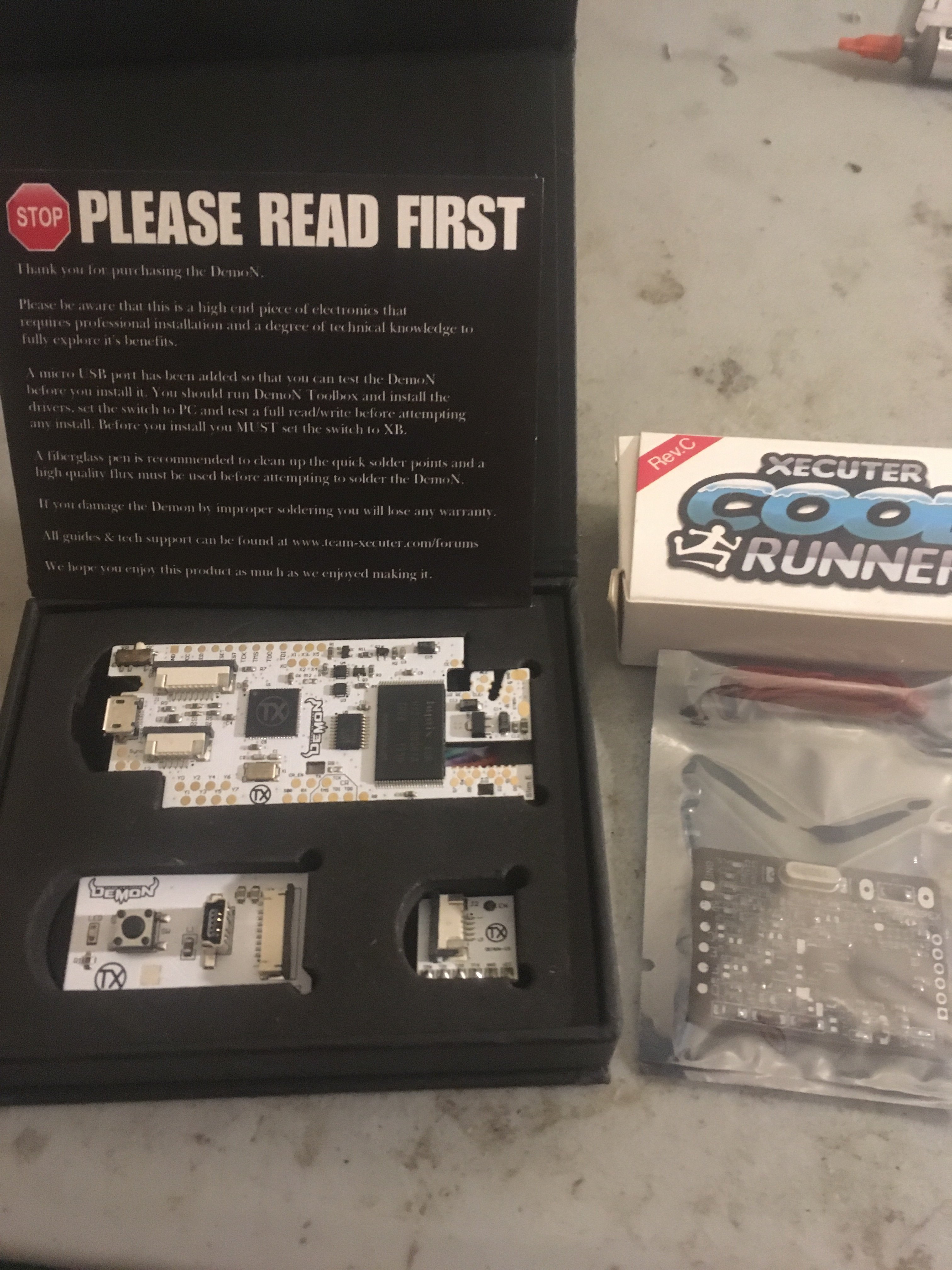

I have a couple TX Demon Slims here if you’d like. It’s a dual nand device.
I’m in Phoenix Arizona, so lmk if I can help you with either option you’re considering.
