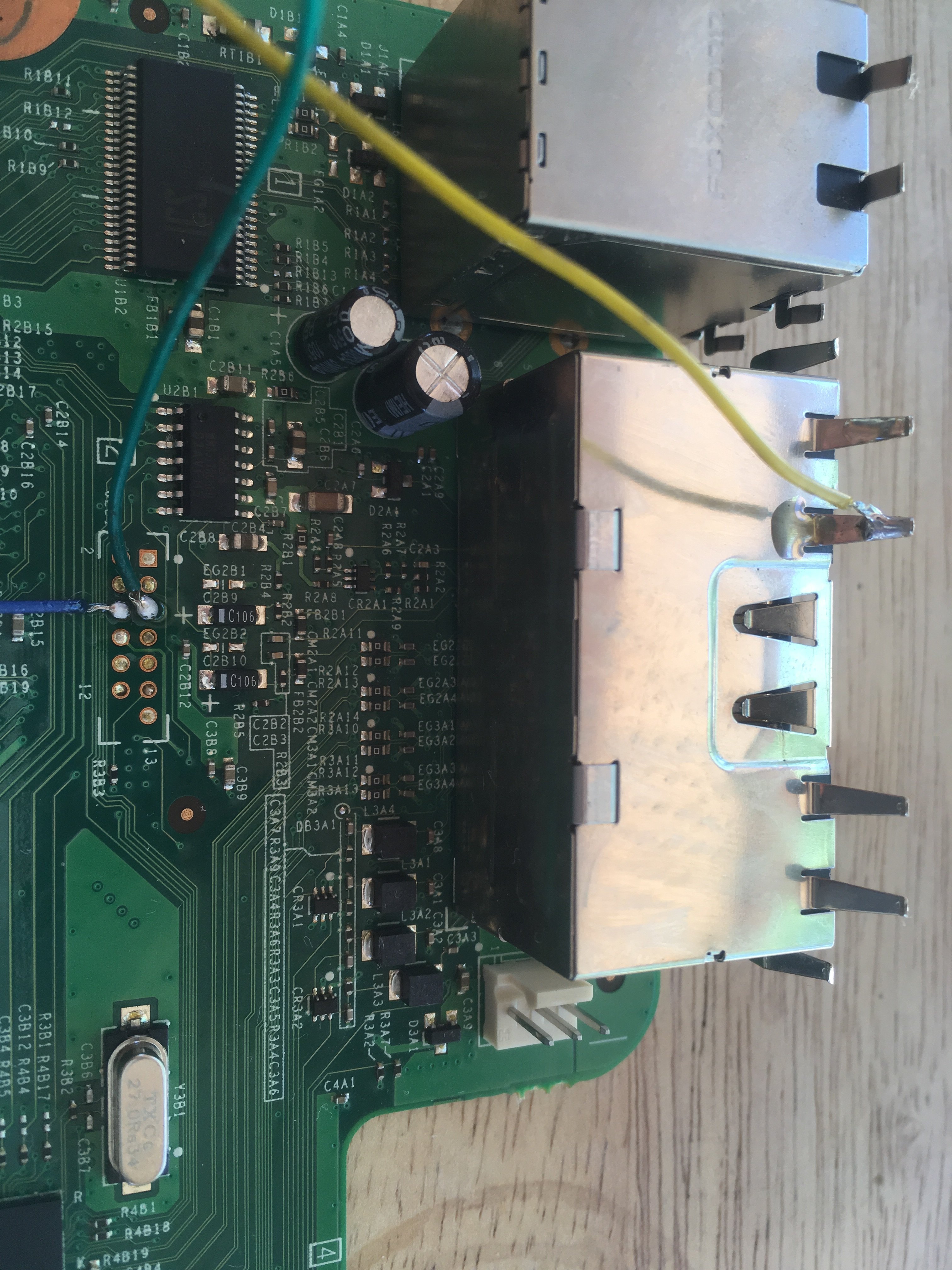

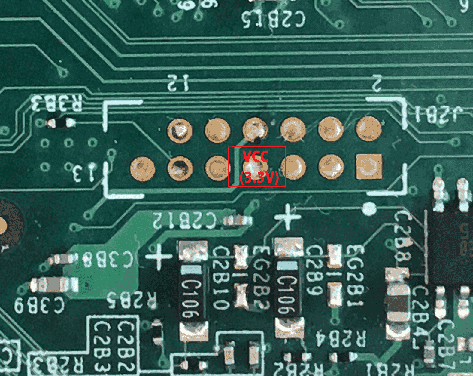

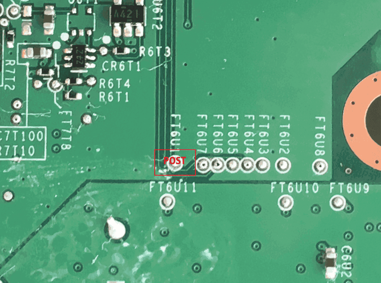

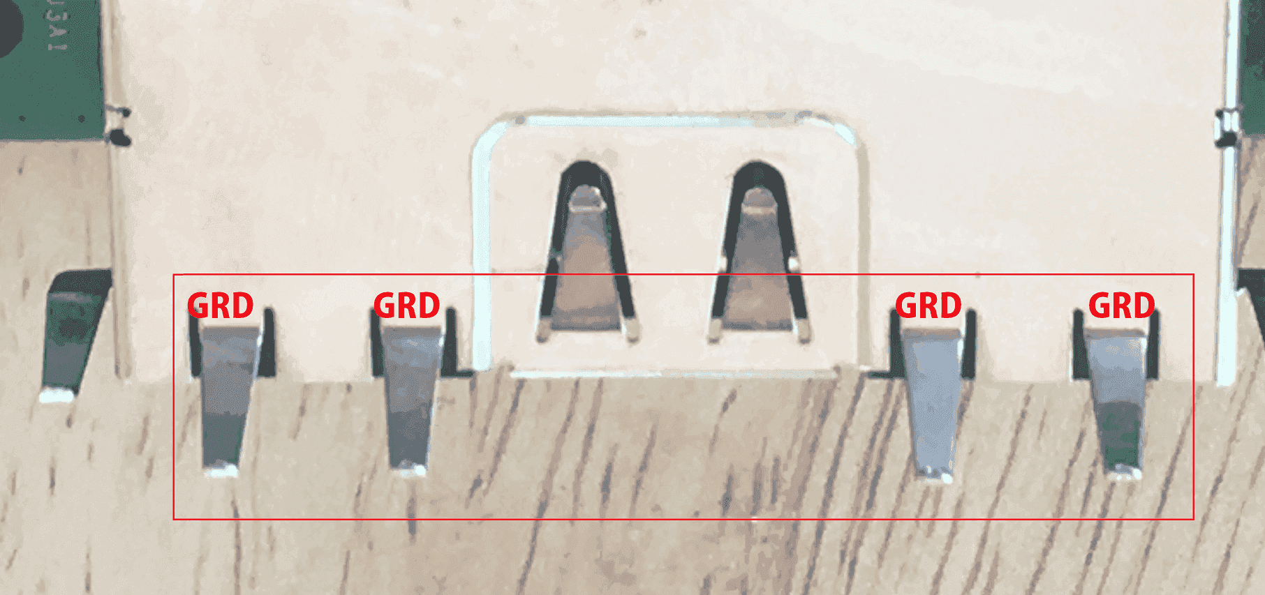

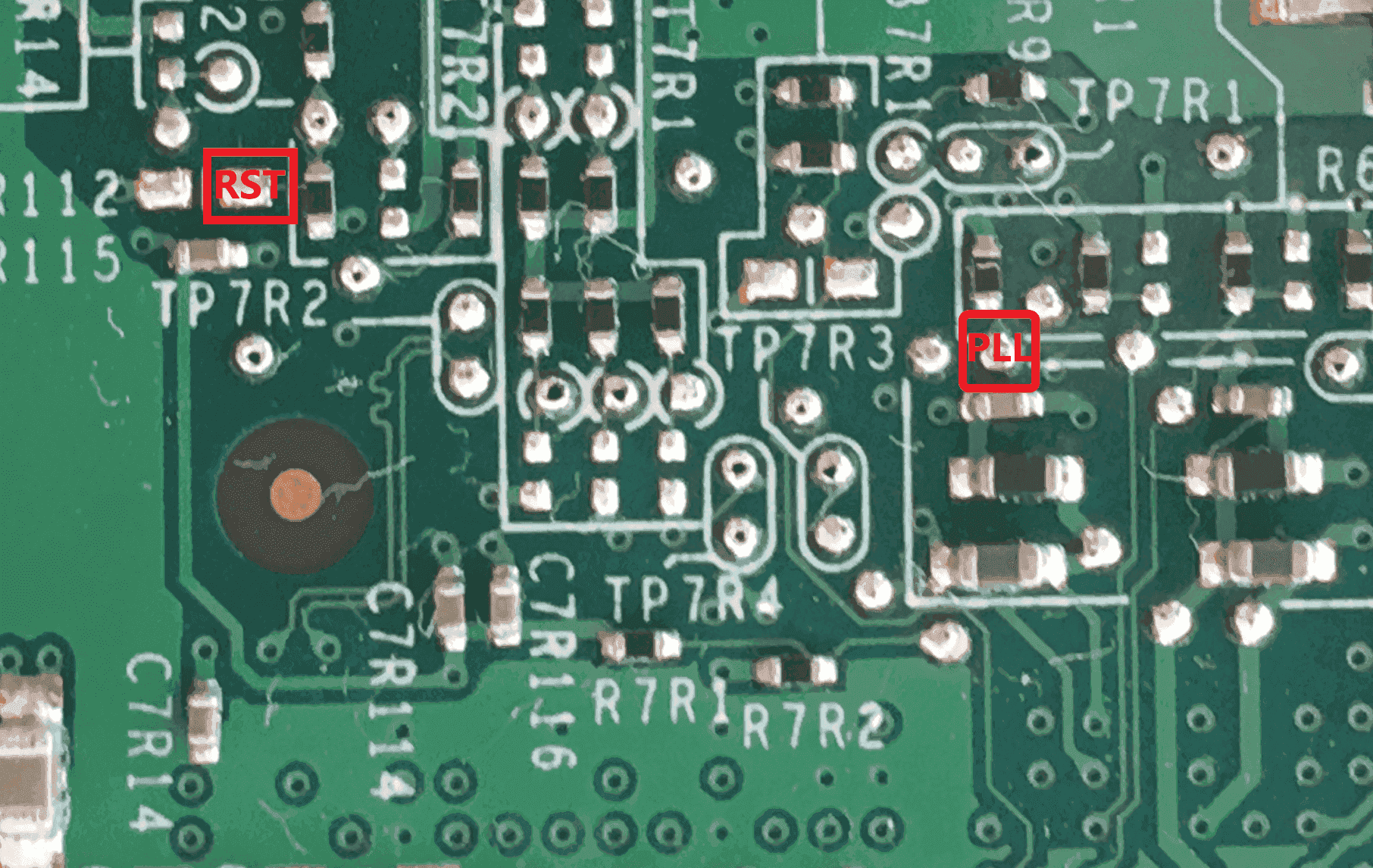

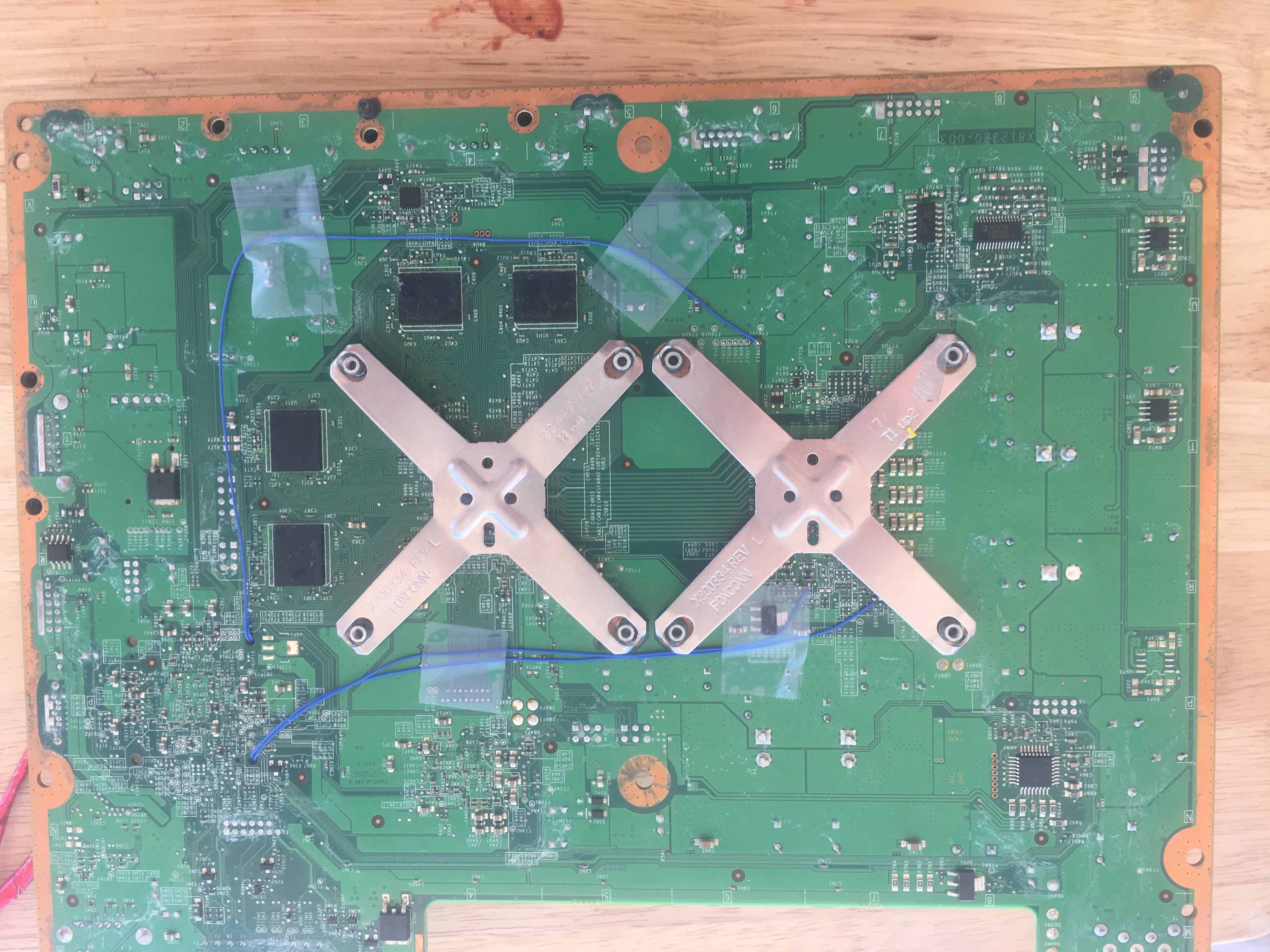

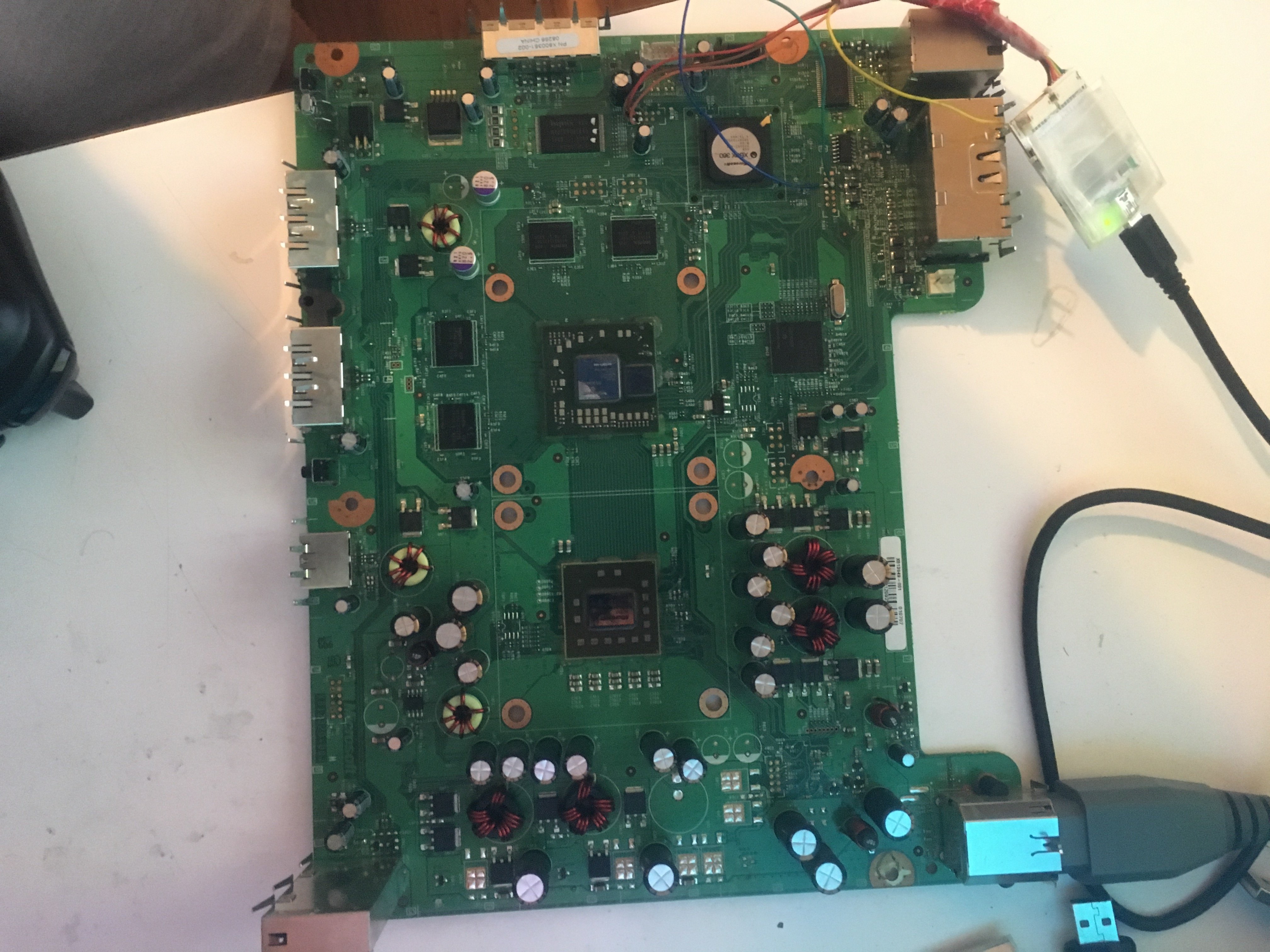

Hey guys! Sorry for the long time inbetween asking for help. I received the wires I talked about a few pages back right after christmas, and I changed the wires I had already soldered to the console, I tried different routings, and different timing files, but to no avail. I gave up on the Matrix Glitcher, and I bought an X360 Ace (rev 2), and tried to glitch with the the dynamic timing file, but it still doesn't boot xell. Right before posting, I tried to flash the stock NAND, just to check if the board was fried, and that boots fine, no problems. Does anyone know what can cause it to not glitch?
What motherboard you trying to glitch?
Dynamic files doesn't always work. You have to try "ALL" timings when you get a stubborn mobo. Ive had Jaspers where only a few timing files would glitch it.
Well, that sucks. I guess I'll try that then. Do I need to solder the resistor back on? And how about the 1.8V point, do I still need that? And the clock point, do I use the ones from this guide, or do I still rely on the X360 Ace's own clock?
Edit: Almost forgot, how about the 22k resistor for the PLL point, is that still necessary?
Follow whatever guide your following. Done many RGHS and never needed 22k.
Reactions: zfreeman
Alright, I'll do that. Thanks for the help!
On another note, is there any particular reason (other than bad wire routing and bad soldering) that might cause it to not work?
Wire routing can have an affect. If rgh 1.2 your doing then cables lengths should be as short as possible with good routing though.

Supplies: A PHAT Xbox 360 console(preferably Jasper or Falcon Mobo, Xenons and Zephyrs have a low successful glitch rate), Jrunner program, RGH 1.2 timing files, a compatible modchip, 26-30ga wiring, solid strand preferred for bottom points, JRProgrammer V2 kit,
25-35W soldering iron, flux, thermal paste, 91% IPA or MEK, office tape, and Qtips. A hot glue gun is also highly suggested.

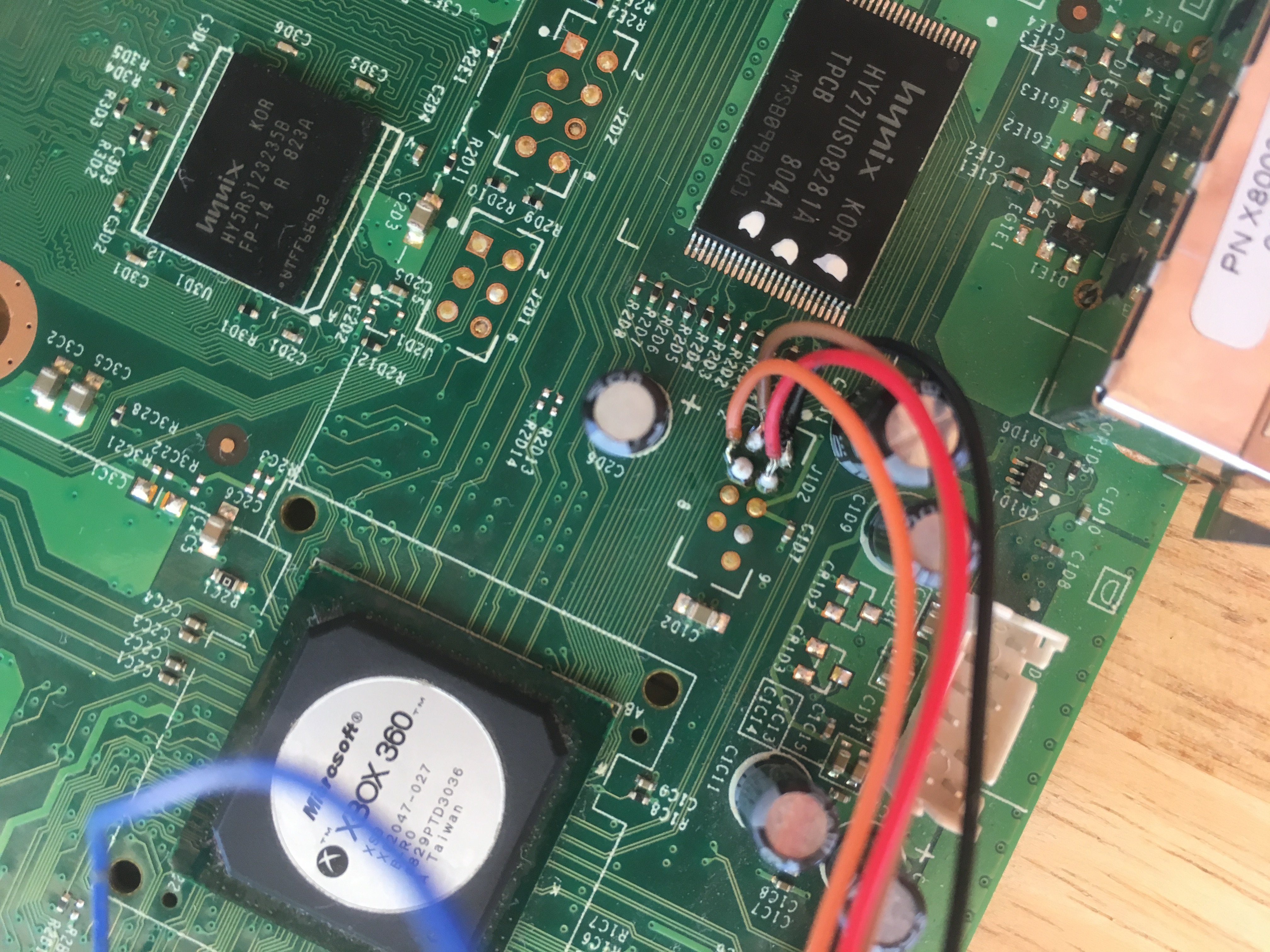

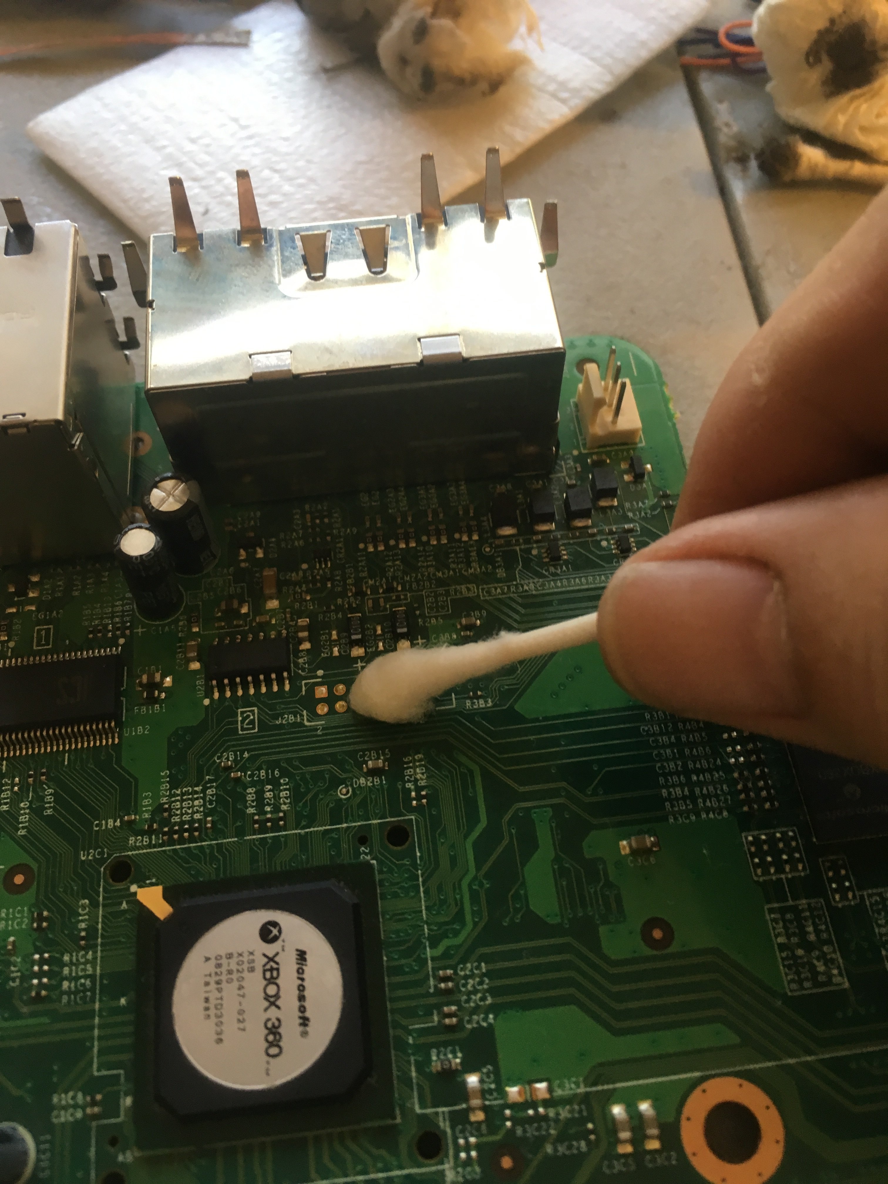

Preparation: Disassemble phat Xbox 360 down to the bare mobo with Xclamps removed, clean old TIM off of CPU, GPU(not necessary but highly recommended) and heatsinks, clean soldering points well, might as well clean the whole board if you can at least with a can of duster, tin(pre-solder) your modchip pads(including xilink connections on modchip if using Matrix) and soldering points on mobo, attach nand wiring to mobo, attach xilink connection wires to modchip, program modchip with file 19 for Falcon mobos and 21 for Jasper mobos.
View attachment 122857 View attachment 122858 View attachment 122859 View attachment 122860

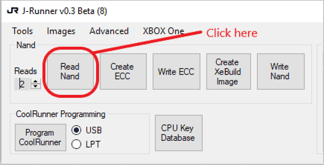

Programming the modchip is done through the "Advanced" tab in Jrunner. Click it, and navigate over to "Custom Nand/CR functions. You'll see a tab pop up. Click the browse box, and navigate to where you've stored the 15432 timing file pack.
In this instance, we're programming a Matrix Glitcher for a Falcon mobo, so we'll use file 19 from the RGH1.2 pack. You'll have to navigate to the "if you mad" folder. Find file 19, and click "Run"

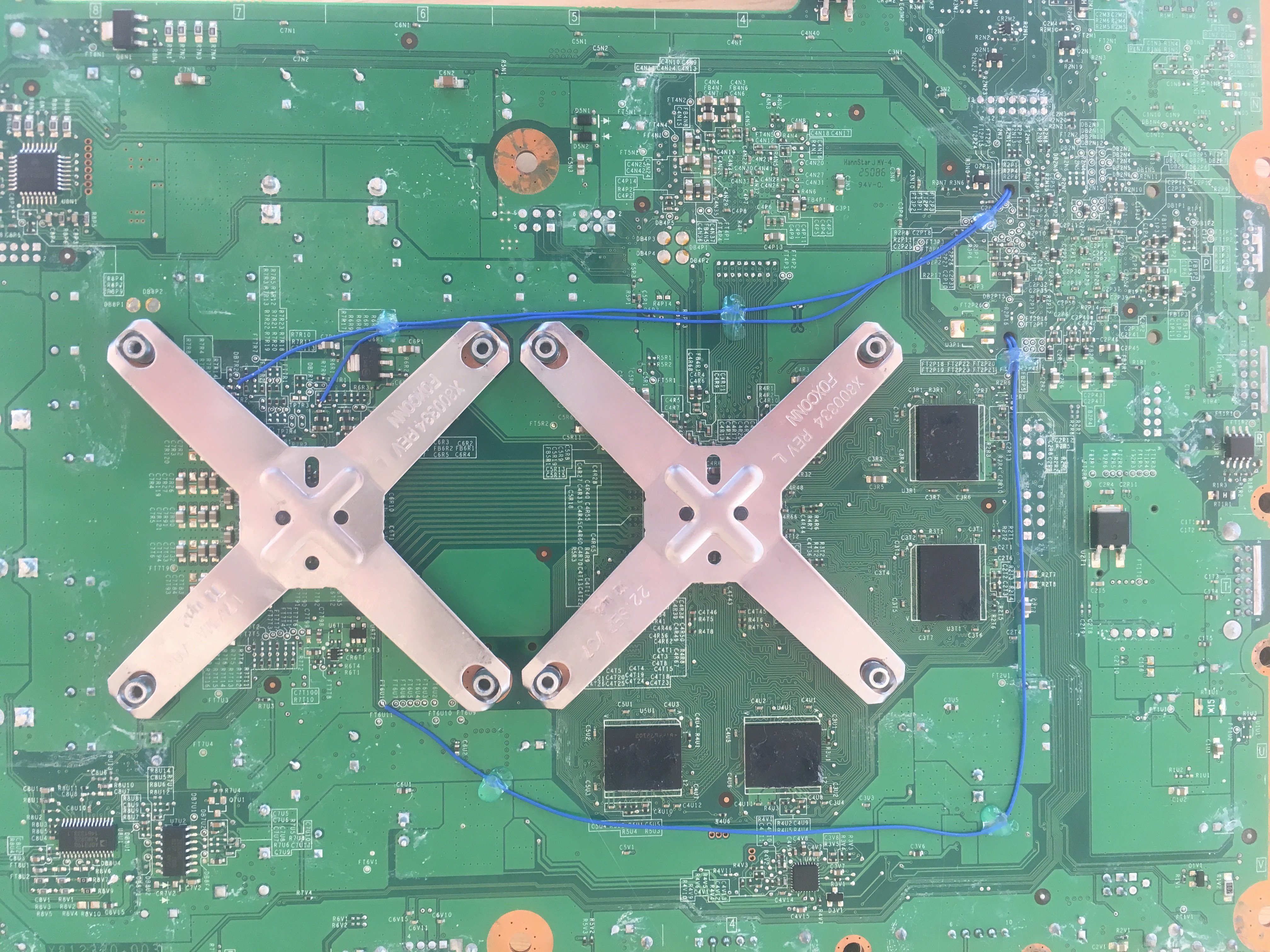

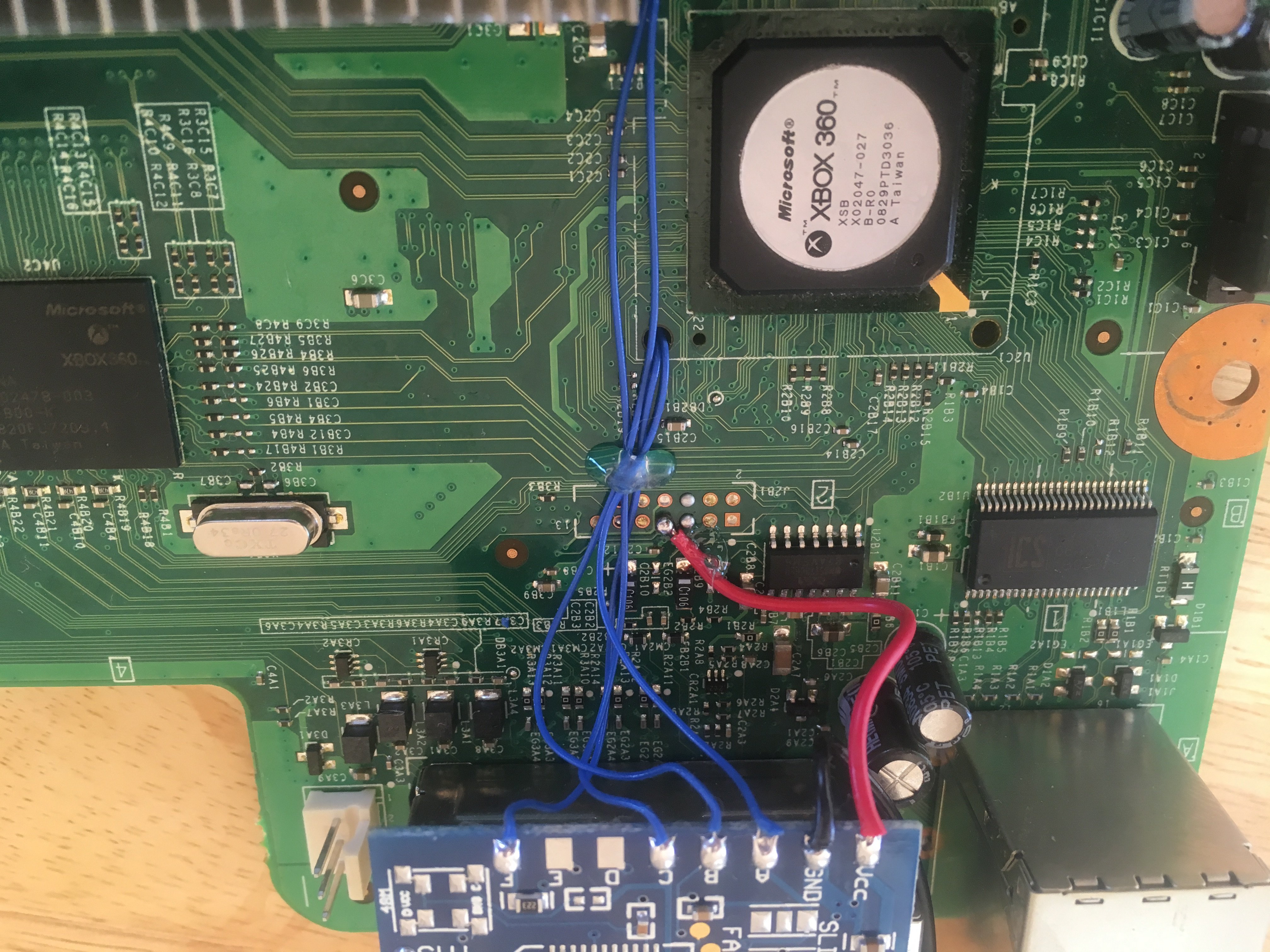

Go ahead and solder in the chip. Use the office tape to hold the wires down for now.
Soldering points: All of your points will be on the bottomside, other than GND and VCC(3.3v)
PLL/RST-View attachment 122864
(Note, these points are especially difficult as they're quite small, located very close to other components, and will RROD the console if damaged. Be very cautious and be sure to tin the points before attaching wire)

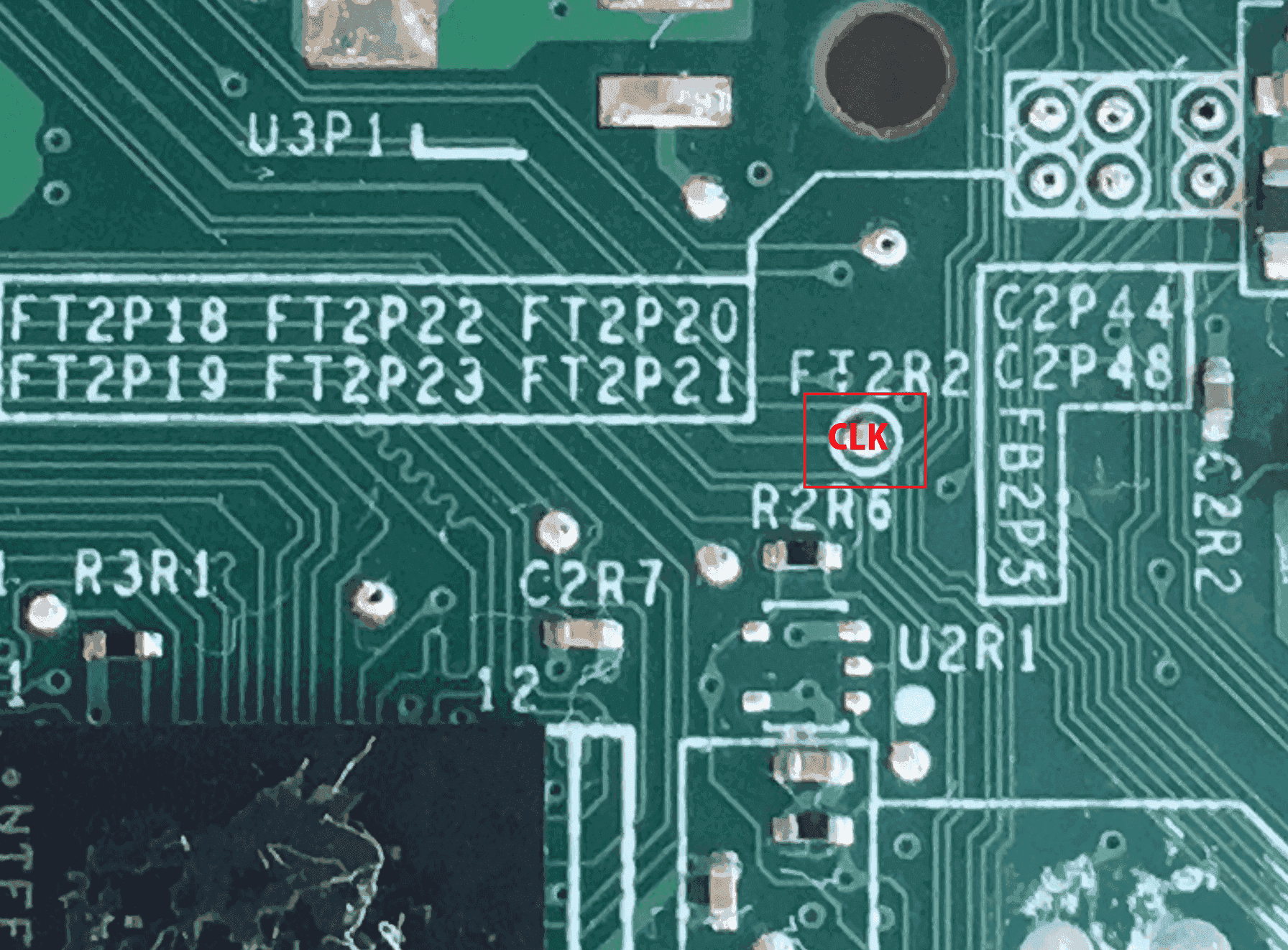

CLK-View attachment 122871
POST-View attachment 122875
GND-View attachment 122876
VCC(3.3V)-View attachment 122877
Dumping the Nand: First, you'll want to attach your JR Programmer V2 to the Nand connection wires and your PC. Make sure you have the console plugged in, but NOT ON. Dumping the Nand is quite simple with Jrunner. It was created to be linear so obviously, click "Read Nand." This will read the Nand twice and automatically compare to verify a good read.
View attachment 122878 View attachment 122879 View attachment 122909 View attachment 122887

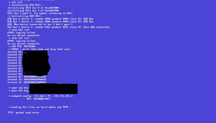

Booting Xell and retrieving CPU key: After the ECC is written to the Nand, unplug the JRProgrammer V2 from the console, reattach the heatsinks with new TIM, pop the fan out of the cage, and place it blowing towards the heatsinks. Plug in the RF board, your A/V cable(it can be HDMI), and power supply. Press the little button in the middle and if all is well, Xell will boot and display your keys. Take a pic of your keys or write them down.
View attachment 122894 View attachment 122895
Tuning the chip timing: This is a good time to tune your chip timing if you're not satisfied with the boot times thus far, or if you cannot achieve Xell at all. Simply go through the chip writing process again, methodically selecting different timing files and attempting bootup until you reach your desired results. The files I've found to work best are 19, 20, and 21.
