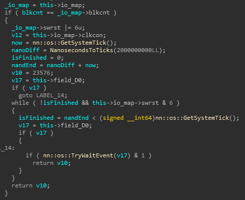

RE'd example from FS:
Don't forget that normal titles use the SDK and the SDK is full of this shit too (while libnx does it too, it does not seem to cause a race for these instances)
Normally the timers should not be impacted by the clock rate, but timers have been bugged on other SoC's before (like erratum A-008585), so a problem like this could very well not be existent at lower clocks.
