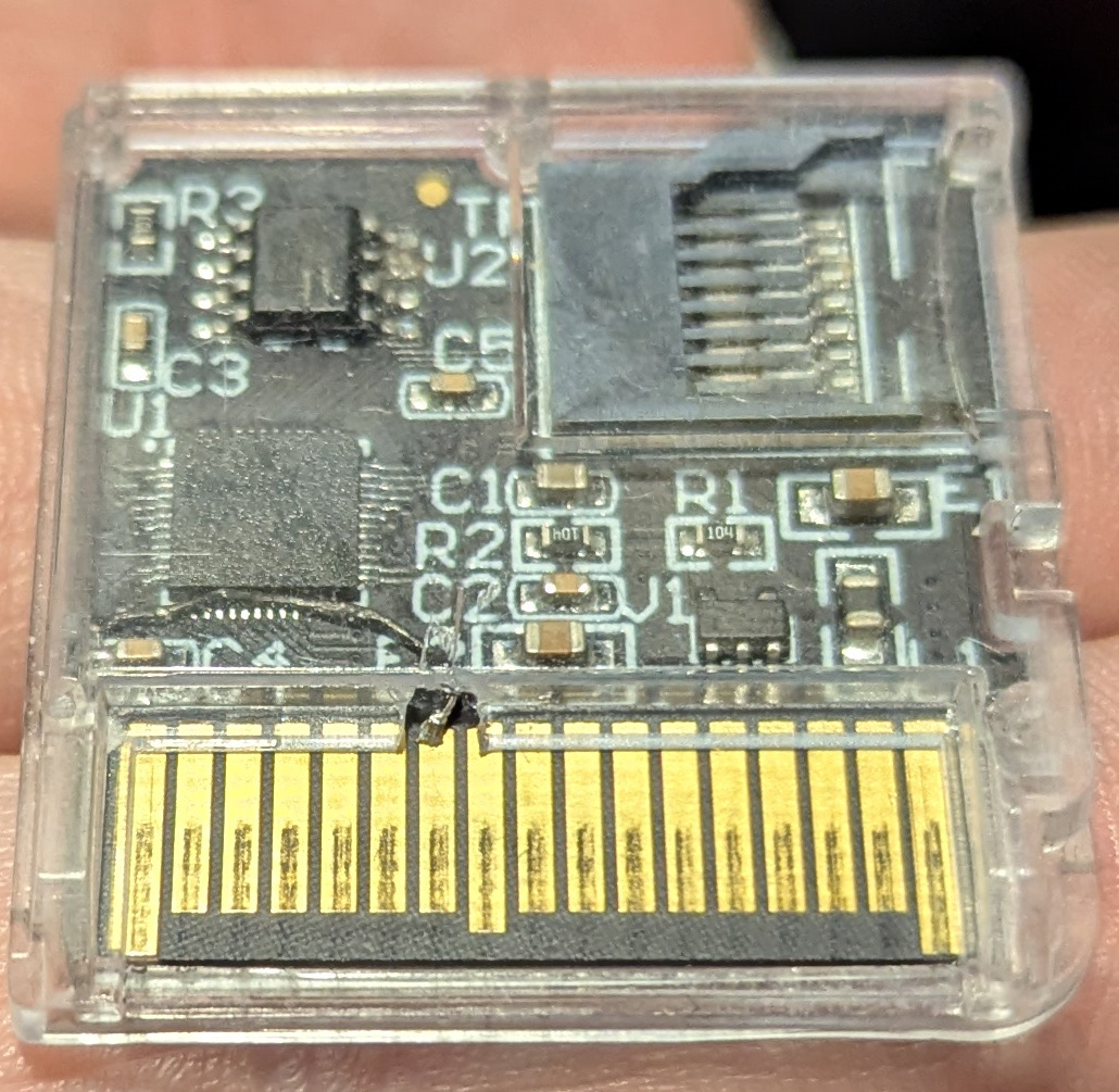

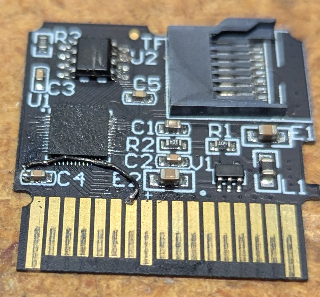

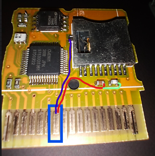

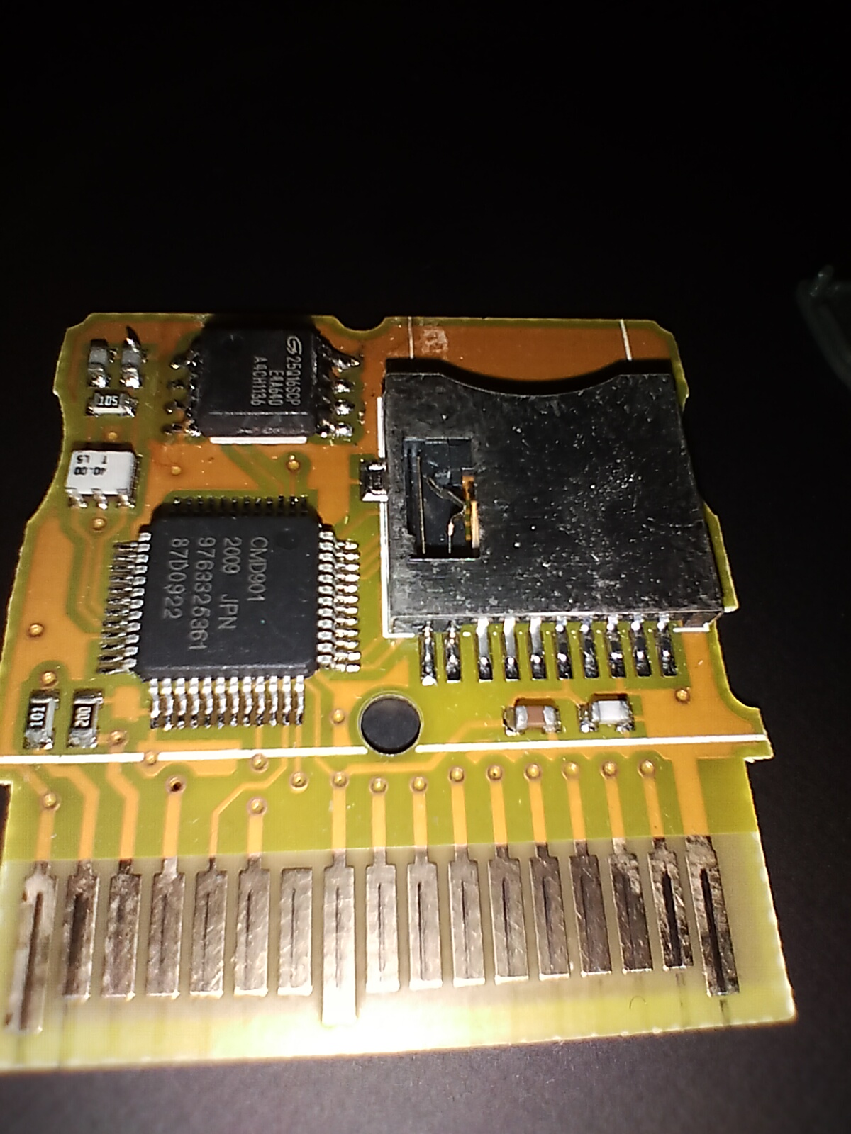

I found the ultimate solution to EZP's issues supporting sleep mode. It turns out they left the IRQ pin unconnected on the cart's PCB. This requires a board revision to fix properly. So don't expect any updates from EZFlash on this. It's why they have not attempted to fix this problem. (it would require adding patches to all games to fix the sleep problem in software or manufacturing a revised PCB)

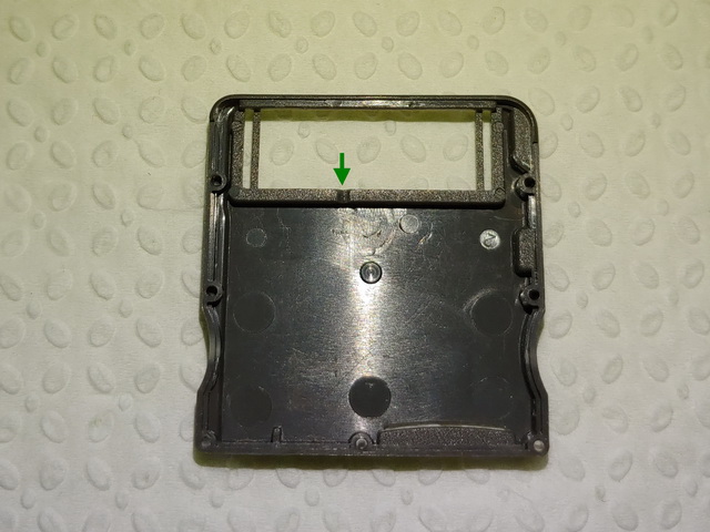

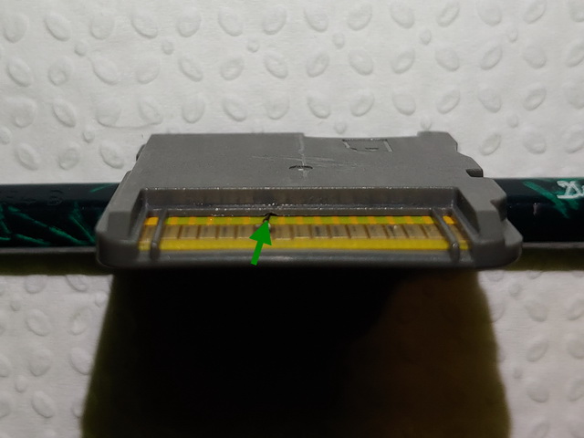

But I did find that it's possible to add a bodge wire to fix this problem myself. Photos show the bodge. All you have to do is ground the IRQ pin. I compared this pin with other flashcarts. The pin is typically grounded on them which is why they support sleep mode but this one does not. I used the ground side of the left most capacitor as the ground connection for the wire. It's a relatively simple mod if you have the soldering equipment. Does require a cut be made to the shell. Unless you somehow manage to keep the solder amount so thin that it would fit...but it's easier that you make the cut so you can make the proper connection.
As you can see sleep mode support for EZP can be corrected with a somewhat simple hardware mod. Does require some soldering skills and a razor for cutting a notch in the shell to make room for the connection. I'm not sure why they omitted this from their design..... Seems like a rookie mistake. :P
View attachment 551045View attachment 551046

The easiest would be to solder it to the SD slot shell, since it should be grounded. For the capacitor option, you MUST confirm first with a multimeter which side is the ground, take my suggestion with a grain of salt until you confirm which side is ground (It's clear that the side I pointed out is soldered to ground, but better safe than sorry :p).
I bought multimeter. But I can't find tutorials how to find ground on PCB. Can you give me basics what mode to use and where to place both red and black cables?

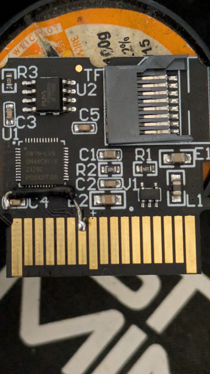

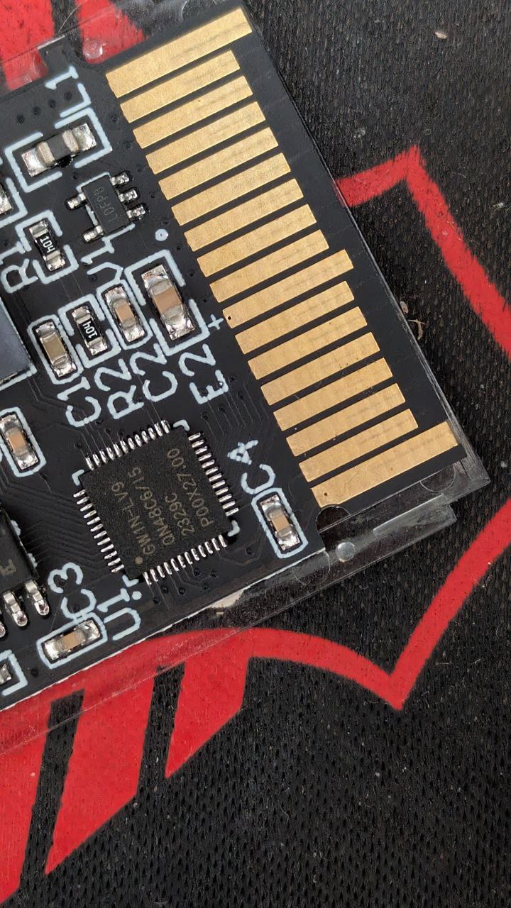

Thank you so much, Apache Thunder!
This was the only issue I had unovercomable with this flashcard... I was considering giving it away for free, so me, with my horrible soldering skills went to work. I ripped apart the closest cable I had at my disposal and tried to solder the pcb.
Note that I haven't even manage to solder two pieces of cable together before. (Don't YOU try this at home unless you want a paperweight flashcard, people!)
And as they say in the industry: "It just works!"
It's not pretty - the cable might be a bit thick and the soldering work is stinky. But I am grateful, happy and I learned so much along the way. (I was researching soldering for 4 hours before attempting this, also.)
Super thanks, and thank Vikrinox for directing me to this post. :)
One ground point should be enough. I have mine soldered to the shield pads of the microSD card slot and so far it works just like how it should.
