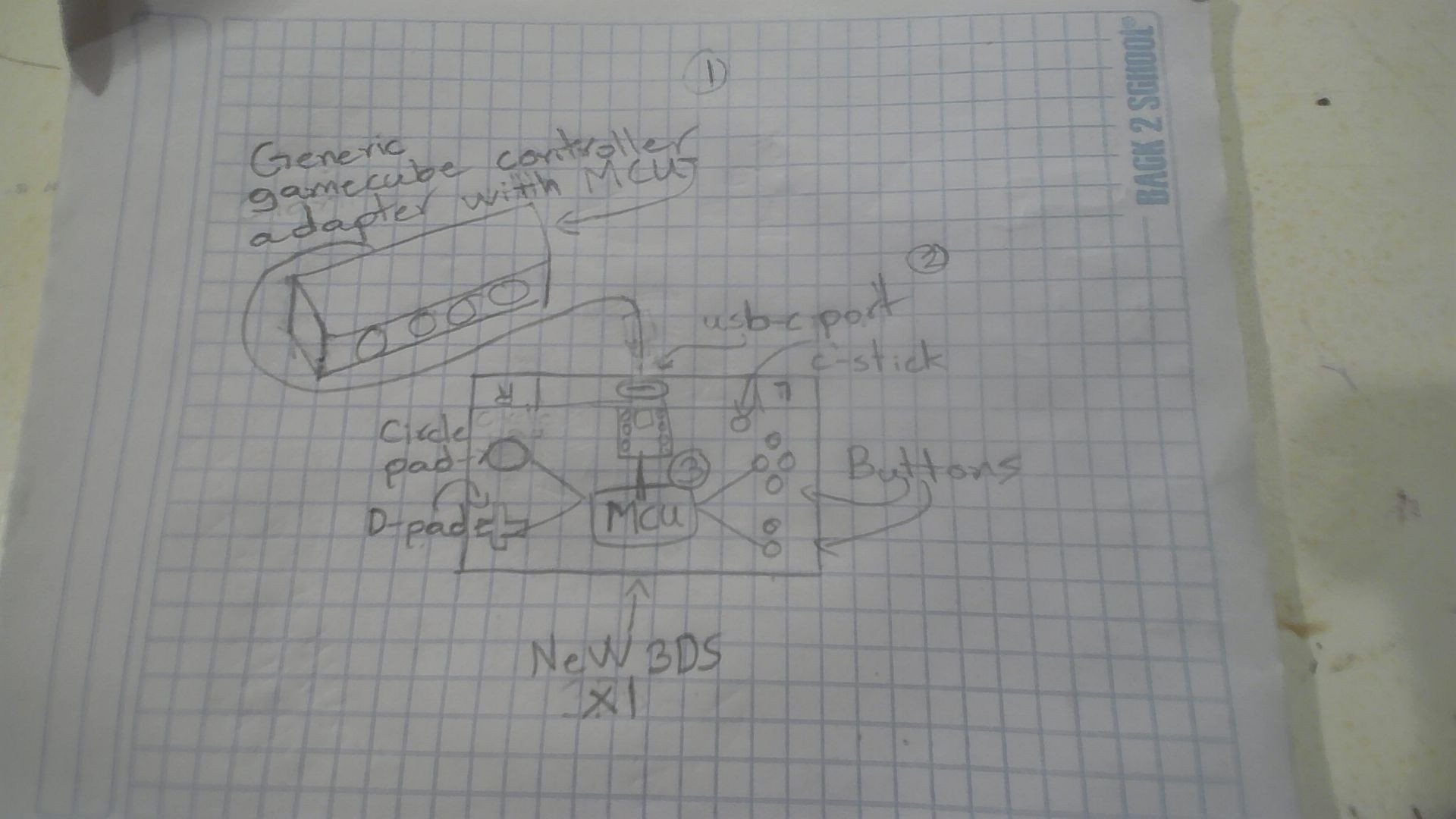

Hi everyone!
I’m Iker from Nuevo León, Mexico. I’m starting a project I’ve been dreaming about: connecting a GameCube controller to my New 3DS XL using a custom internal hardware mod. I want to be 100% upfront: I am a complete beginner in electronics and coding, but I have a clear vision of the architecture and I'm ready to learn.
The Concept (Modular Dual-MCU Design)My goal is to keep the console looking as stock as possible while having a "plug-and-play" experience using a single USB-C cable for data:
  1. The "Brain Box" (External):
    • A generic GameCube-to-WiiU/Switch adapter inside a box will serve as the physical ports.
    • An Arduino (Nano or Pro Micro) inside this box will read the GameCube controller data.
    • This data is sent via Serial protocol through a USB-C cable that connects the box directly to the 3DS.
  2. The Console (N3DS XL):
    • A USB-C female port installed in the 3DS shell receives the signal from the external box.
    • This port is wired internally to an ATtiny85 (MCU).
    • The ATtiny85 acts as the decoder: It receives the serial data and its output pins are soldered directly to the button test pads on the 3DS motherboard to trigger the inputs (A, B, X, Y, etc.).
  3. Why this approach?
    • It avoids a bulky 15-wire cable; only 4 wires (VCC, GND, D+, D-) are needed through the USB-C connector.
    • The 3DS remains portable and clean when the external box is unplugged.
The Challenges (Where I need your expert help!)Since I'm learning everything from scratch, I’m looking for guidance on:
  • Soldering Points (Test Pads): I need specific maps for the New 3DS XL motherboard. Which pads are the safest to solder to for the main buttons and triggers? I want to avoid lifting any pads or damaging the traces.
  • The Code: How to properly sync the Serial communication between the external Arduino and the internal ATtiny85 to ensure minimal input lag.
  • C-Stick & Circle Pad: Since the C-stick is a strain gauge, what’s the best way to simulate those analog signals using the internal MCU?
  • Voltage Management: Handling the 3.3V logic of the 3DS vs the 5V requirements of the GameCube controller logic/rumble.
My CommitmentI’m not looking for someone to do all the work for me. I am willing to:
  • Be the beta tester and risk my own N3DS XL for the sake of the project.
  • Document the entire process with photos/videos to create a public tutorial once it’s finished.
  • Learn and practice whatever skills are needed (Fine-tip soldering, Arduino IDE, etc.).
I’ve attached a sketch of my diagram to help visualize the flow. I would love to hear your thoughts on this "Serial-to-MCU" approach!
Thanks in advance for your time and help!

I think ATtiny85 is not suitable for Console side with below things:
  1. It does't have enough pins to cover whole button of 3DS: 15 digitals (N3DS with ZL&ZR) and 2 analogs (include c-stick). Dueing the fact that ATtiny85 does not support USB natively, you will have a lot of extra work for that (you can read about LUFA to add USB support for it), and for USB, it costs you 2 more pins => Total pins you need is higher than its physical support.
  2. It runs reliable on 5V, for 3.3V you have to config it bootloader/fuse
  3. It take a lot of juice from your battery => No good for sleep mode.
=> There are so much more limitations of ATtiny85 you have to pass, above is just some my mind when I 1st read your post.
Why do you have to use an extra layer ("Brain Box")? 3DS has bluetooth, have you consider about leverage it? As I remember, there is some project that turn an original Gamecube controller to wireless with dongle.

Thanks for informing me!
But I think that bluetooth option would be way more harder (still great idea) and the gamecube controller needs to be moded aswell, ading to the final cost .But could it be even posible?
Now, why did I choose the external box?
The new 3ds xl has a so what good internal space to put every thing, but not big enough to put whatever we want and tiny components could be expensive and hard to desine (in case there's the need).
The external box solves almost everything by doing the hard work to transform the gamecube inputs to usable ones for the MCU inside the 3ds. It could also have an internal baterry to charge the 3ds via the usb!
Is there any other MCU that could work?

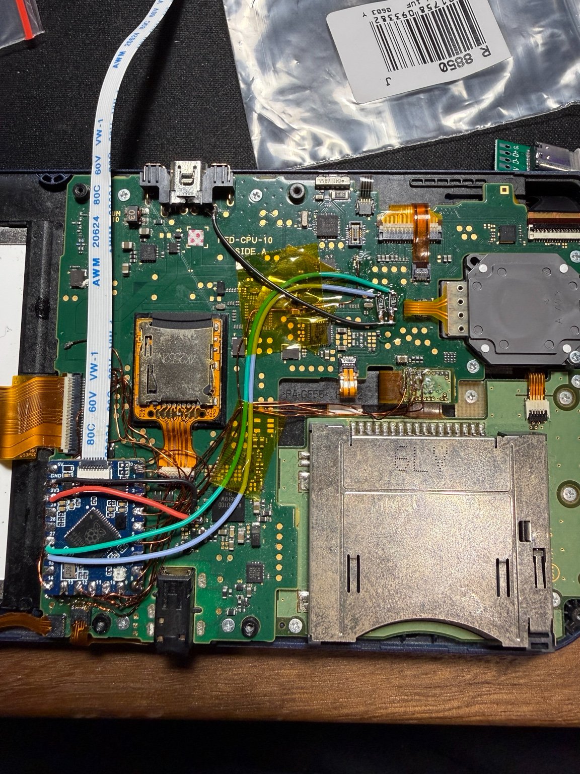

Hi guys. currently workin on something similar. im using a switch pro controller. my microcontroller is an RP2350 tiny dev which lives in the console. it interacts with a 8bitdo v2 wireless adapter for a handfree option for the console. you can also plug it into the back of the 3ds. ill be building a dock for this to. the c stick is also my last thing to map. the 2350 has proven to be a really good controller for this as the dual core 4 ADC outs work great for the circle pad so far

well my project is finished. here's a facebook link to a group i'm in 'Nintendo New 3DS / 3DS XL Repair, Restore and Resources'. check it out. feel free to reach out via facebook if you have any questions. but the at85 definitely doesnt have the grunt to pull it off. my controller mod also has use of the C stick so happy days.
you may need to search for the group as the link isn't working here
