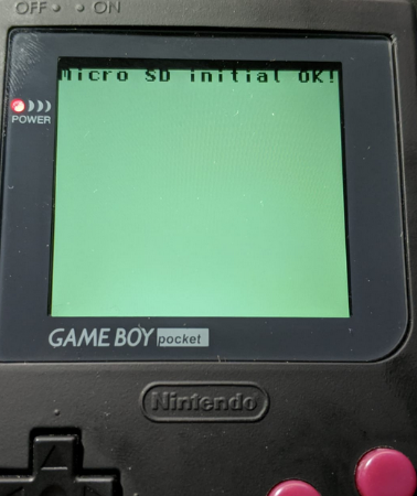

I have a problem with the cartridge, when I save and turn off the console, the message before making the backup save appear, but never the square of saving it appear and I'm forced to restart the cartridge, I have waited one hour the last time, and nothing appear :(

Hi @JMSMORIARTY , what FW-Kernel are you using? Try using a different microSD card and try to check if the issue happens with all the games and with both methods of saving (Reset button of the cartridge and Power Off-On). Also check that the Auto-Save box (in the RTC menu) is not tilted on, in order to give you the option to choose to backup or not. Cheers.

Hi ! I have tried 3 different SDCards, all SDHC Fat32 32Kb as the website suggest in a GBP and in a GBA
I'm using the firmware available in the website wich is FW4 K1.04e
It loads games perfectly, but as I said I cant go out this screen in both consoles (atached) so I cant save the current games. And yes, there is like 5 gb of free space in the SD

Power problem? Try the latest test flight a few posts up

Still the same problem... tried with pokemon yellow and Super Mario Land 2.
I will try in a DMG, but pretty sure it will the same, the cartridge have less than a day out of the box and it came in like 2 kilograms of bubble papper
If you have like 5gb of free space then you are using at least an 8gb or bigger microSD card, wich means you have like 1gb of GB-GBC games maybe? If this is the case, try with less archives in the microSD, like 5 games just to test.
If that's not the case, and the problem persist even in another console (your GBA), let's wait to see if the developer or someone else have another idea. Cheers

I really doubt thats the problem but wil try anyway...
Is this Cartridge compatible with a Funny Playing IPS ? Anyone using both ? I could think It's not, but it fails in a DMG and a GBA

Try on original hardware yep it's a power issue
Its power problem even on a backlighted DMG ? So this only works on a unmoded console ? That's should appear in the EzFlash web as info in my opinion..
The ideal way to test it is with original hardware like @Shadow#1 stated, there are known issues that some modifications can cause the EZFJr to not work properly. If you already tried all the sugesstions, then let's wait if the developer have any idea of what's happening. But if you have the access to other unmodded consoles, you should try.
