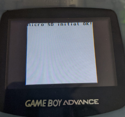

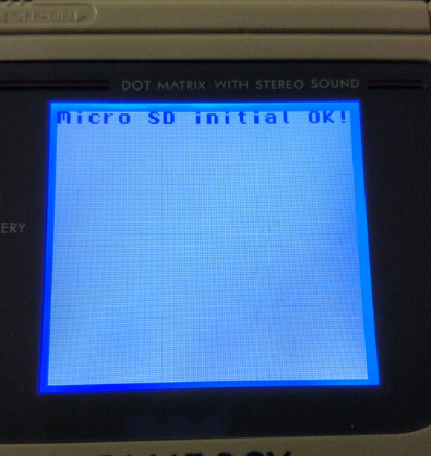

Here is working and saving on a AGS 101 GBA so I don't get what's the problem

your attachments arnt the original DMG screen as its lit up
Then remove the backlit kit and test again
Right now I'm will not put at risk a 5 years old mod, I atached a GBA 101 working perfectly.
I can give the pocket have power problems because of the IPS mod and the 4.1V limit, but the DMGobvious don't have one for 4 LED's also the video of the working GBA.
If it's really a power problem on all three (Making like the vid doesn't exist), thats a hardware issue on the cartridge wich should be checked on design.
