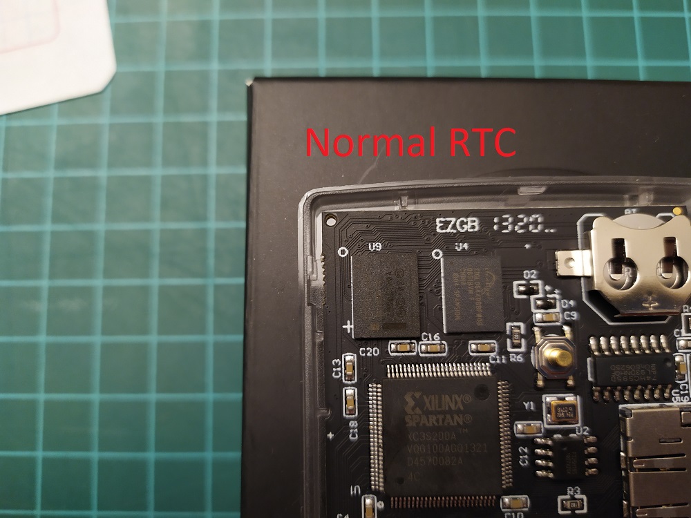

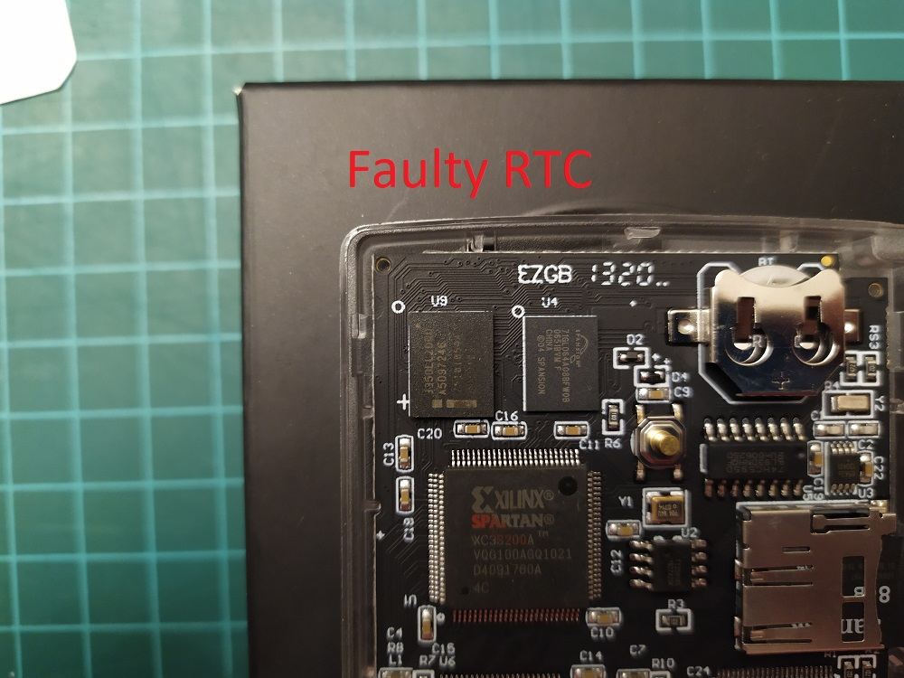

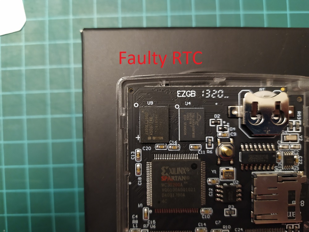

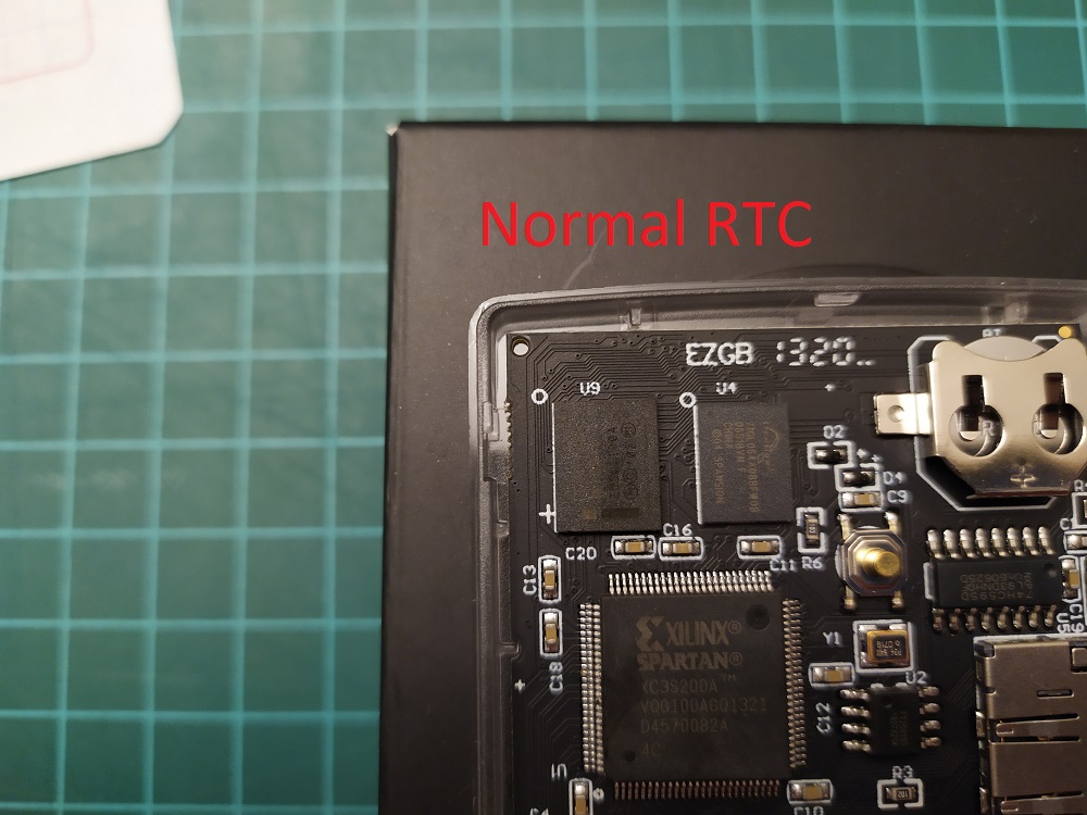

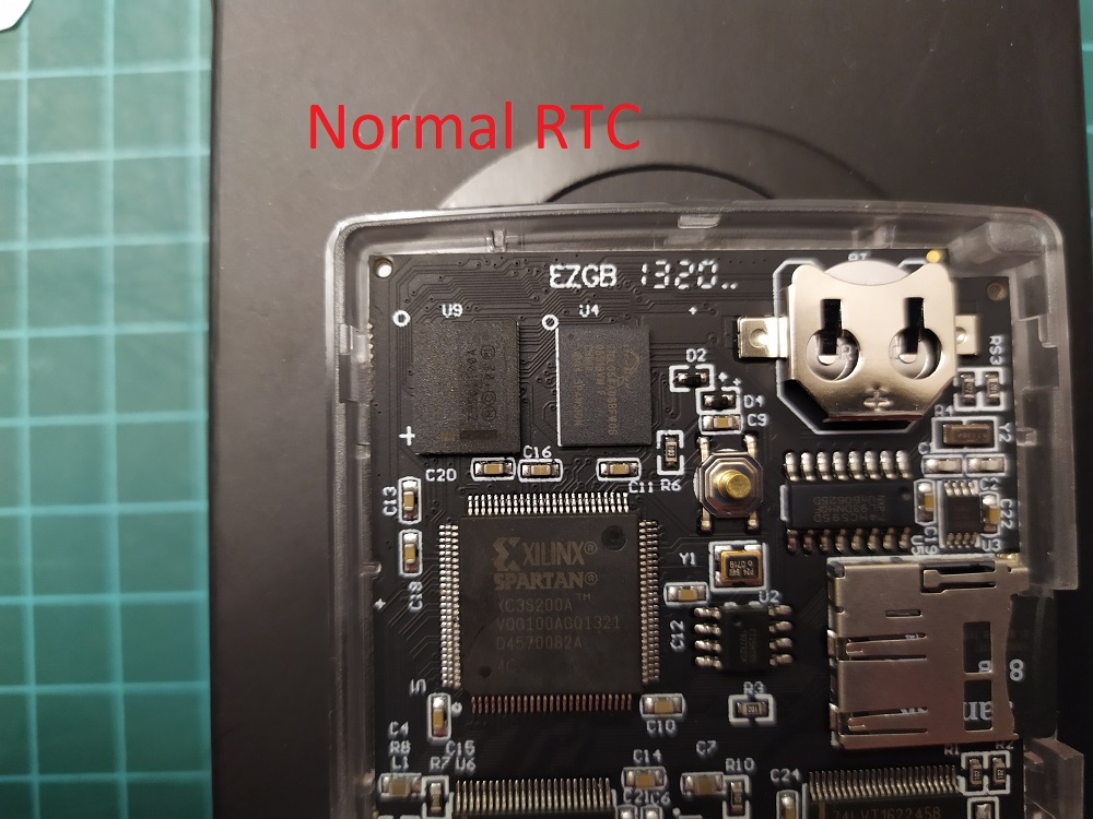

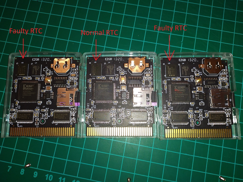

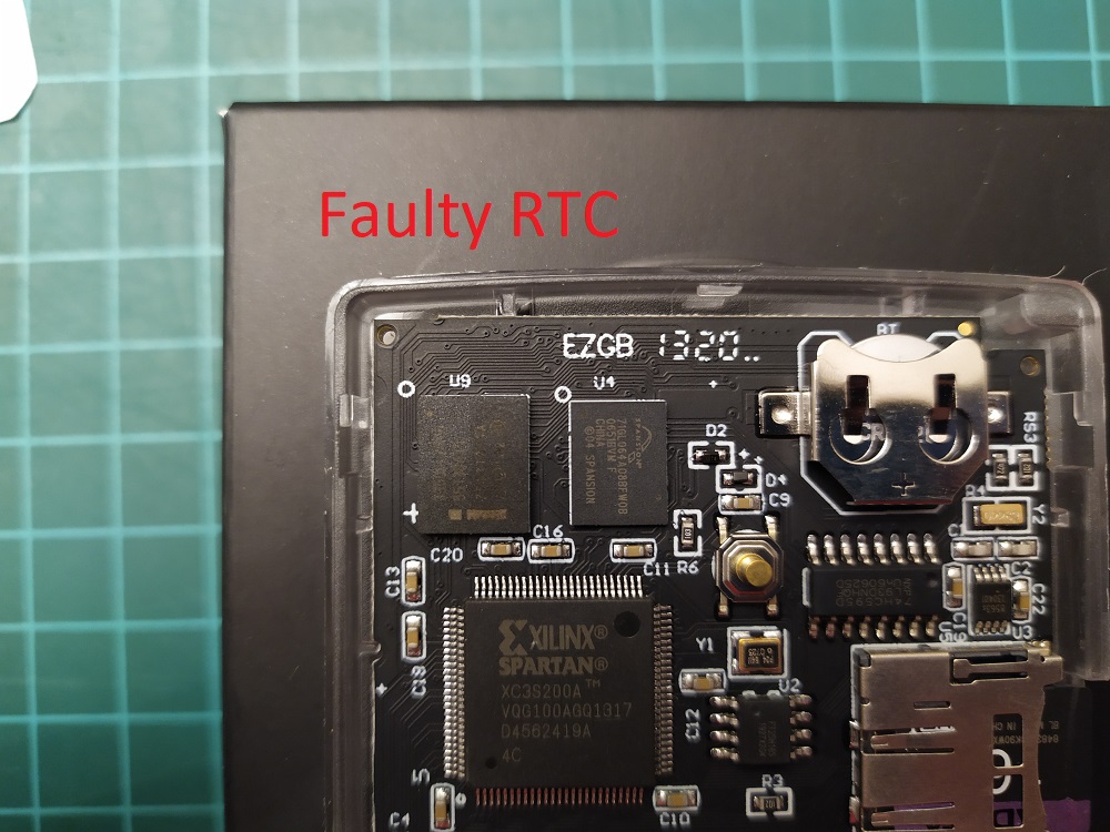

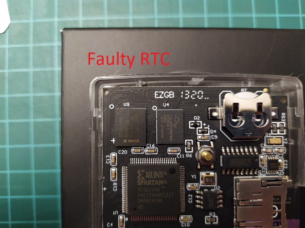

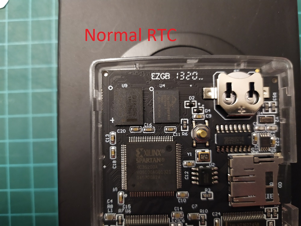

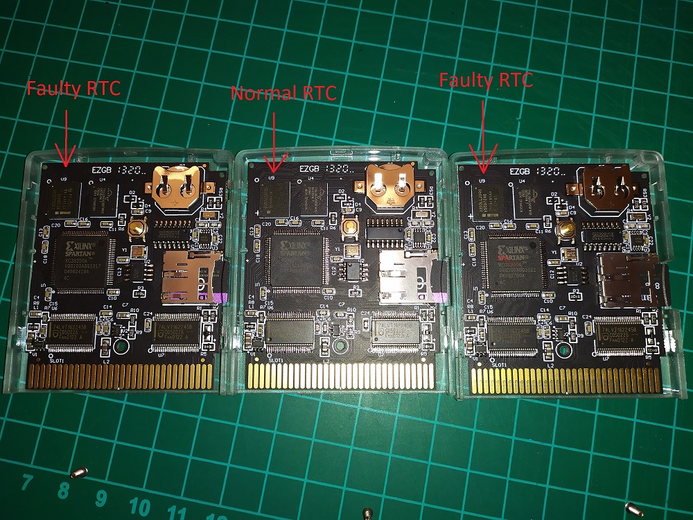

Ok, I just opened 2 cards with the RTC jump issue in FW4 K1.04e, and 2 cards working flawlessly. It is a little weird but the Chip in the upper left corner has white lettering in the two paragraphs on the faulty ones, and white lettering in the first paragraph (but very light color like if it was a little bit ereased) and black lettering in the second paragraph in the ones that are working great. But maybe its just a coincidence.

Ok, I just opened 2 cards with the RTC jump issue in FW4 K1.04e, and 2 cards working flawlessly. It is a little weird but the Chip in the upper left corner has white lettering in the two paragraphs on the faulty ones, and white lettering in the first paragraph (but very light color like if it was a little bit ereased) and black lettering in the second paragraph in the ones that are working great. Maybe its just a coincidence.
View attachment 215571 View attachment 215572 View attachment 215573 View attachment 215574 View attachment 215575
In fact, you can see through the translucent shell if the text is completely white or the dark one from the outside without opening it. @limpbiz411 can you confirm me if you can see this chip with all the lettering in white?. Thanks in advance.

Conspiracy? Really? Of course there is no conspiracy, it's just a flash card mate. I'm pretty sure that it is an issue with different supliers of components that can be solved by software. I just tested and posted all this stuff because I never got a clear answer from you if this is the case or these cards are defective. Thats all.
Sorry if I offended you, it was not the intention. Cheers. And as always, thanks for the hard work.
