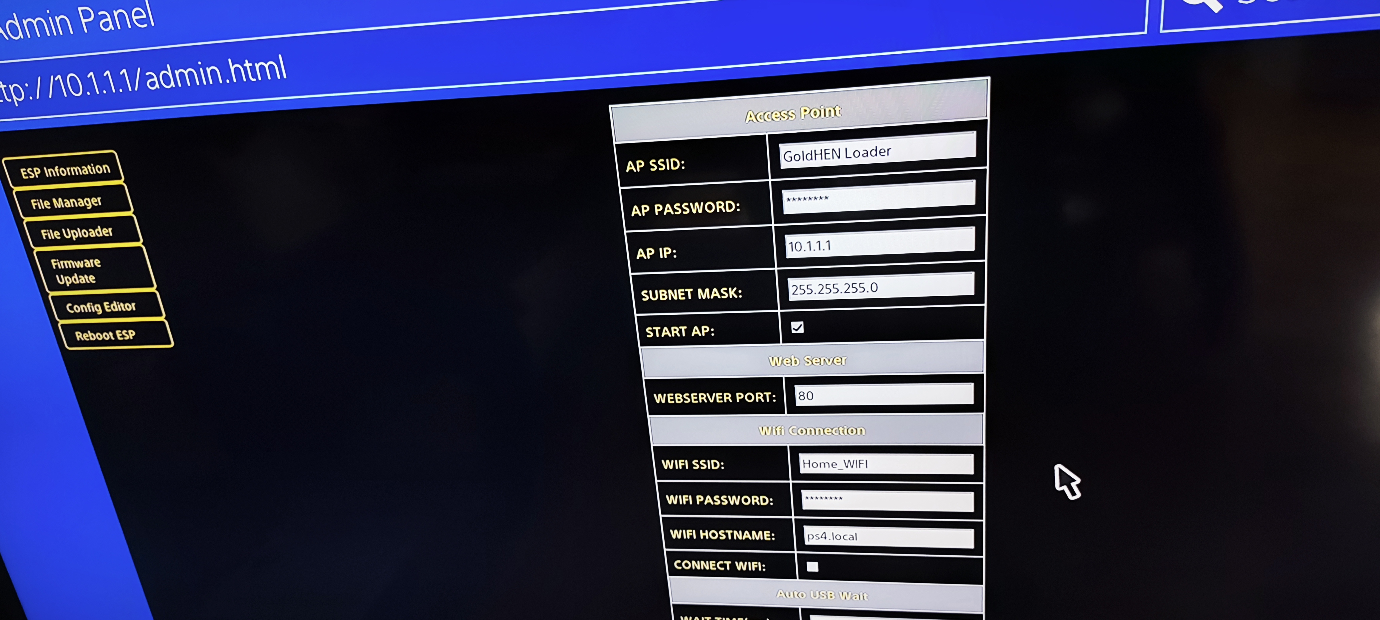

Hello, didn't want to open new thread so I will borrow this.
I'm trying to get online with my PS4 jailbroken with ESP32-S2 chip. When I connect to chips wifi and JB it works great but Im offline. I don't know how to get online.
Admin panel of ESP32-S2 chip (in the photo) says WIFI SSID and password. I entered my home wifi name and password, so what I have to do next. How do I configure Network settings in PS4 to get online or this isn't possible.
Thanks kind people
Thanks kind people
You can't set up the chip as an access point if you want to go online. You need to set the chip up so it connects to your home network, your router will assign it an IP address. You can connect to the chips webpage by going to the IP that your router assigned it, then you can go online with your ps4.
