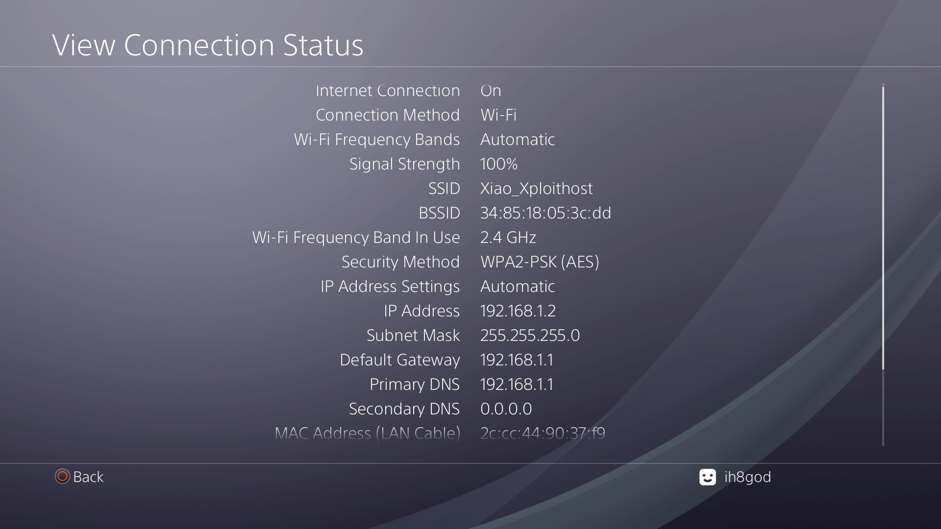

04 - On the PS4, set up a network connection and do the easy way and automatic everything. Run the test if you want when done and it should get an IP address and fail internet test.

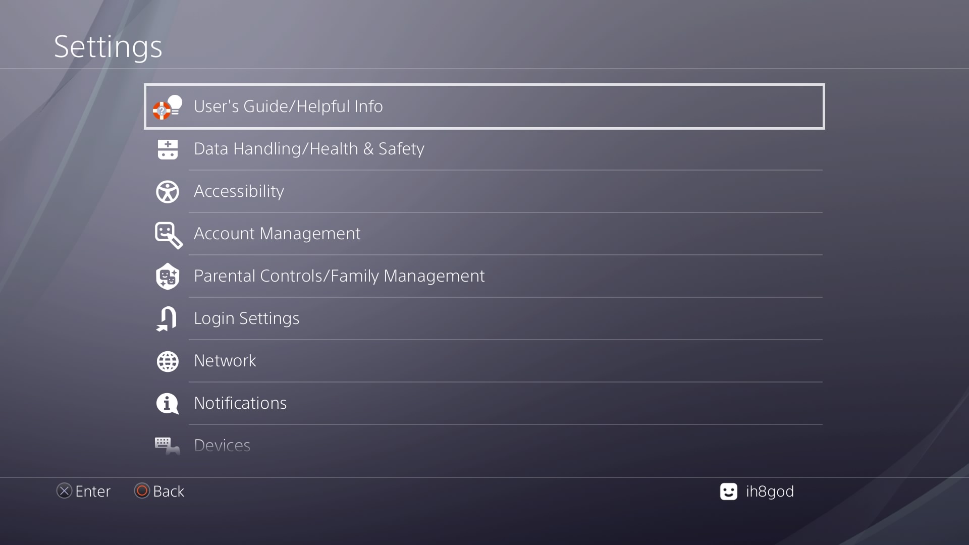

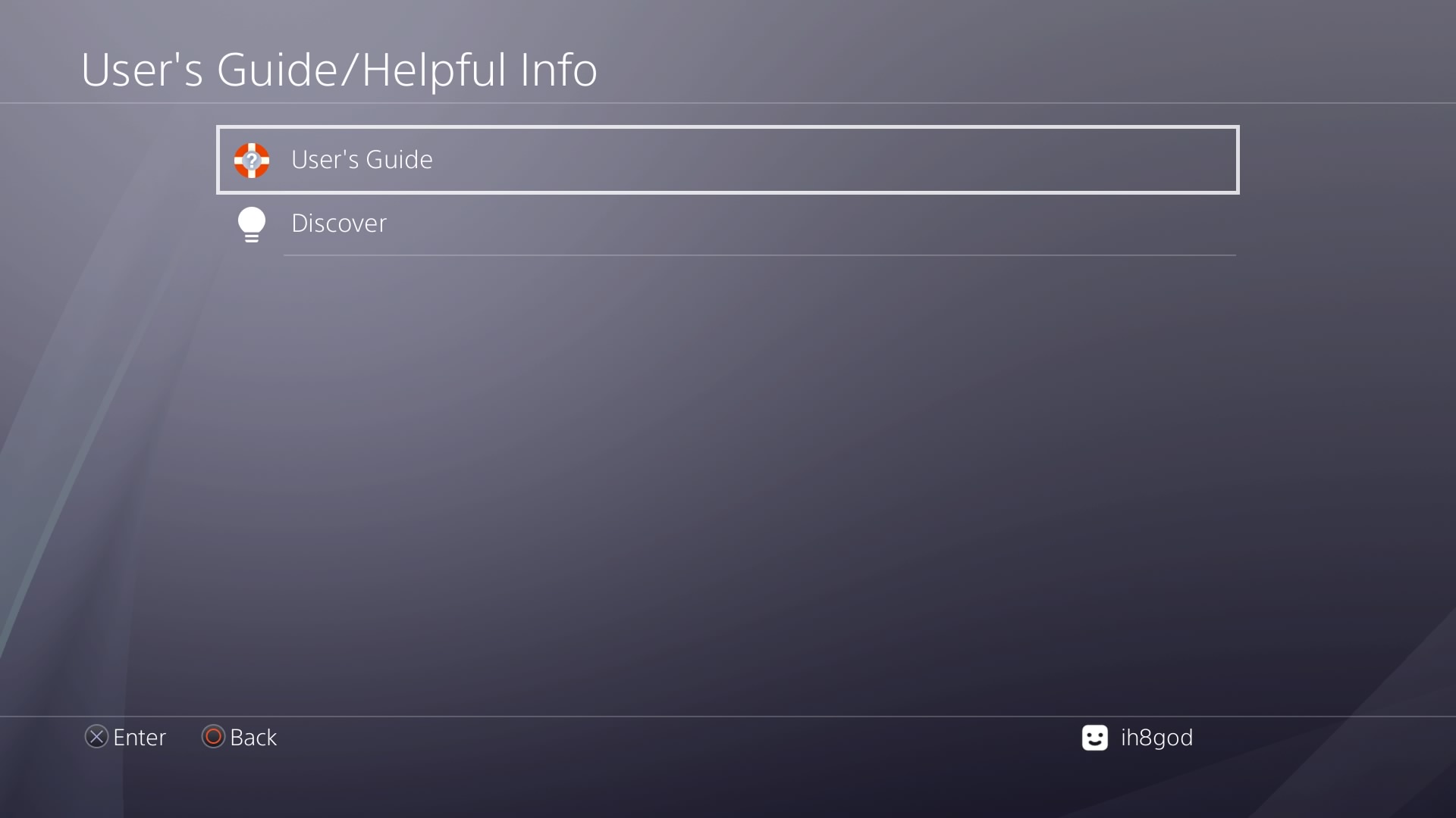

05 - Back out to Settings. Scroll way up to the top and pick User's Guide/helpful Info
06 - Pick User's Guide again.

SSID: Xiao_Xploithost
Pass: password
You shouldn't need to type any web address into any bar. 100% offline. Never connects to the internet.

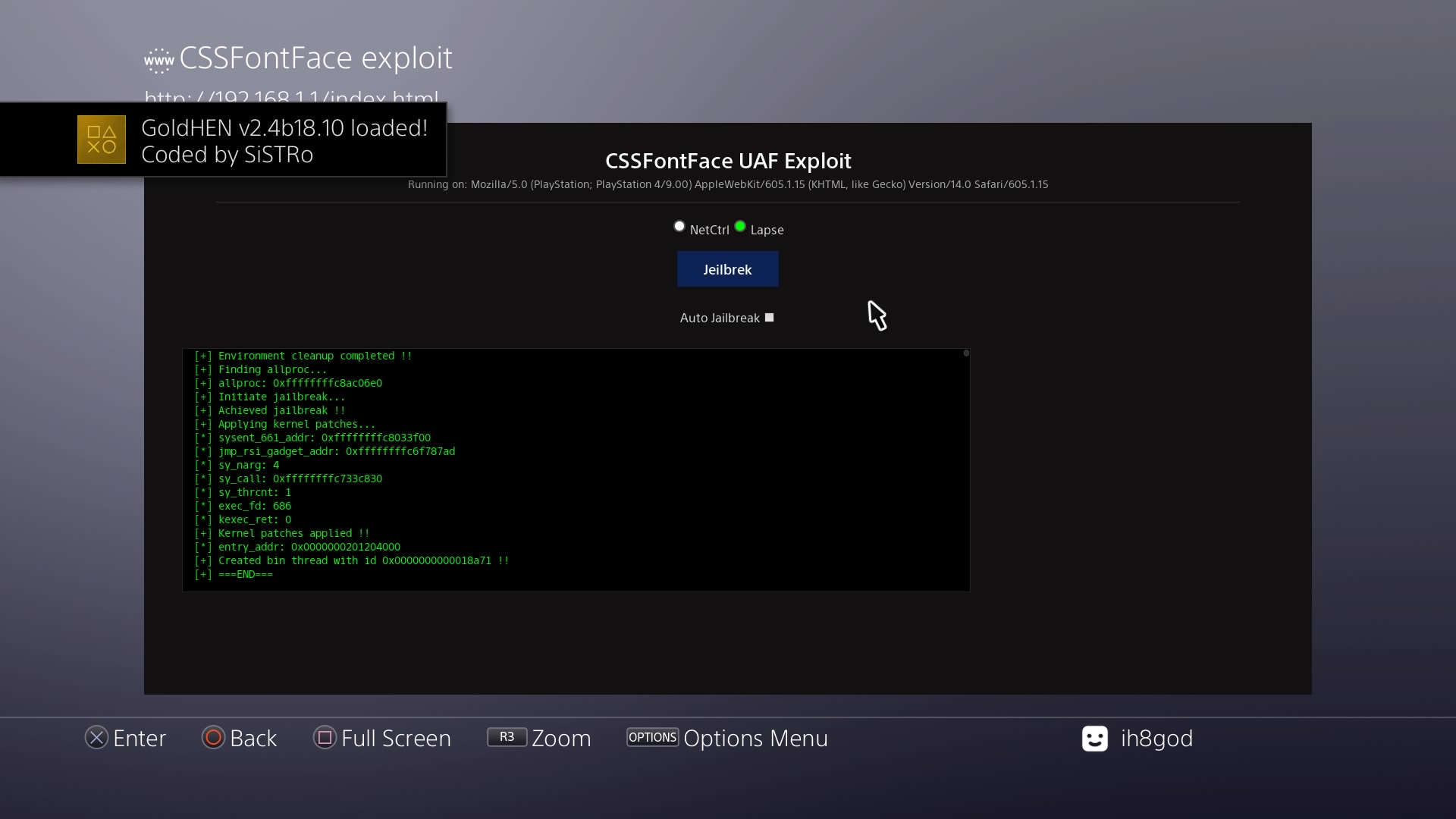

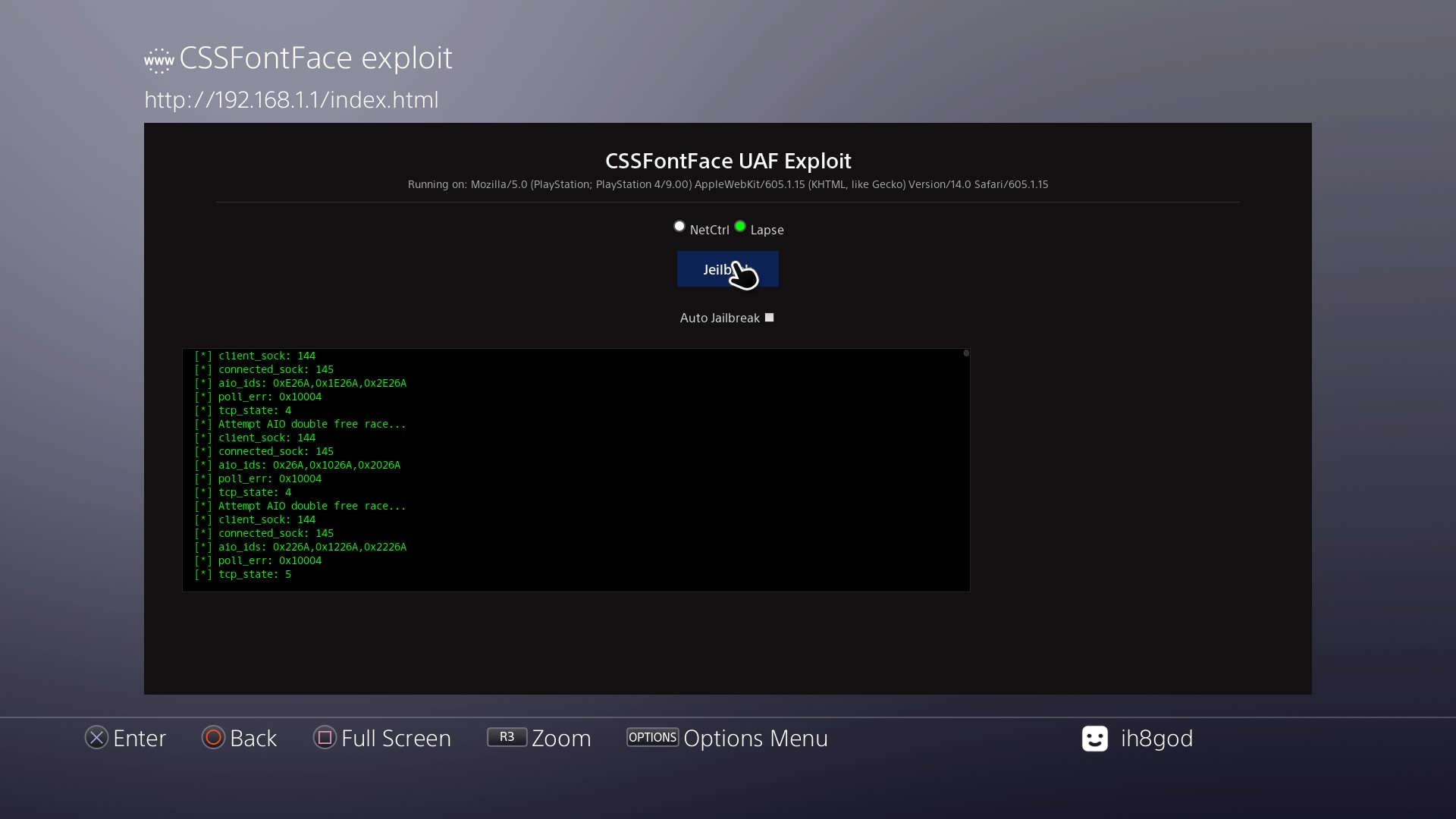

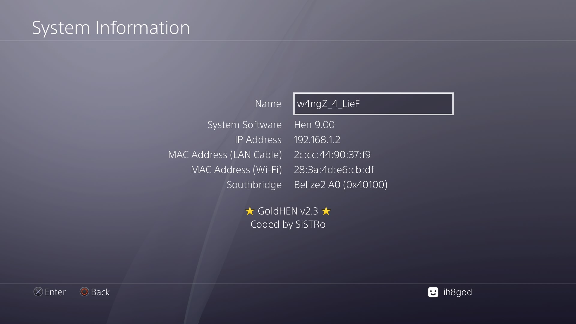

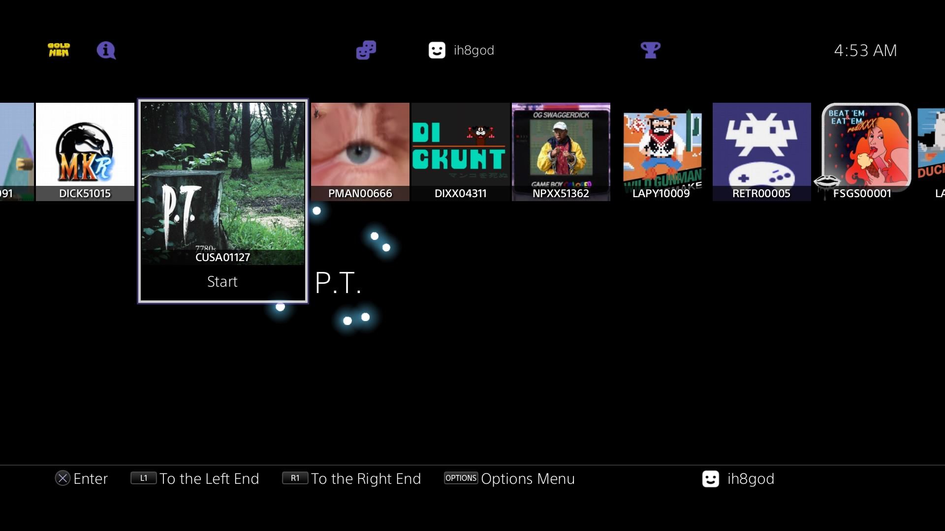

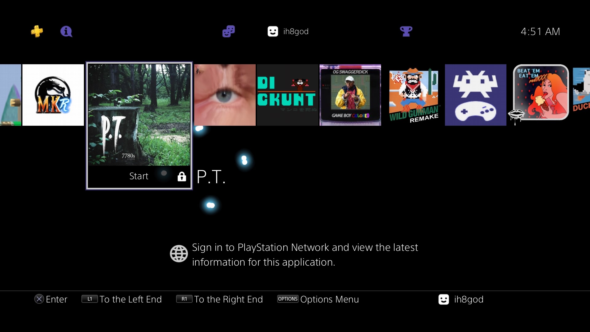

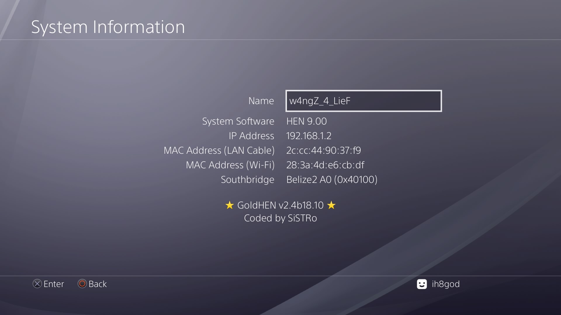

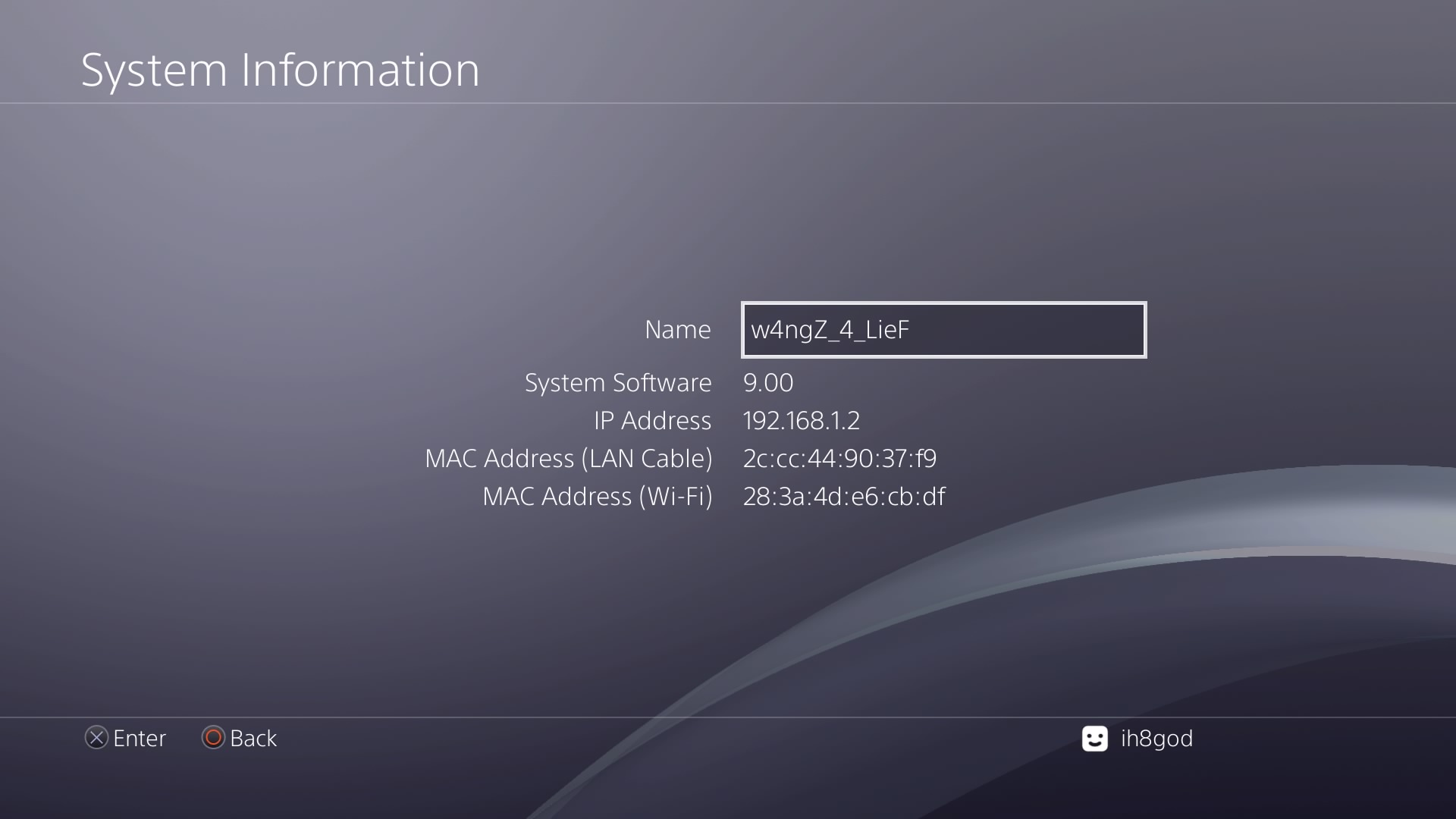

Also, here are some screenshots to show the basics of things. Just like being jailed and the user guide section running the page, being unjailed and the only firmware and console I tested on. Sorry if I missed anything but if so, let me know.
On FW9.00 and with Goldhen 2.3
On FW9.00 and with Goldhen 2.4b18.10

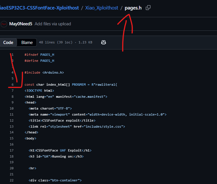

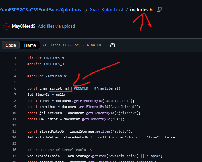

Thanks but that does not allow me to edit anything. I need the folder not just the h files. Arduino converts the files to h no? I forget. Have not worked with Arduino in a while.
The pages.h has the index.html in it. You can edit it there.
The includes.h has script.js and style.css right here and here.
The manifest.h is the cache.manifest which is easily editable as well.

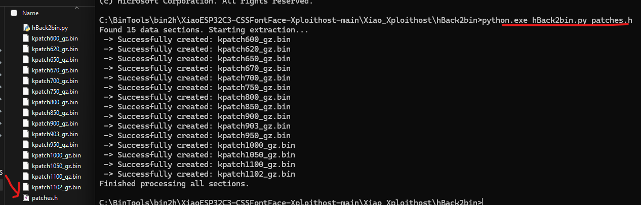

You can take those and edit them as usually like and webpage would be. As for Arduino, The .ino file is the project file and the folder is the sketch project. The gzipped payload.bin.gz if Goldhen and it will be uploaded to the board from the location it is in with the other files in the project.
If you want to decompress and convert the .h files that are not human readable, I have attached a file here called "hBack2bin.zip" with a python script in it which is the same deal as stooged's bin2h script but will turn h back to bin. Each file within a .h will be output as they are in the .h file with .bin so you will have to manually rename the output if it doesn't line up with original filenames or the manifest and whatever.
Examples with the patches.h file and below is showing how the script.js pulls out of the src.h files.
Hope there is some help for ya in there somewhere though. If you just want to change how the webpage looks for the thing, you should be able to pretty easily with it there as it is though within the readable stuff.
Let me know if you're stuck or something.

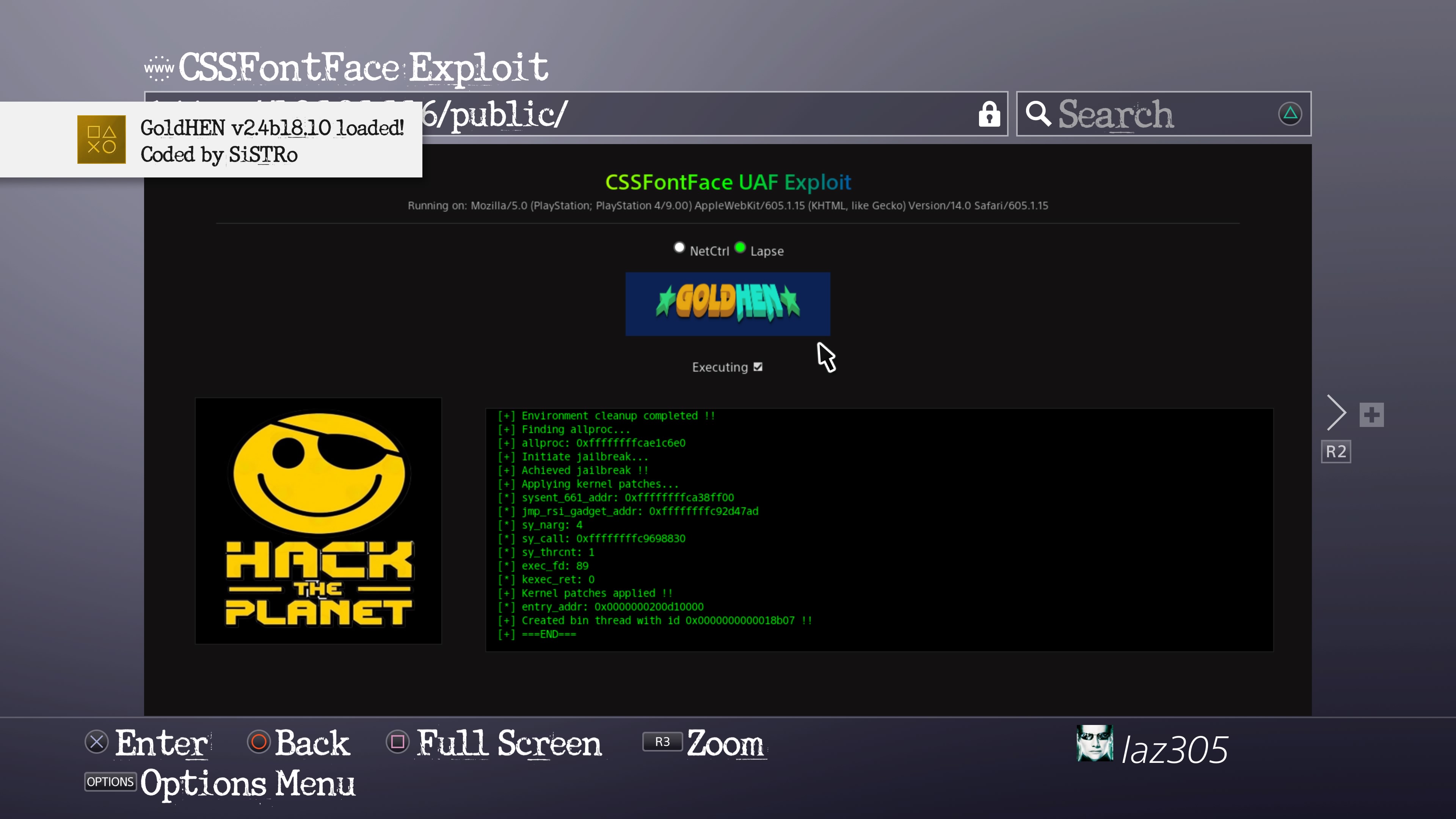

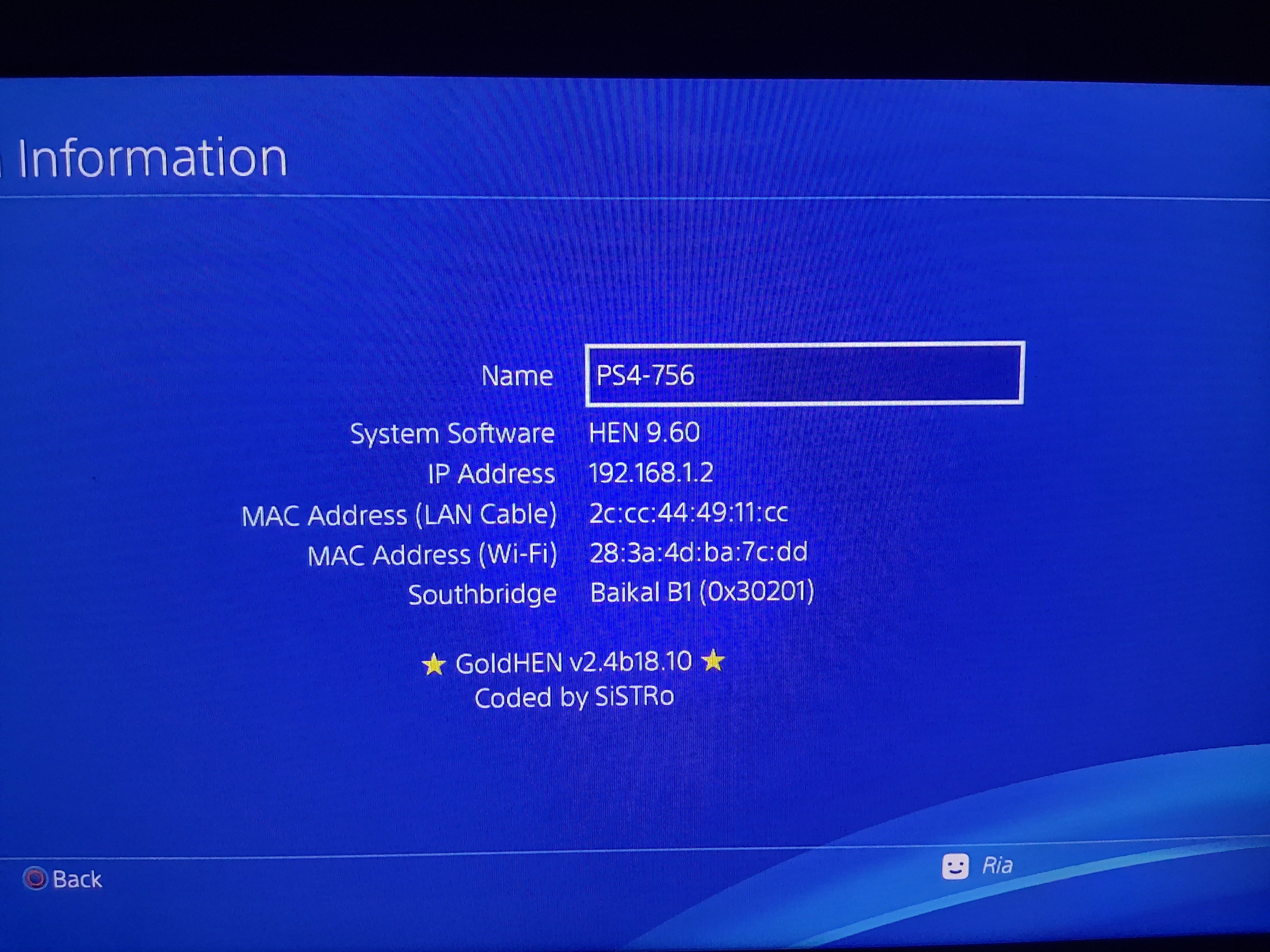

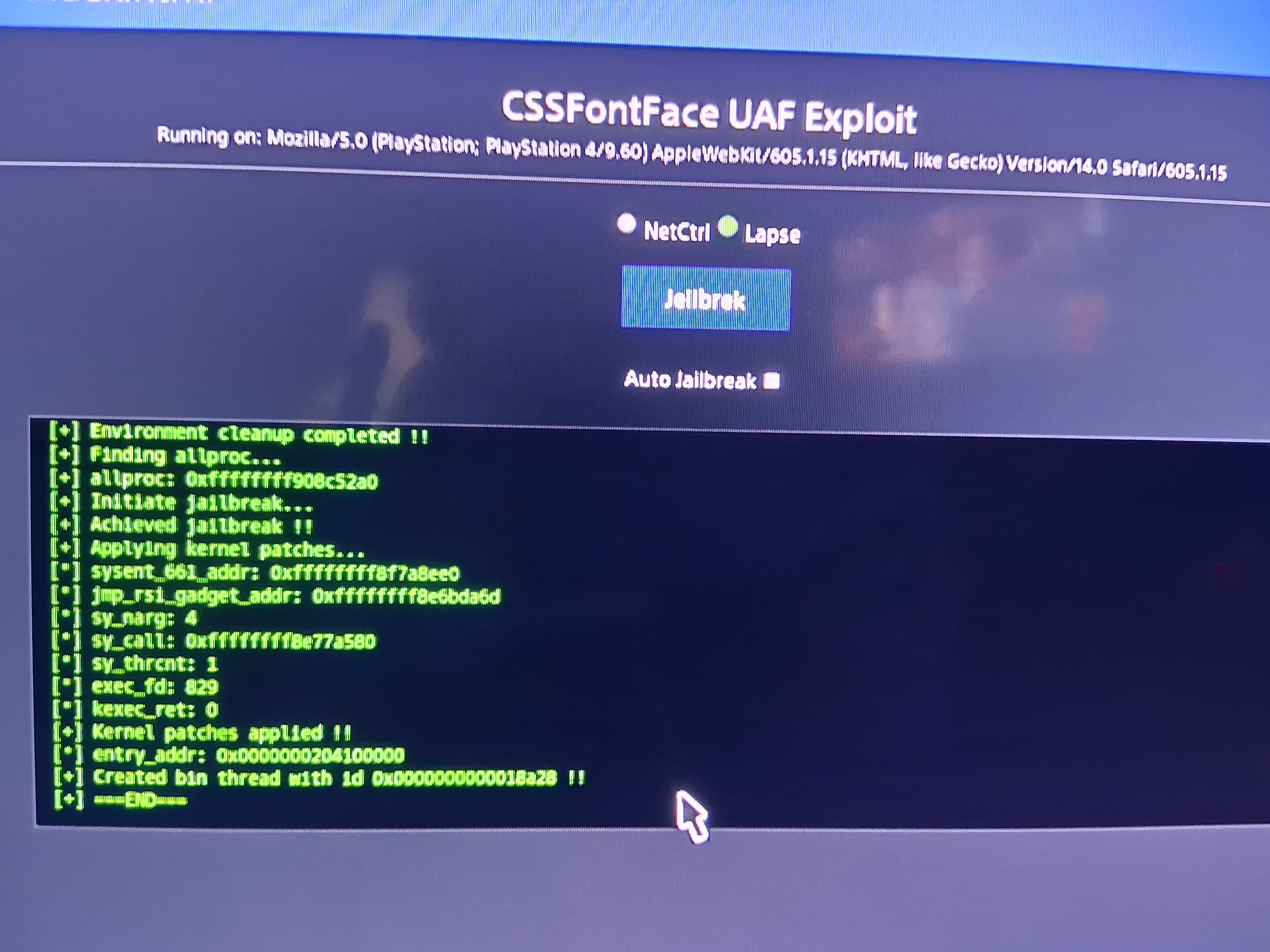

View attachment 589050View attachment 589051 Tested on FW 9.60 using GoldHen2.4b18.10.
