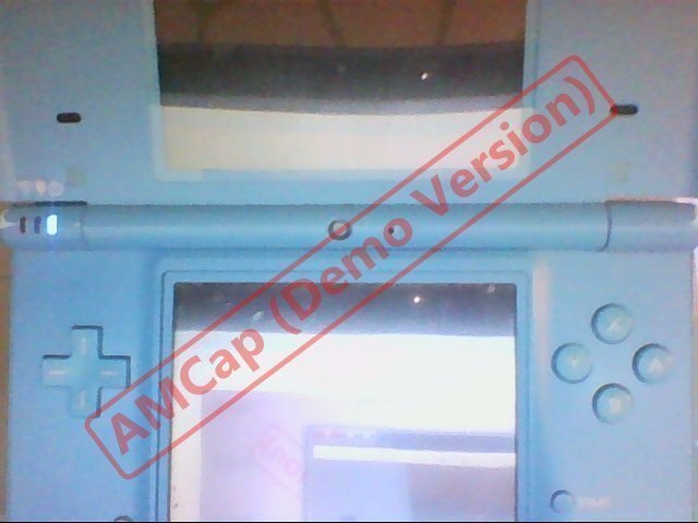

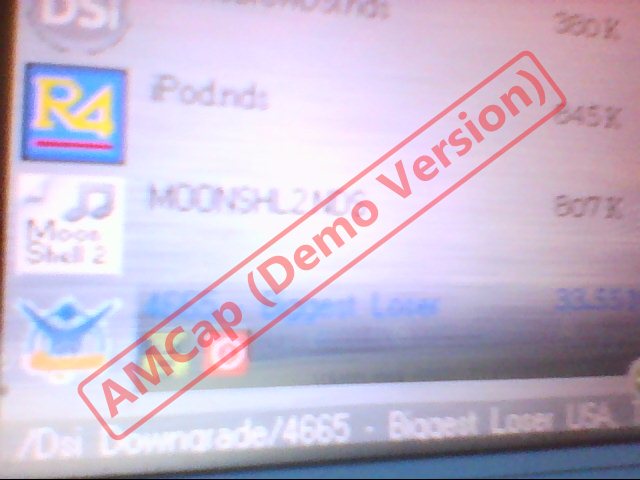

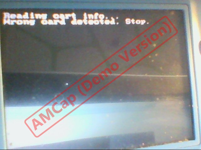

I downloaded no $ gba and the biggest loser from the internet, I started with the .SAV located in the package (CID DUMPER) and there were lots of zeros on the emulator, I have tried to do it with the dsi r4 but c 'it was a black screen 2016-06-25_120027_738.jpg 2016-06-25_120212_418.jpg . If I try to open TB_loser_inject_EU.nds says Reading cart info ... Wrong card detected.Stop. 2016-06-25_121021_842.jpg Please help me, I would try modding of dsi. However, you can change the icons on dsi home or change the tune. Sorry for the bad english (google translator) Thank you all.

I downloaded no $ gba and the biggest loser from the internet, I started with the .SAV located in the package (CID DUMPER) and there were lots of zeros on the emulator, I have tried to do it with the dsi r4 but c 'it was a black screenView attachment 54112 View attachment 54113 . If I try to open TB_loser_inject_EU.nds says Reading cart info ... Wrong card detected.Stop. View attachment 54114 Please help me, I would try modding of dsi. However, you can change the icons on dsi home or change the tune. Sorry for the bad english (google translator) Thank you all.
It does not work with the ROM on a DS flashcard. You need the actual Biggest Loser game card with the save payload installed.

You need a retail copy of the DSi-enhanced game "The Biggest Loser". You can not use an R4, or other DS Flash Cart, to run a backup of that game. The exploit is meant to run in DSi-mode. DS Flash Carts only run in DS-mode. Therefore, you can not use a DS Flash Cart to run the exploit.
