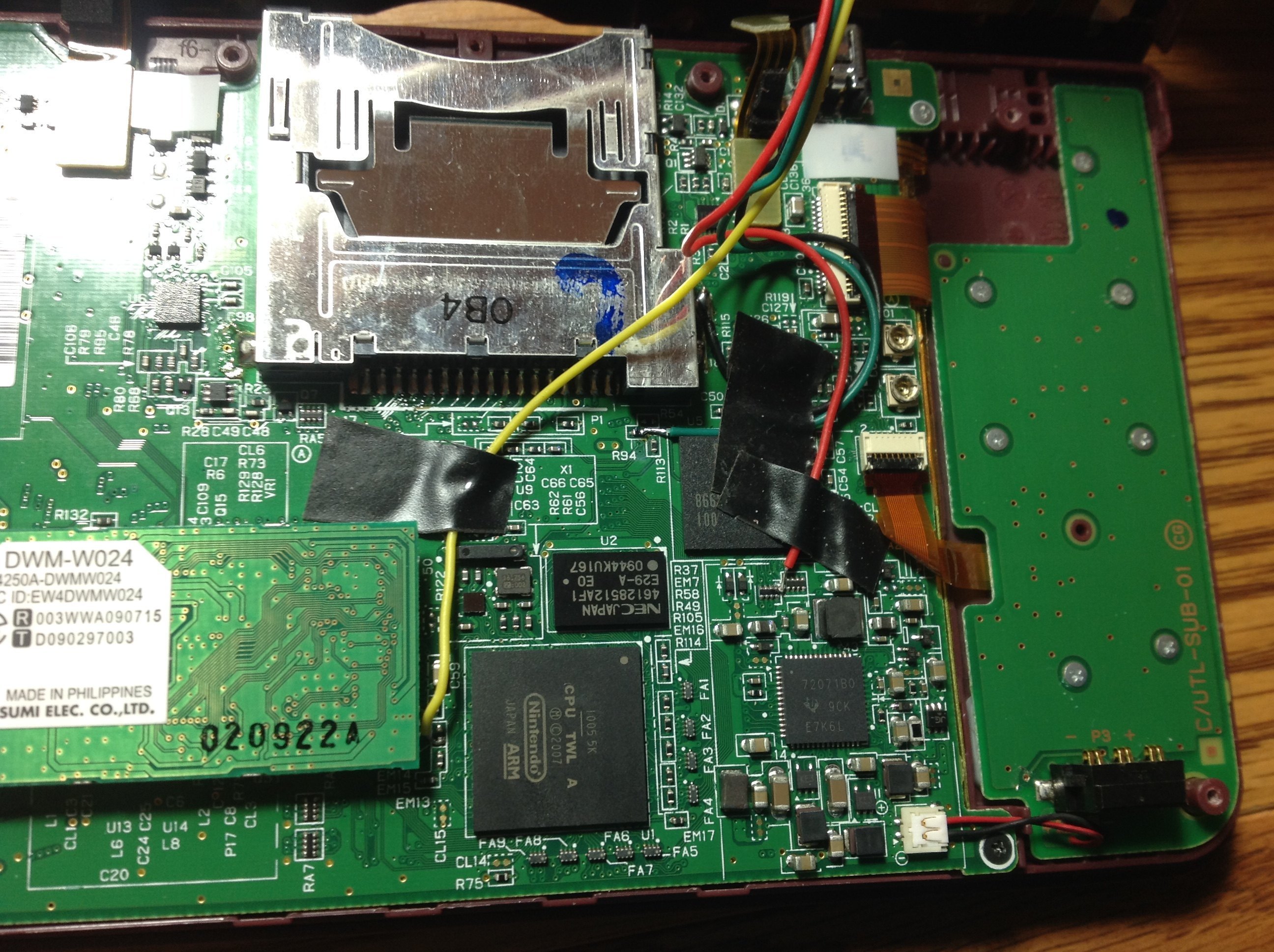

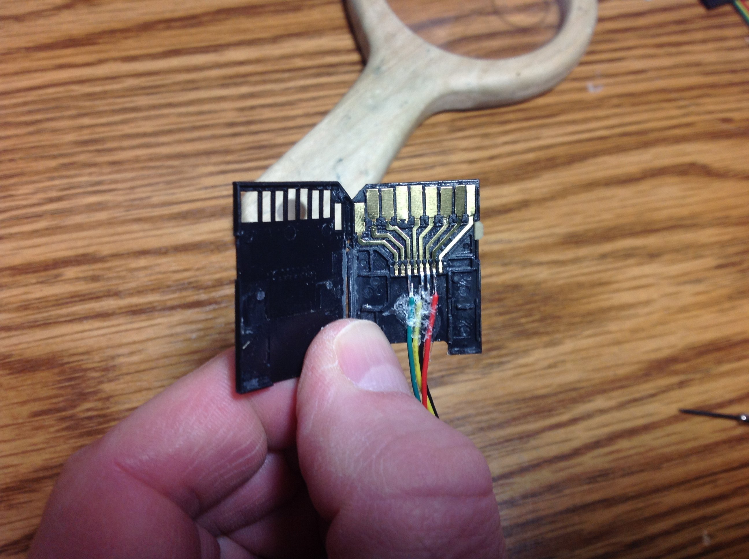

I cannot get the computer that I am using to detect my DSi XL. I had an invalid geometry error at first, later had a CRC error, and now it does not detect my DSi XL at all when it is inserted and then booted to the bootrom screen. Here is my current setup:
I also set up this other mod for enabling game backup and save data backup/restore apps. Could this somehow be causing a problem?
Could it also be the computer's SD card slot? I do not know how to tell whether or not it supports reading eMMC chips running in single data-line mode.
