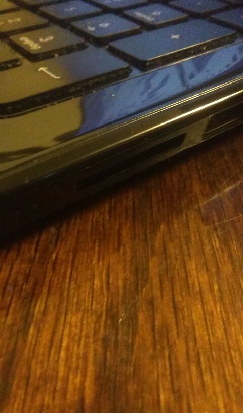

View attachment 95847 this is my notebook SD reader
do you think this would work with hardmod?
You'll need a microSD to SD adapter. But not all are compatible.
