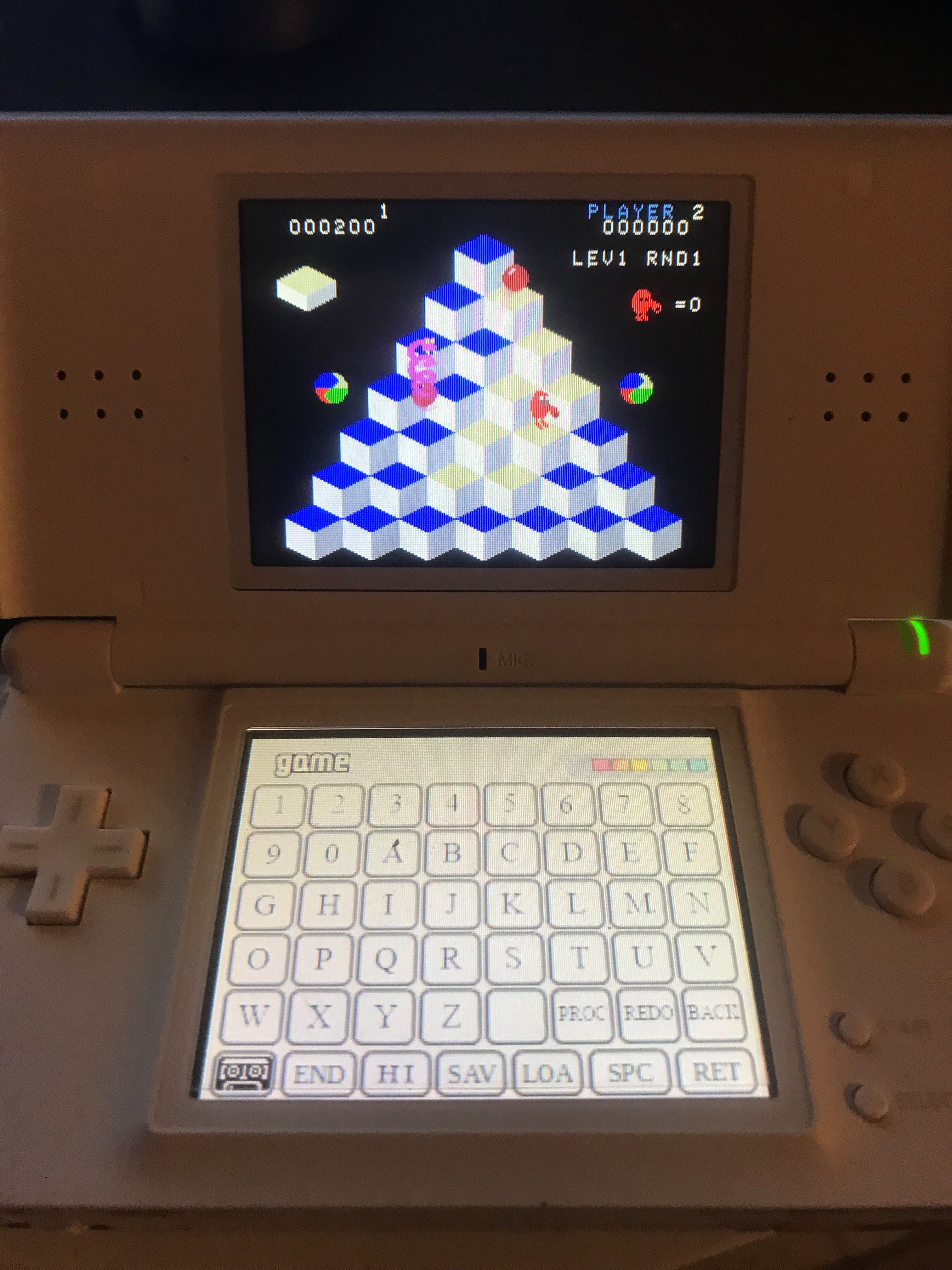

So... I worked my ass off over the holidays to bring this to life. It's still has a long ways to go - and for a while, I didn't think it would work. Was super frustrated hour after hour of not seeing anything but black and white line on my screen...
And then this happened!
And there was much rejoicing!
Only 33 frames per second on simple games... but you know that's where my shit goes all kung-fu and I'll have it running at 60+ in no time :)

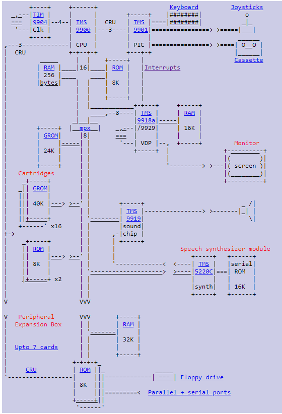

So the TI disguises the names of the chips... but the Video Chip is the venerable 9918 used in Colecovision/MSX and the sound chip is really the SN76489 also used in the Colecovision.
So it's really the CPU (TMS9900) that is all-new plus the IO chip (TMS9901) memory map... plus this god-awful hardware design that tries to cobble an 8-bit bus onto a 16-bit bus via a multiplexer. That's what screwed me hard for almost 20 hours.

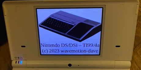

Version 0.3 is available: https://github.com/wavemotion-dave/DS994a
V0.3: 7-Jan-2023 by wavemotion-dave
  • Improved speed 8% across the board
  • Fixed spirte cut-off at top of screen
  • Fixed X in control mapping so that it toggles P1 vs P2
  • Added PAL (along with default NTSC) support
  • New splash screen and logo
  • Other minor cleanups as time permitted

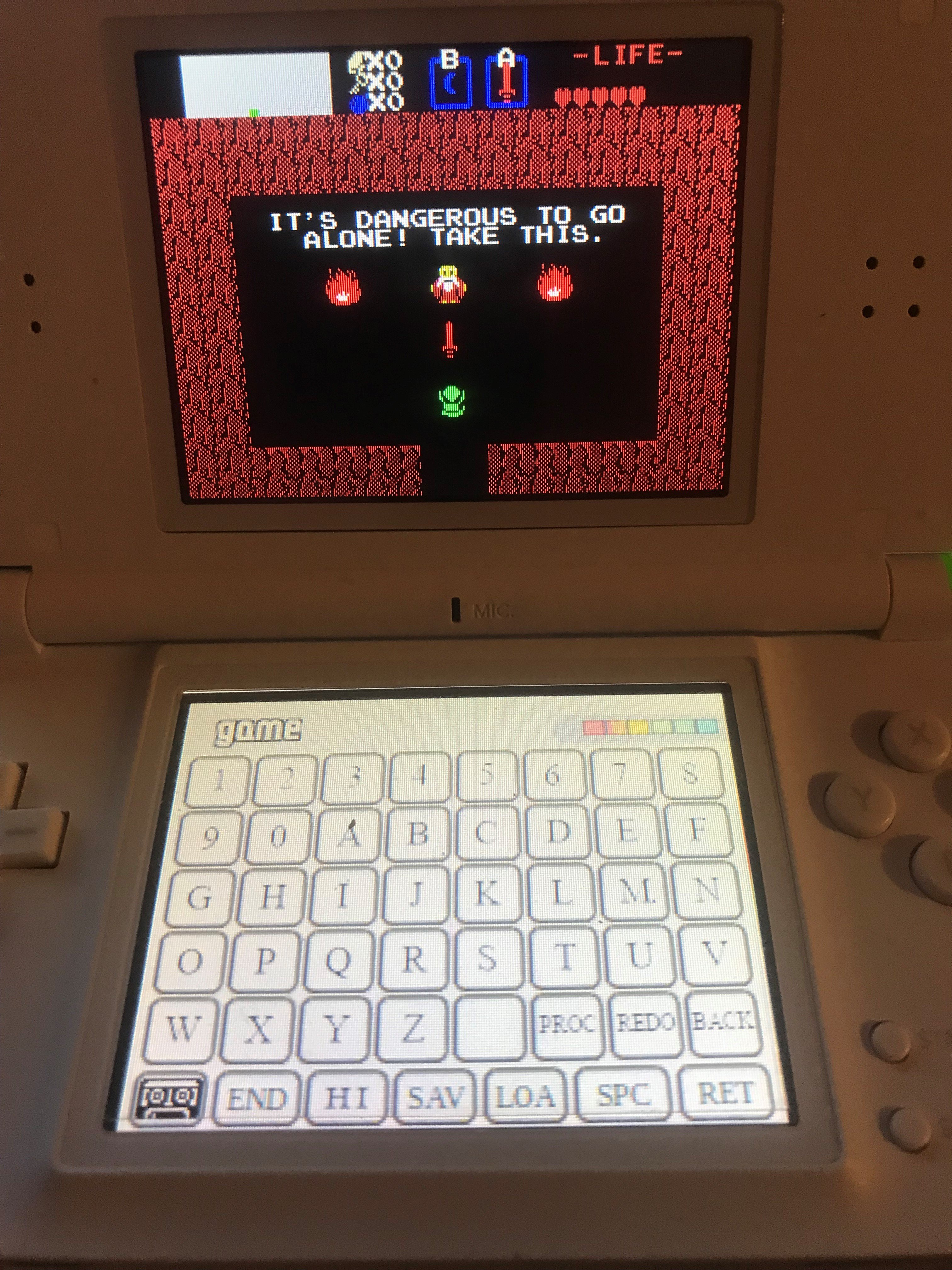

I tested some games on my DS-lite and it is already working great, most of them run at 60fps with FS :toot:
I deleted my romset taken from that "archive" site because many modules I tried did not work. I found something else with the right extension and they all worked but it is incomplete. For example I cannot say if Q*Bert works or not as it is missing in the last romset I found and it is not working with the 1st one :wacko:.
I wil investigate a little more :)

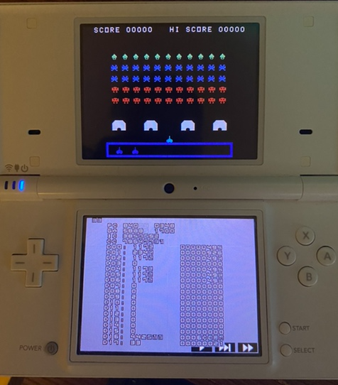

I tested V0.4a (DSLite) with speed improvements and this emulator is working really great. Whithout frame skip many games run @60 fps and demanding games are around 50 fps !
Are there any exclusive games on floppy disks or they were used mainly for productivity softwares ?
To be honest, TI-99 is a nice system, I was expecting something old and dusty but it is not (well, it is but it is not :)).
Again, Good job Dave, good job !
