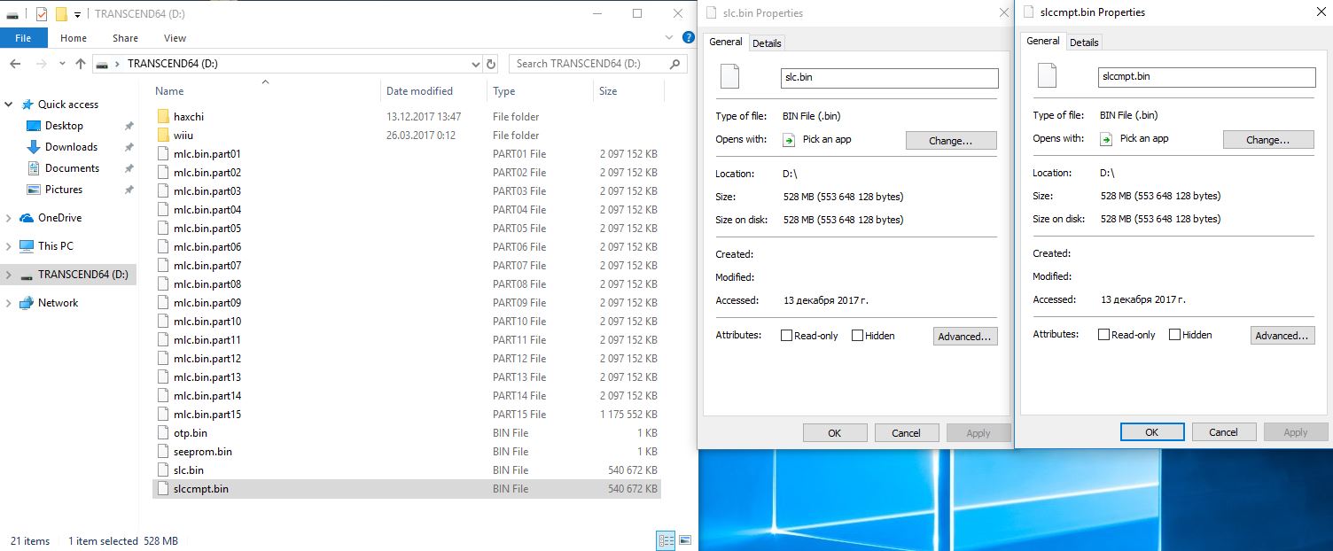

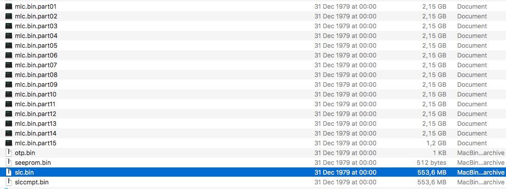

  1. Download Wii U Nand Dumper (latest is "Wii U NAND Dumper v0.3")
  2. Copy the extracted files to the root of your SD card using your computer overwriting and merging when prompted
  3. Launch HomeBrew Launcher by using HaxChi or BrowserHax
  4. Launch Wii U Nand Dumper from HBL (it doesn't have an icon. Just white on black text)
  5. Change all options to "yes"
  6. Press A to start dumping. The screen will go white and then you will see Wii U logo on the screen and nand backup process on the GamePad
  7. I have a 32GB Black Wii U and the total folder size with all files dumped inside is 29.1GB
  8. For my 32GB Wii U it took roughly 3.5 hours to fully dump to my SD
  9. Copy the backed up files on your SD over to your computer. You can find the files here: SD:\otp.bin (and other bin files)
Keep your nand tools and nand backup somewhere safe in case you mess something up and need to do a nand restore using a hardmod
If you do need to perform a sysNAND repair, you will need to purchase a Teensy++ 2.0 and follow the steps in this thread to repair.
Explanation of all the files backed up (thanks @Felek666)
Explaining SLC, SLCMTTP, OTP, SEEPROM and MLC and importance of OTP
SLC - Includes system configuration such as system.xml, sysmenu.xml and other critical parts of the Wii U (such as boot1)
SLCMTTP - vWii IOS'es, Save files and vWii stuff is stored there. Needed in-case if you screw up vWii to that state that even FTPiiU will not help.
MLC - Includes System Apps such as Wii U Menu, System Settings, Wii U Browser etc. It also includes your installed games, saves and (partial, most of it is stored in SLC) Wii U configuration. I really suggest dumping it in-case if your Wii U menu refuses to work one day. [Keep in mind: Wii U menu is needed to boot Wii U]
OTP - [Quote from WiiUBrew] "The One Time Programmable memory is programmed sometime during the factory process and can never be changed afterwards. The Wii U's OTP is much larger than the Wii's (1KB split across 8 banks of 128 bytes each) and contains an assortment of read-only data, including the console's encryption/decryption keys."
In other words, you need it to decrypt SLC, SLCMTTP and MLC. Keep it mind, you can't decrypt boot1 with it.
SEEPROM - Serial EEPROM, Includes console information, boot parameters and other stuff. It includes some calls to SLC so i guess it might come in-handy when fixing your Wii U.

Hey guys. Please help in one question. Yesterday I used Nand Dumper and got the files of the next size (attached picture).
However, in the context of rebuilding the console from the brick, everyone gets files of a different size than mine.
The slc.bin (WiiU NAND) should be 528MB (540,672KB)
The slccmpt.bin (vWii NAND) should be 528MB (540,672KB)
The mlc.bin (Storage NAND) should be 29.7GB (31,162,368KB) (Toshiba eMMC chip inside) or 29.1.GB for the Samsung eMMC chip inside.
Do I need to dump again?
Does it make sense to me to worry about this?
Best regards, Dmitry

the dumps you had originally is what happens if you use the old dumper (the one for redNAND). I think what happened to you, with the new dumper, was a glitch.
