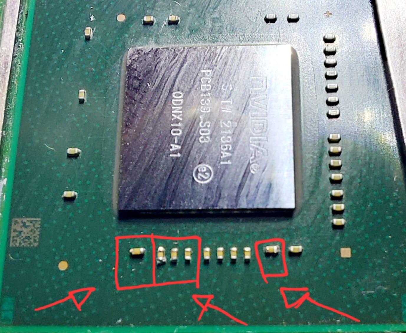

Anyone know the value of the five capcitors marked below ?

I know that the ones located where you install the hwfly cpu flex are 1uF 20% 6.3V 0201
After a little research they're all the same apparently.
1uF 20% 6.3V 0201

Uow, sounds good! Tks
