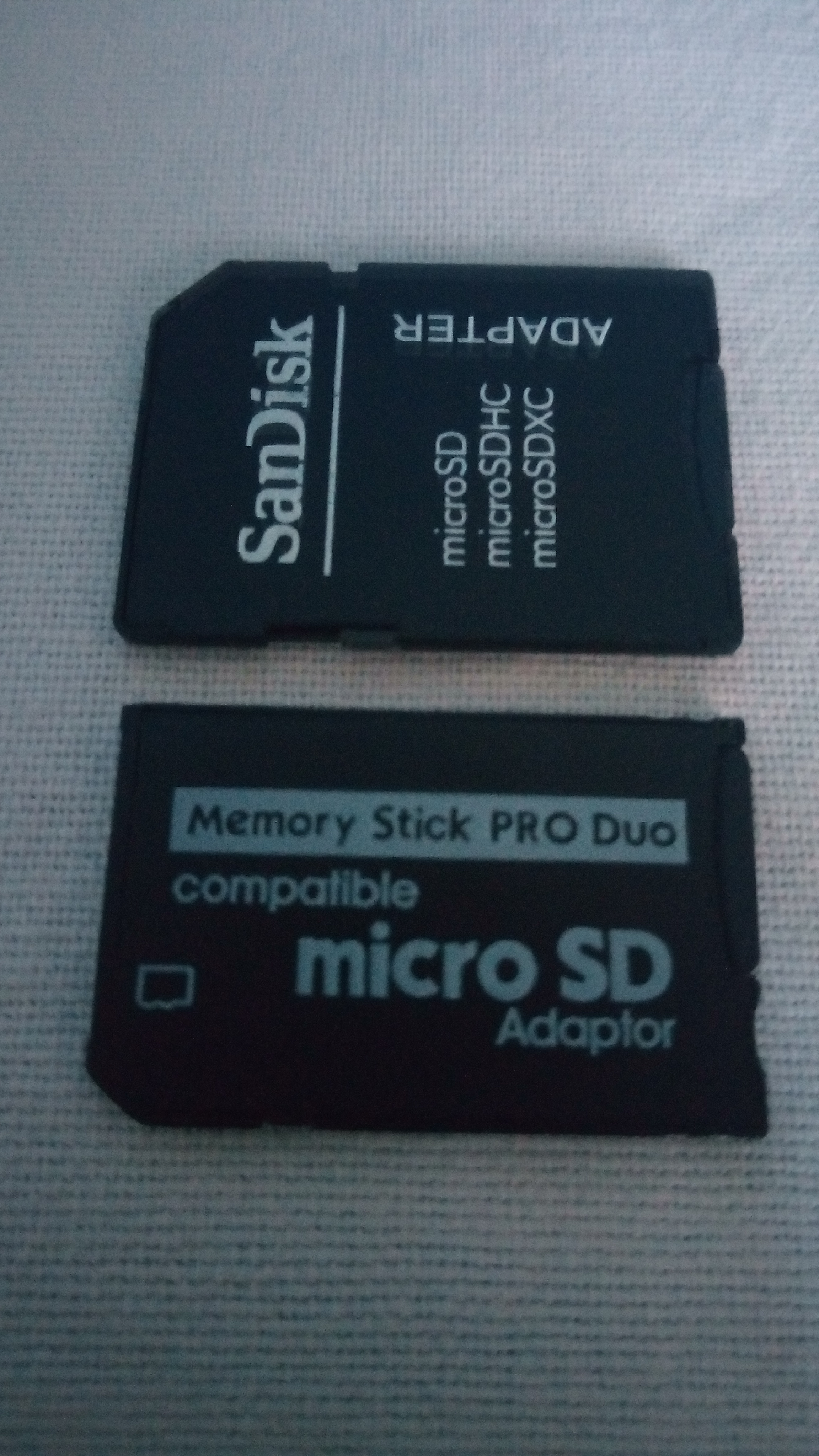

1) Can the PC detect and read the micro SD (outside the PSP) via normal card Reader?
2) What kind of adapter do you use between PSP and micro SD? Perhaps an MS Pro Duo, which is the most widely used? Note that you cannot use a regular SD adapter in the PSP (see photo).

The micro SD (inside the MS Pro Duo) must be formatted inside the PSP! If the latter does not detect it, try cleaning the pins, push the micro SD well into the adapter and insert this several times into the PSP slot and check again. The micro SD is a good brand; perhaps the MS PD is defective. 🤷

Wait a minute. Check the site where you bought the MS adapter for the maximum size allowed for the micro SD; some of these adapters only read cards of 32 GB maximum. Try it with a less capacious micro SD, if you have one.
