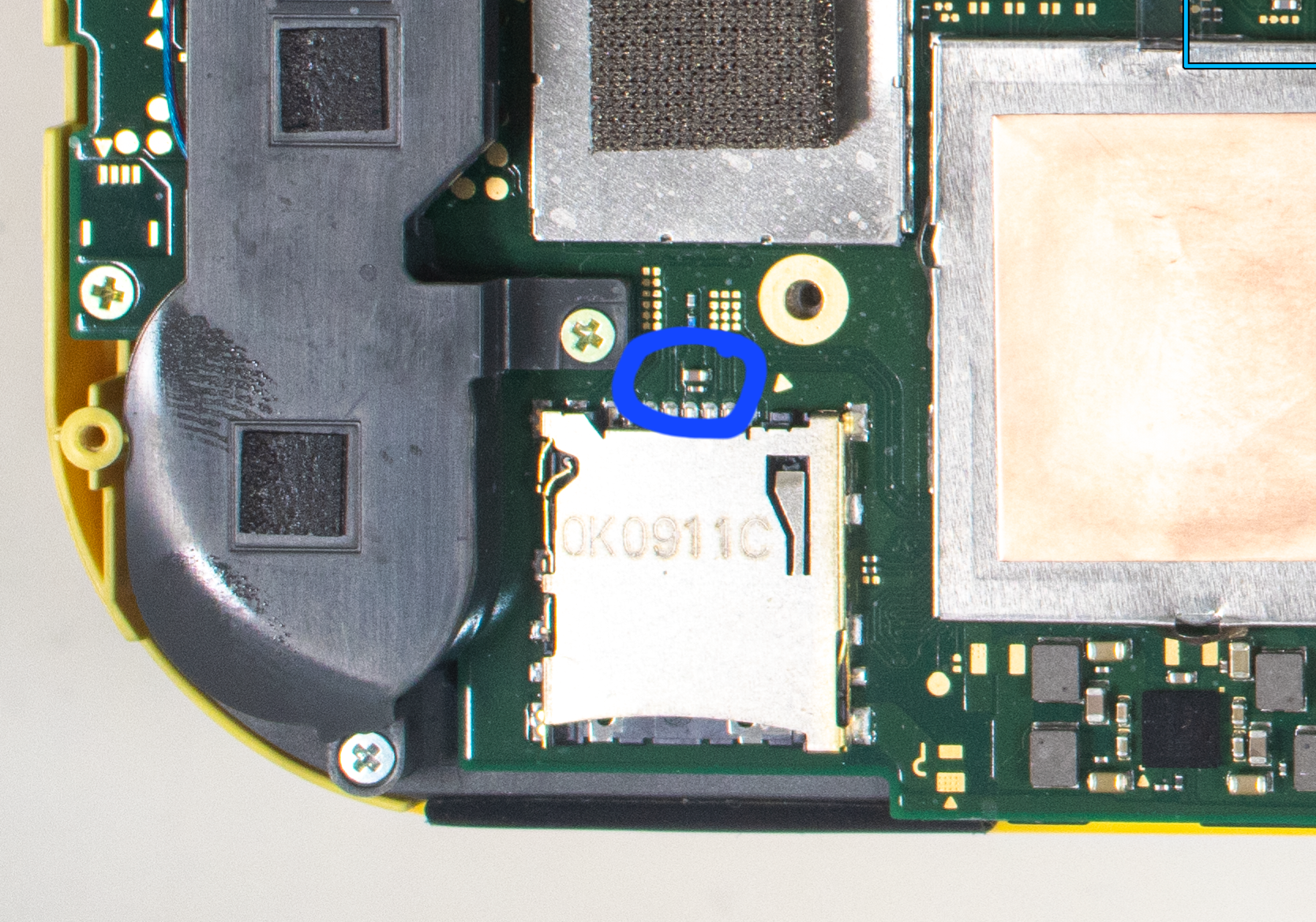

Missing the capacitor on my switch lite in the picture below. What is this cap used for, and what is the value? I mean the larger cap by the way

small one is 0.1uf 6.3v 0201
big one no idea since I no longer have SW lite with me. OLED has a 3.3uF cap next to the slot on the daughter-board where v1/v2 board has 4.7uF on next to connect AFAIR

Definitely related to the SD card reader. Not sure how well it will work with it missing.
yeah i wanted to install instinct chip but I don't think it'll be able to read the SD card with that. hopefully someone comes along with it though
