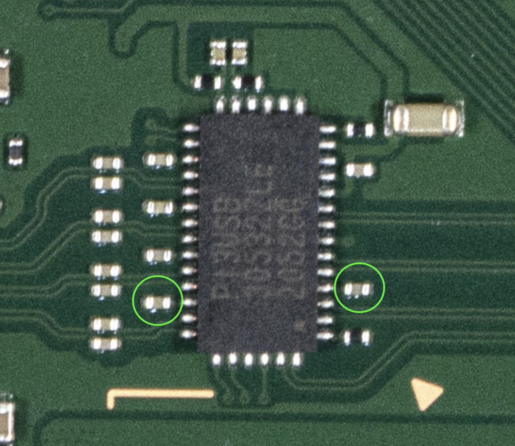

I replaced my P13USB chip on my OLED and in the process destroyed a couple of caps circled above. I was looking to get help identifying the values of these capacitors, but more importantly, I was wondering if the Switch Lite has any of these caps because I have a donor Switch Lite board that was given to me a while back in a trade. Any help would be appreciated!
I've determined that these are 100nf in value, but now I am on the quest to find out where on a Switch Lite I could harvest 100nf capacitors. If anyone knows, please chime in. Thanks!
