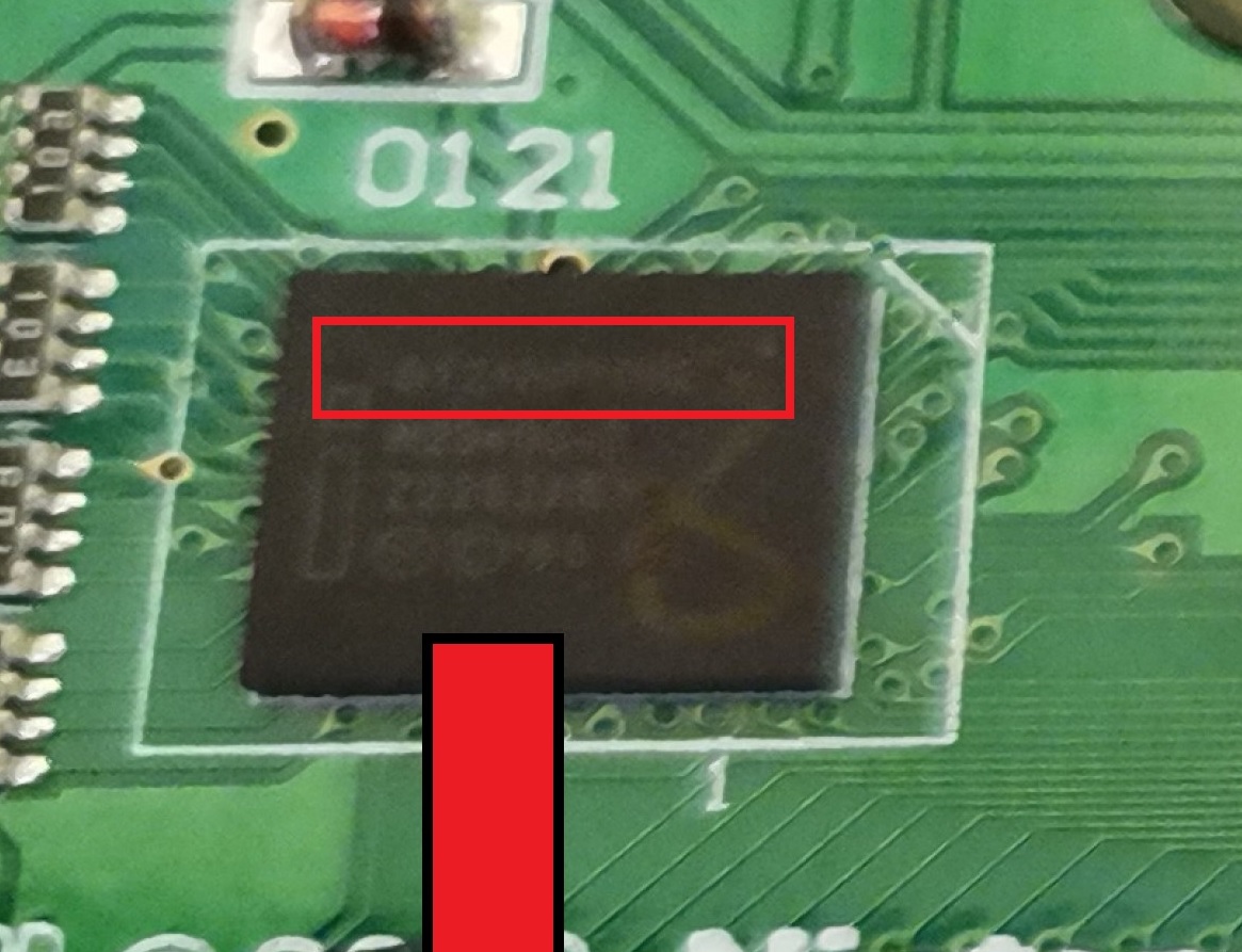

Sure i can try, but i need some chip info. On basic marks)
I hope this is useful to you
Edit: from what i saw in a reddit post, chip 0121 is LG

You could maybe re-trace as to where the pads of the flash chip are to the ones on the cartridge pins to make way for a flash replacement. Here's the datasheet for your chip in question.
  • LH28F128BF_Sharp.pdf
