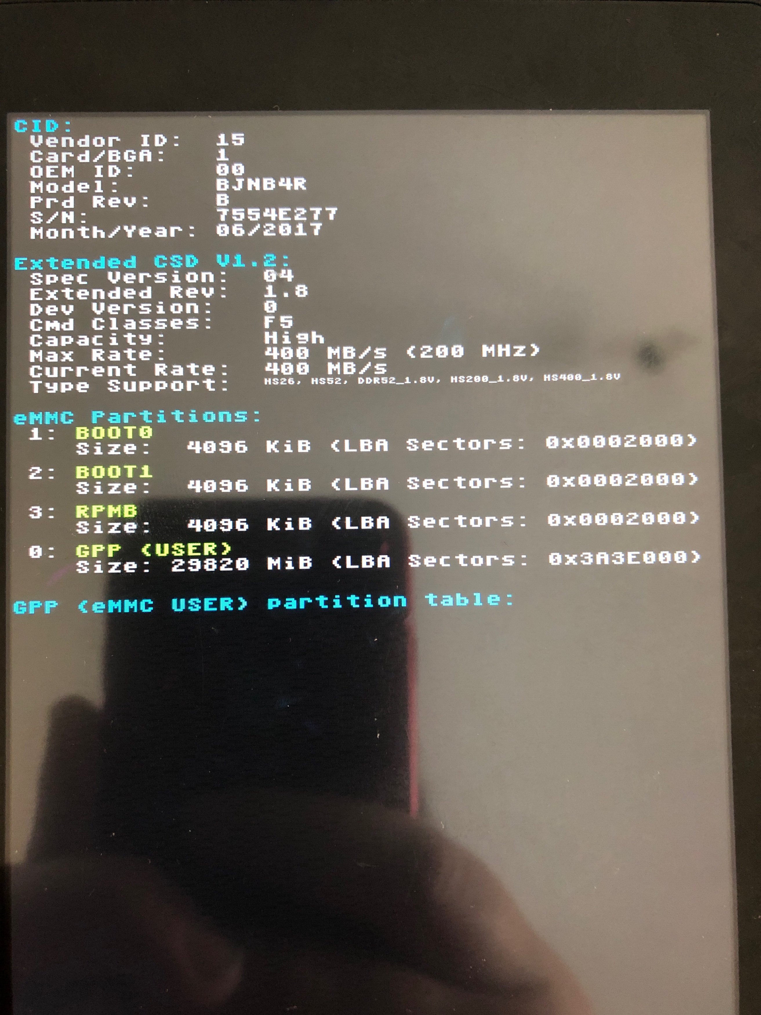

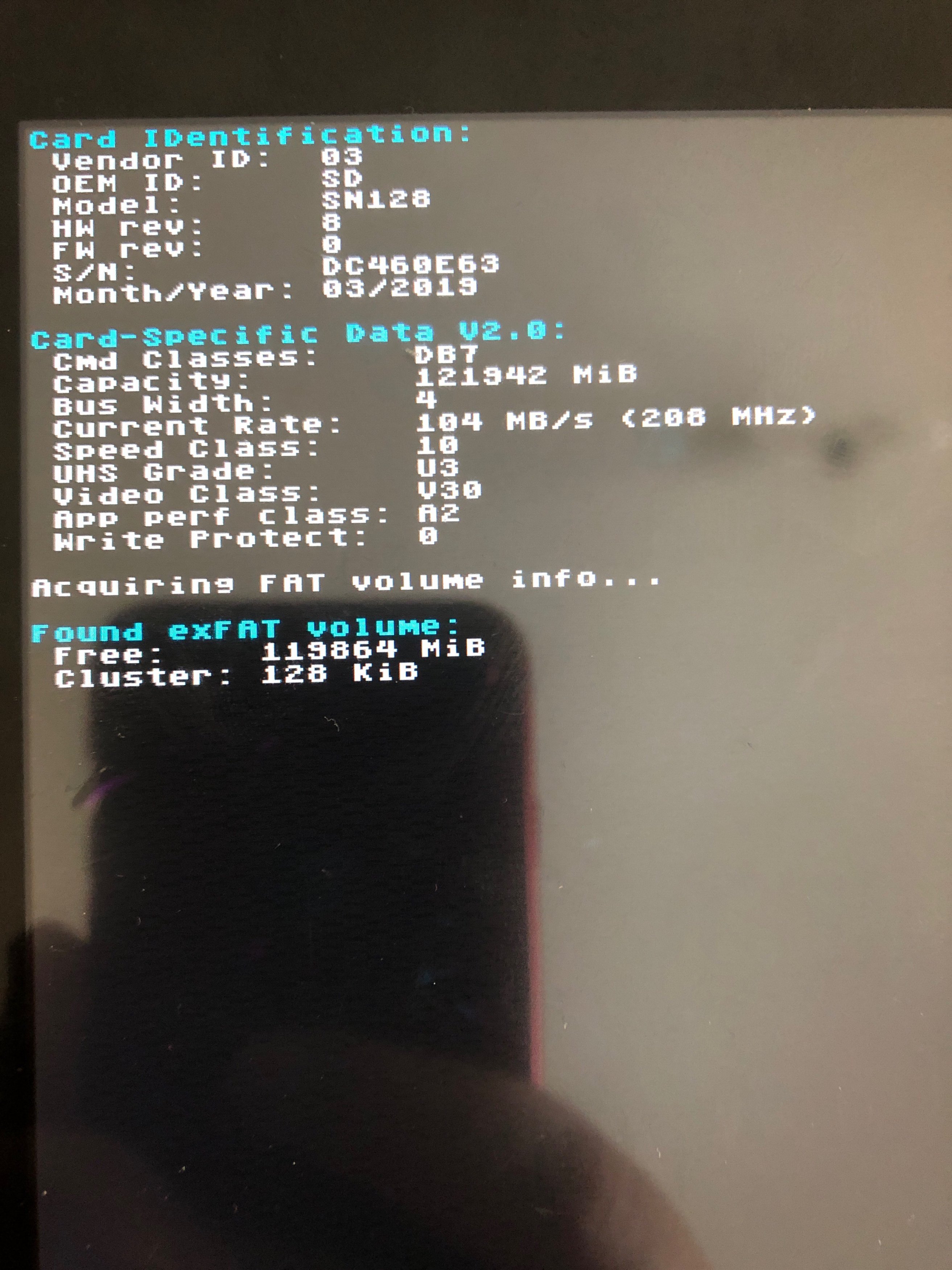

Sure, here you go.
Hekate froze after displaying the eMMC info by the way.
SD Info displayed fine.

If your running hekate without an sd, I imagine someone has messed around with the hardware. Sounds like a trinket is installed. Is the sd card you are inserting blank? I would try that or otherwise try inserting the sd card with the hekate payload already on the root(try as payload.bin). If that doesn’t work, I imagine your sd card reader just doesnt work, and if your in autorcm, as far as i know that means your console is screwed.
Well, formatetd SD Card with payload.bin in toor dir does nothing, device just sits in RCM Mode... However, biskeydump CAN write to the SD and does boot with the SD installed.

There are ways to rebuild a nand image of I'm not mistaken, but first you need to figure out the SD card issue. Have you tried completely formatting the SD card in fat32 to see if it's a issue with the formatting?
Sounds strange, and a bit beyond me. Sorry :( I would not expect Hekate to crash at all reading eMMC, even if it was fried.
If biskeydump is dumping valid keys, Is maybe rebuilding a firmware that matches your current fuse count the best bet? (Expert clarification needed here!)

I hope you have not sent in your console. it is good time to try android on it.
I do have a bricked switch like that. emmc is messed up. but I am using it as a linux tablet now.
