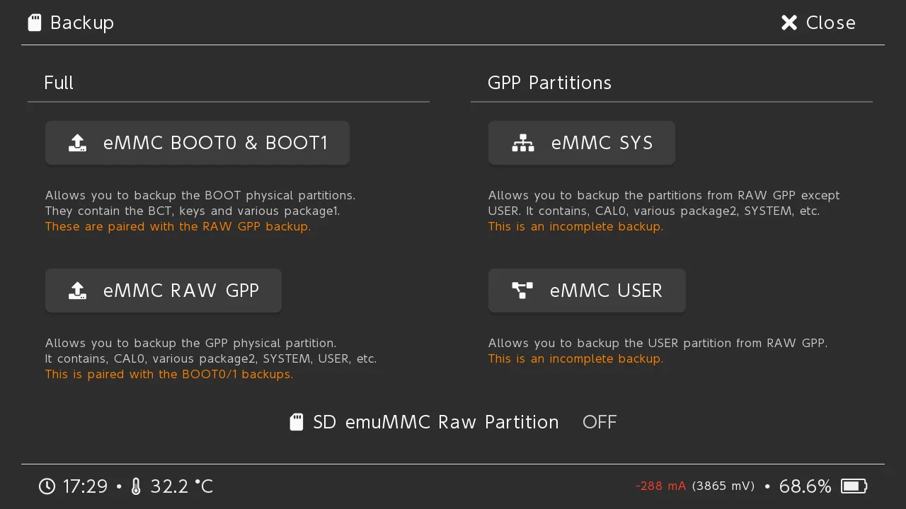

Whenever I turn on my switch I get a blue screen. I am a complete dumbass for doing this but I wish to know if there is a way to fix this issue or if my switch is bricked indefinitely. To start this shit show, I was trying to upgrade my sd card to a bigger sd card through atmosphere by following the re-entry guide for hekate (upgrading your micro-sd card). Around step 21 I got confused and couldn't find the emuMMC option (it was on the home screen I still can't believe I couldn't find it. I ended up choosing random options on the screen below and I clicked on the option eMMC USER (I got frustrated) and immediately turned off the console because I realize it wasn't doing what I wanted. Apparently it was writing on the consoles NAND and I ended up corrupting the console so badly, to the point where I cannot boot my switch without seeing this damned blue screen. I have tried completely powering down the console (Holding the power button until the console powers off) to no avail, I have tried booting into hekate (I'm using autoRCM) and TegraRCM isn't detecting an RCM device. I've tried backing up my console with the backup I had but I can't even boot into hekate to perform a full NAND back-up. Is there a fix for this or am I going to have to purchase a new switch.

The picture shown is for backup nand not resore, so not likely writting anything to emmc though.
If you have a v1 unpatched device, and you have auto_RCM turned on, you could mostly inject payload after cold boot,or remove emmc module before boot and reconnect when you see device detected from PC.
NAND corrupted is not a big deal if you have your prod.key and prodinfo backup, you could always rebuild nand if you dont mind just losing savedata
You might have restored the emummc boot0/1 into sysnand IMO.
Boot your device into RCM mode(using jig or unplug emmc module before boot then plugin again). and resotre boot0/1 either from backup or emmchacgen. Make sure boot0//1 matches you device fuse count.
