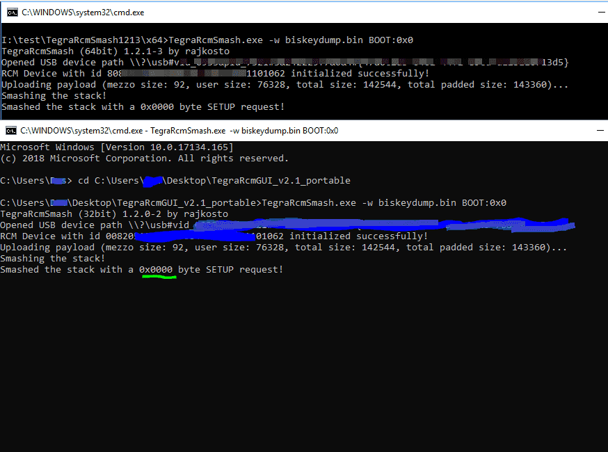

You have to buy a new Switch !!!
The unit you got is patched and it does not accept payload either from USB, NXLoader, SX Pro dongle, etc...
If you are not sure whether it is your cable, please try to inject biskeydump
Go to https://switchtools.sshnuke.net/ to download tegrarcmsmash and biskeydump
Then open a command prompt, plug in your RCM switch and run this command.
TegraRcmSmash.exe -w biskeydump.bin BOOT:0x0
You will see from the output then your switch received payload but it does not execute the payload.
This is from XAJ700439xxxxx: (Not working, no solution as of now)
This is from XAJ7003xxxxxx: (working)
By the way, welcome to the club :cry:

SD card is out of question, you can remove it and test with SX's payload.bin (it will just complain about boot.dat is not found)
Or you can test it with biskeydump.bin
See my 3 posts above on how to run tegrarcmsmash on command line.
You will see in more detail on the command line and you will know exactly if the payload has been sent to your console or not (and it implies if you console is a patched unit or not).

Ok, managed to run the test:
(mine is the one highlighted in green)
Have already shared this on the TX's thread.

Please follow this post to test it.
Because the command line will provide more information so you know what happen. (look at both pictures)

Did you share this in the serial number thread? Yes, this is patched.

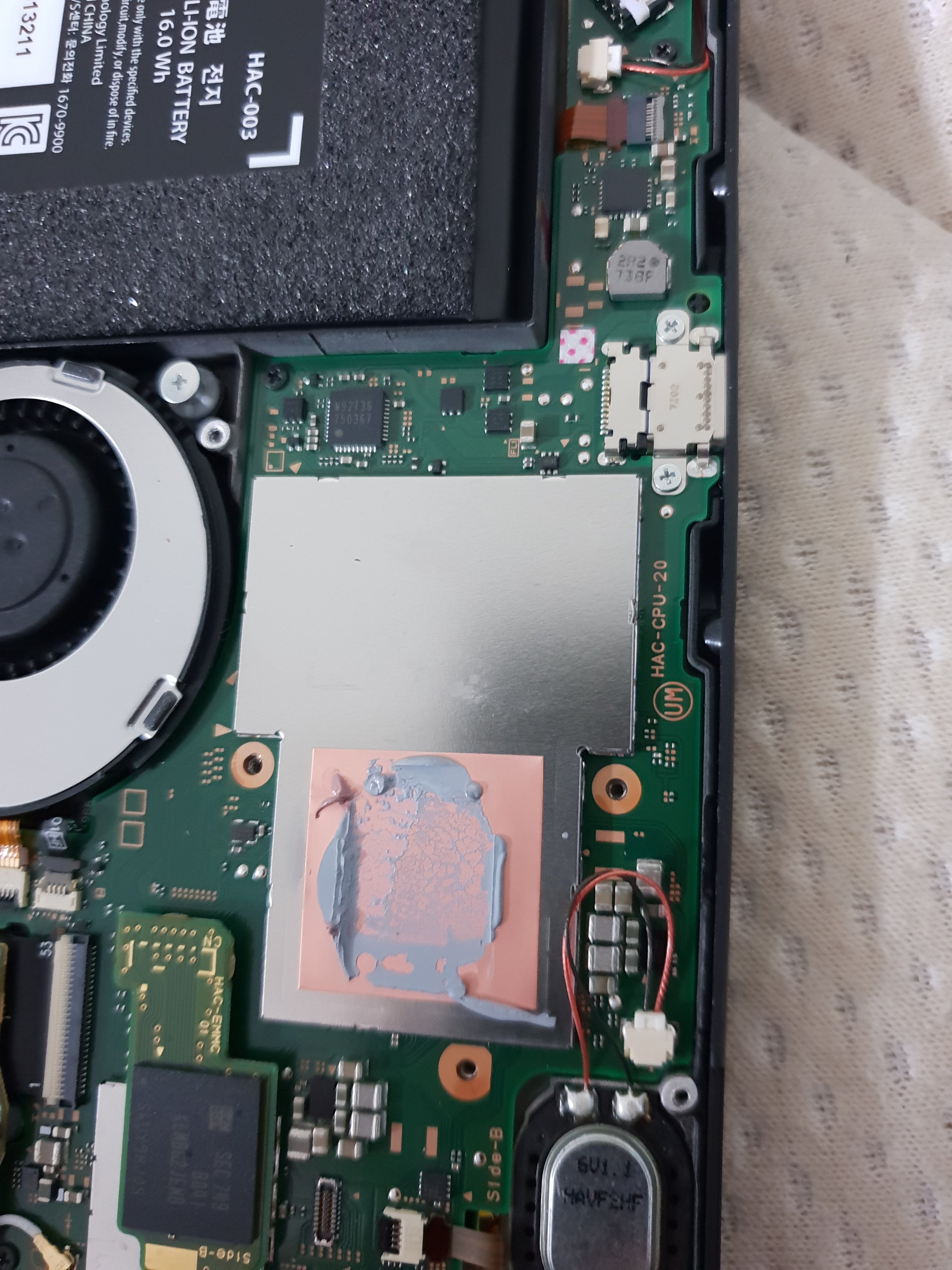

if you can take the back off and see if they changed the motherboard markings should be right next to the usb port, something like
HAC-CPU-10
I would imagine markio units will be
HAC-CPU-20 (assuming there hasn't been other revisions to the pcb prior to the markio
Baught in Australia May 2018, running sx os definetly not mariko
