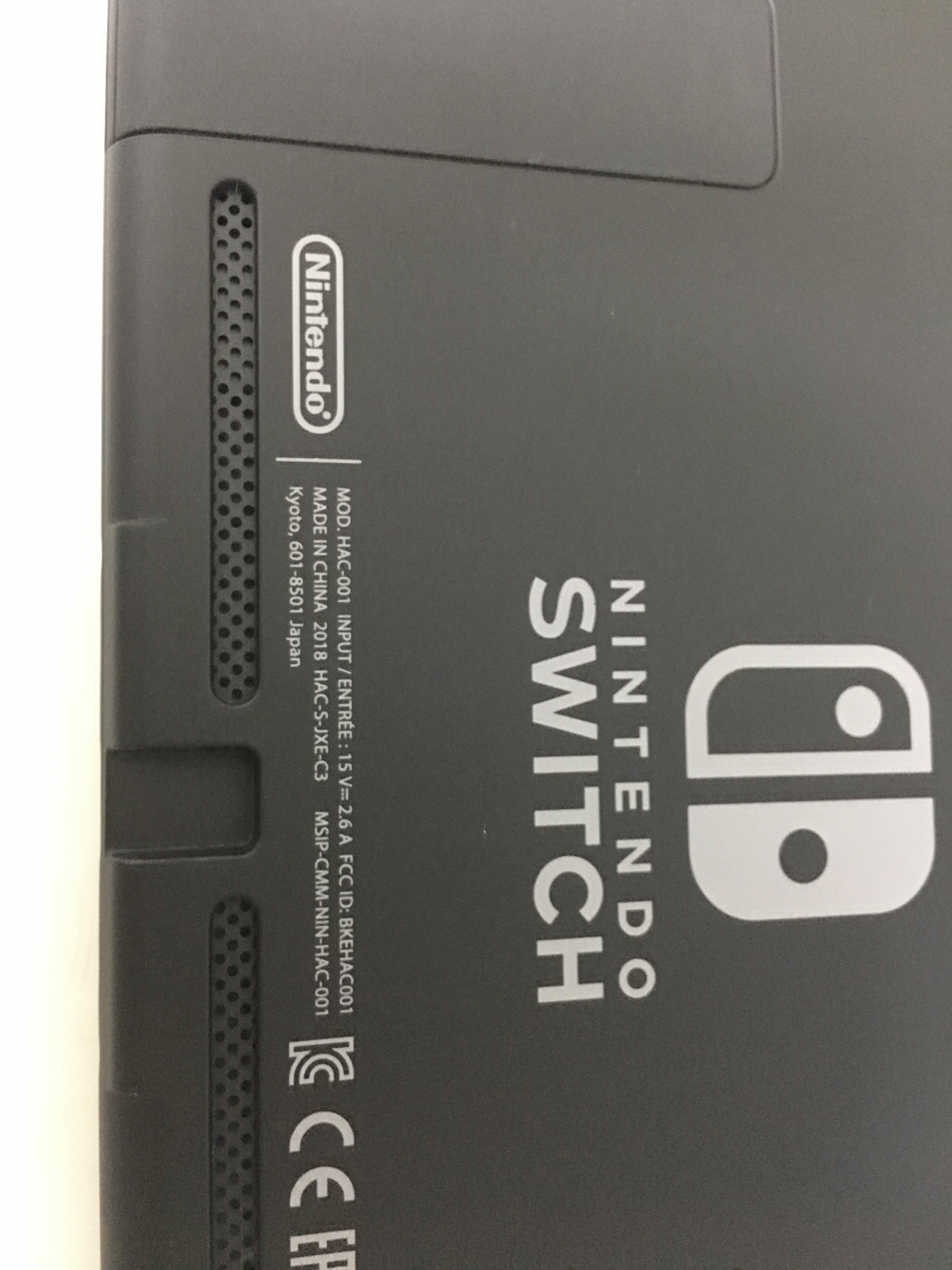

Hi I get a similar problem in rcm that sx pro doesn't recognize my sd card and boot failed with a boot.dat? screen. I have tried many different ways to boot my sx pro in rcm, but all failed. l post it here to see if the same RCM problem.
Bought date: May 28.
Initial version:4.1.0, now have updated to 5.1.0.
Model: 2018 HAC-S-JXE-C3
SN:XAJ7003767xxxx

Can you give it another try with a different micro sd card and putting the boot.dat inside? Also, try formatting it again just in case, it seems like the micro sd is the thing that's giving you a hard time, not the sx os itself.

that's a different issue, the payload is booting on your system, its just not reading the boot.dat file from the SD, try reformatting your card with this
https://fat32-format.en.softonic.com/

that's not the problem. I created that thread he posted and nothing works on that switch. I have a second switch and the sd cards work fine to load the payloads. It seems some ipatches just block the payloads access to the micro sd card.

XAJ7003XXXXXX are probably the last unpached units and XAJ7004XXXXXXX are the patched ones. But it is all still just speculation.
