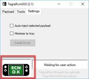

3. Plug in USB cable from your PC to Switch(in RCM).
Open TegraRcm GUI and you should see this window with "RCM OK".
Alternatively, you can use Device Manager to confirm if the APX device is recognized.
Now you can close the TegraRcm GUI application.

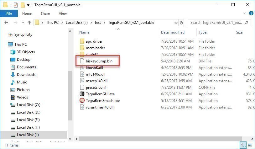

4. Copy biskeydump.bin to the TegraRcm GUI folder.

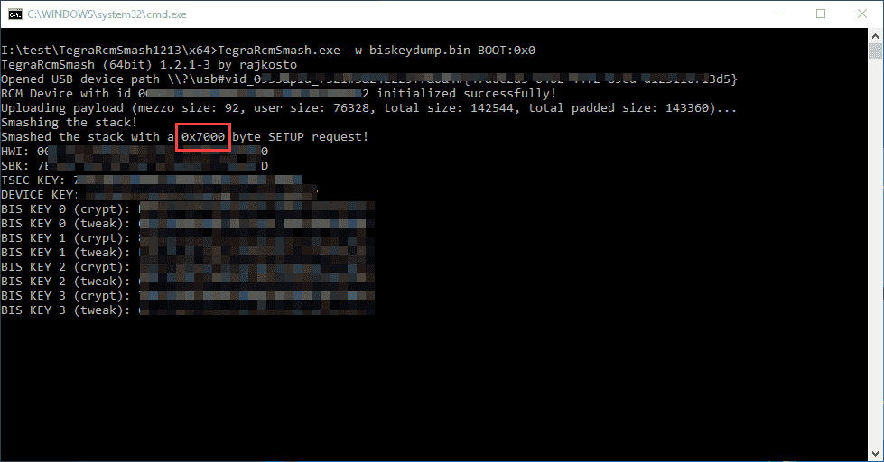

5. Open a command line and go to the TegraRcm GUI folder.
6. Run this on the command line
TegraRcmSmash.exe -w biskeydump.bin BOOT:0x0
7. Check the result
7.1 Switch accepts and executes payload, which mean your Switch is not patched.
Please refer to 0X7000
You will also see QR code on your Switch screen.
7.2 Switch accepts but does not executes payload, which means your Switch is patched.
Please refer to 0X0000
