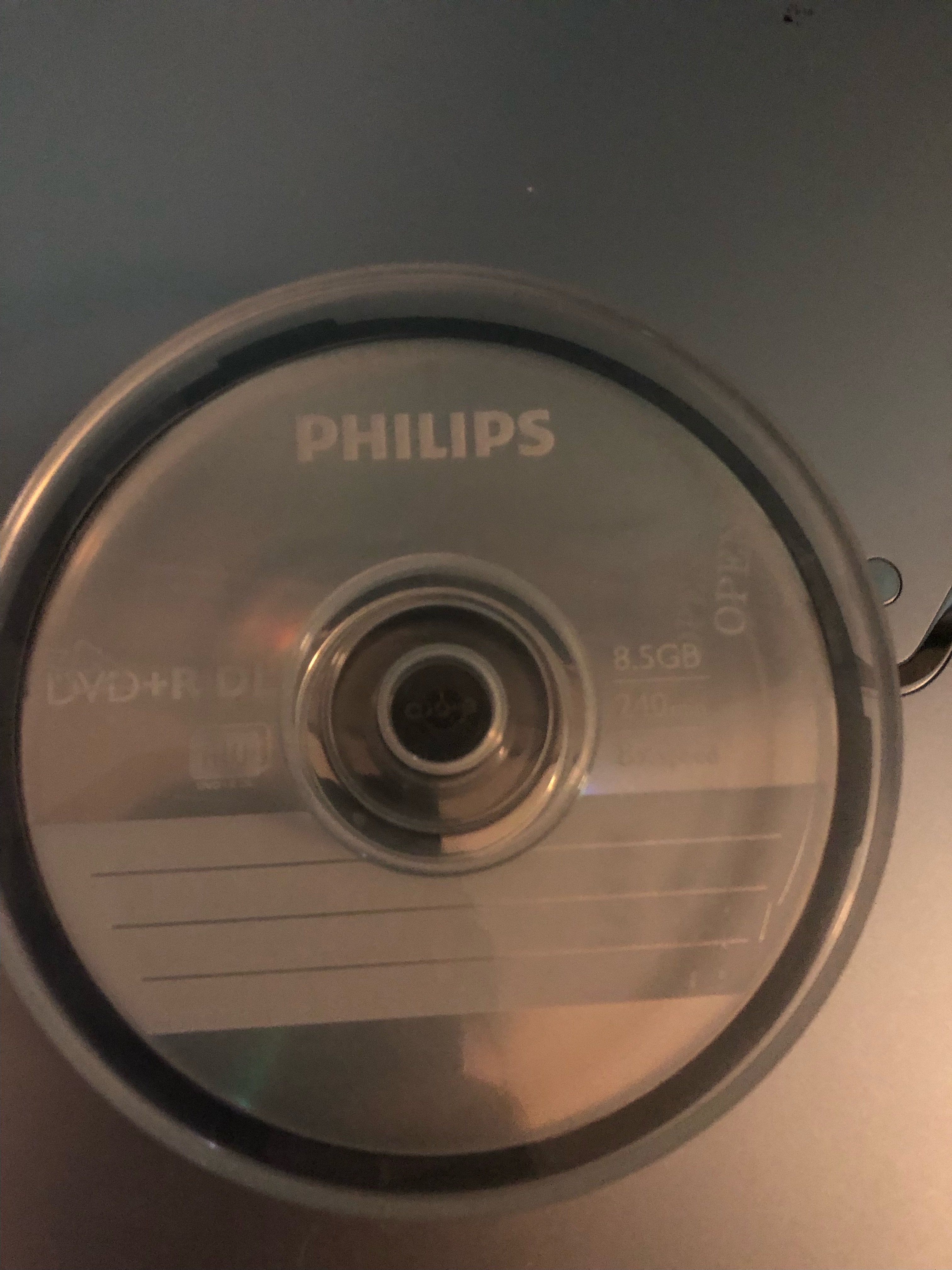

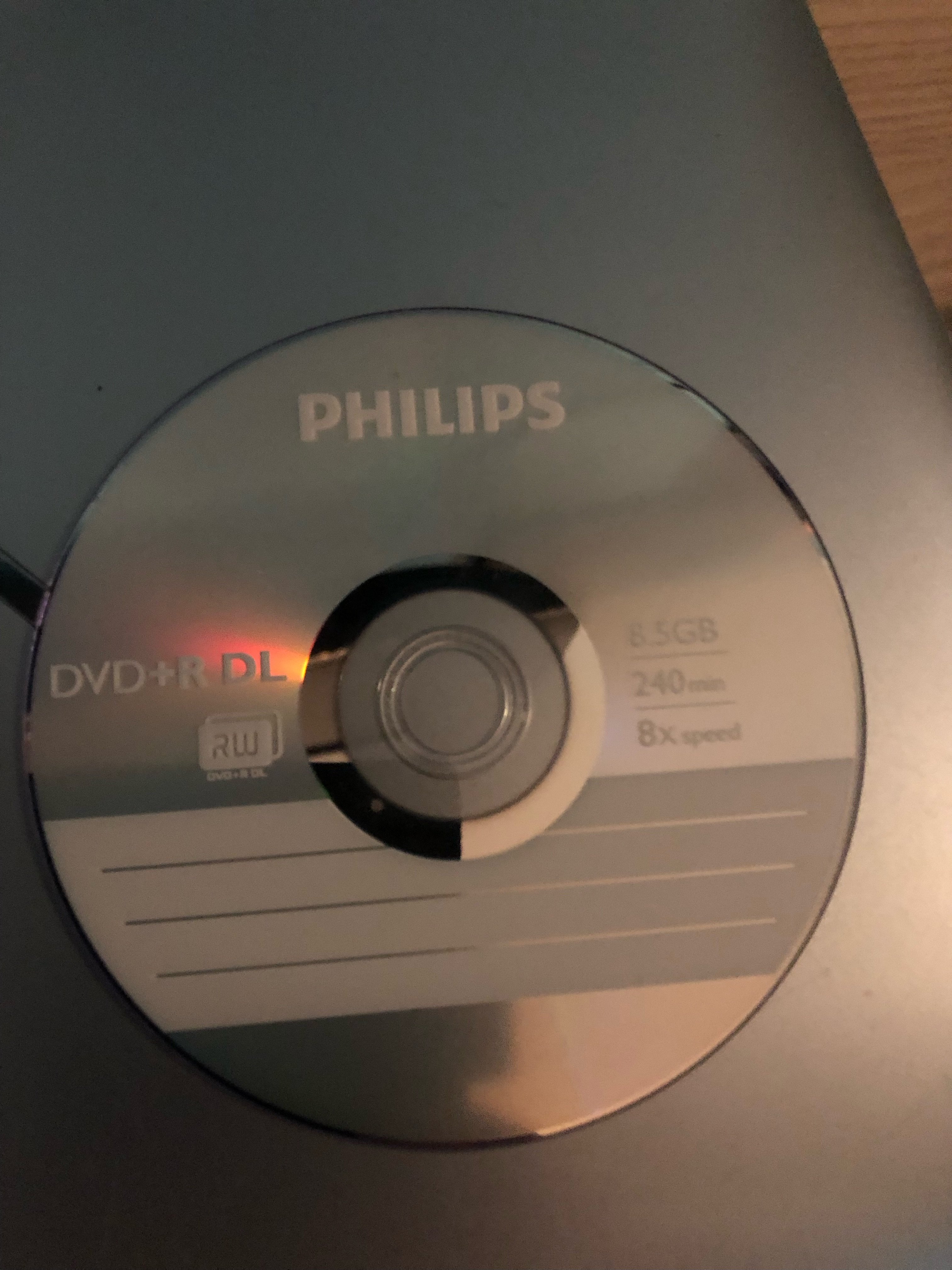

So, I want to burn an ISO of iATKOS to a CD on Brasero, since you can't flash the ISO onto a USB drive. I have around nine or ten blank CDs that say they have 8.5 gigabytes of storage. But, for some reason, the blank CDs are smaller in storage. I'm not sure if it's a problem on my end or what. Any suggestions on what I can do?
In my entire life, I have never seen an 8.5GB CD-R. Only dual-layer DVD-R discs have around 8.5GB. Sony attempted to create the DD CD-R format that can hold 1.3GB which is similar to what you described, however it was never successful, and the discs and drives are very difficult to locate.
Would you mind sharing some photos of these discs?
Got these from Amazon.
And yes, they are DVD-R. Don't know why I called them CDs, but oh well.

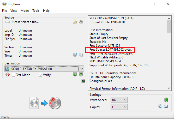

DVD+R DL should have about 8,500,000,000 Bytes. It results in a little below 8GB of memory.
This is the usual 1000 vs 1024 calculation.
The best you can do is increase it by roughly 200MB with the help of BurnerMAX payload.
Success in this depends on two things:
A) Drive accepting BurnerMAX payload​
B) High quality blanks writeable/readable outside the intended diameter​
I would advise against trusting DVD+R DL burned beyond normal capacity
Anything beyond the value on my second screenshot is out of range for DVD and would require BD when sticking to optical discs.
