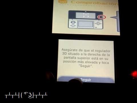

- A 2ds with a format brick (stuck on the 'please turn up the 3d slider' during system setup).

1. Insert your Cubic Ninja/Sky3ds cartridge, and hold A+B+X+Y+RT and turn on the power.
2. Clear any previous Cubic Ninja save. Hold X+Y+LT+RT on the 'Menu' Screen (the one after the title screen).
3. Scan the QR. The app should tell you if it worked or it. (on the older qr: Light grey screen is success, black signals an error)
4. Power off the system and restart it. That long-lost Home Menu should appear like magic!
5. Make sure you go back to system settings to set your user name, language, region/state etc., birthdate, and time as these not being initialized could limit the operation of system apps like the browser. Thanks @SolMeiLei for this info.
