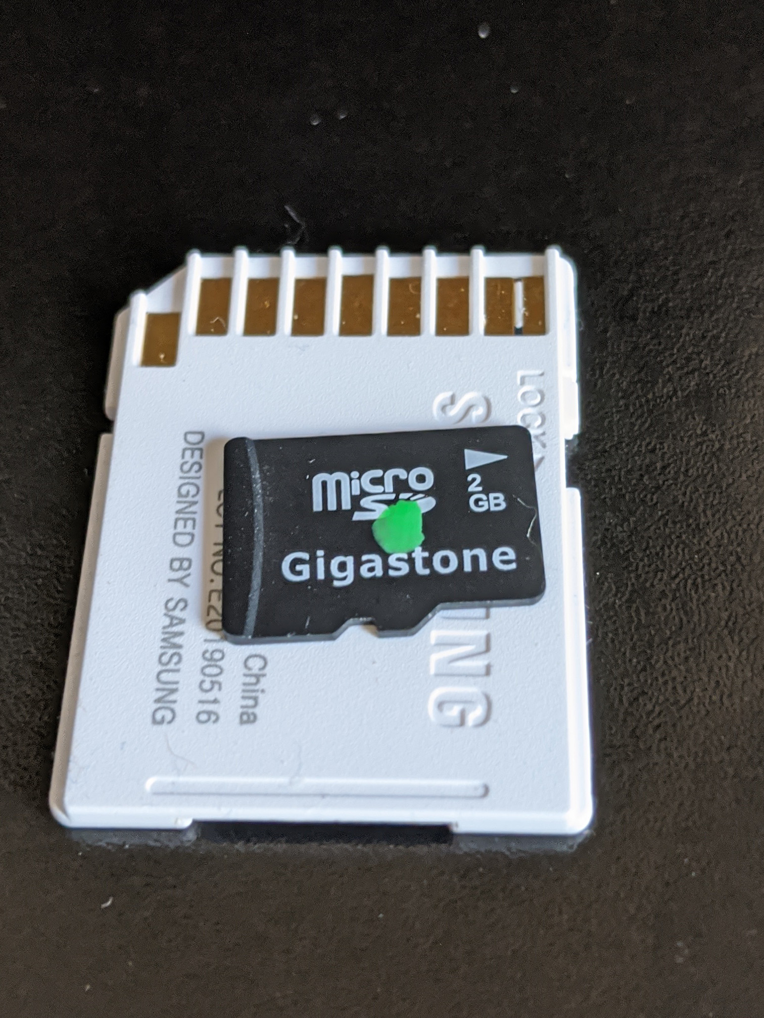

Solved: So it turns out the problem was that crappy SD card was intermittently failing. I solved the problem by writing the base 1.30 xk3y image to a spare SanDisk card, copying my firmware.bin, xkey.cfg, and updating the uImage and rootfs firmware files like @DinohScene mentioned. I took a couple unnecessary steps along the way, but I'm just so thankful everything worked out. Thanks to everyone for the help!
FILES:
•USB Image Tool: https://www.mediafire.com/file/s2spewj09vkzyrm/xKey_USB_Image_Tool_1.90.zip/file
•MicroSD Card Images: https://www.mediafire.com/file/e4nq3cvb1i79laq/xKey_MicroSD_Images_1.06.zip/file
NOTE: There are 3 images in the zip file. As per the original instructions from xKey:
-Use Type A for MicroSD > 128mb. (1gb, 2gb, 4gb, etc).
-Use Type B for NOT original 128mb MicroSD.
-Use Type C for original xKey MicroSD (with a green dot on it).
STEPS:
•Unzip "USB Image Tool".
•Unzip the SD card image file into the same directory as USB Image Tool.
•Insert your MicroSD card & note the drive letter Windows assigns to it.
•Run USB Image Tool (run it as Administrator).
•Make sure the USB Image Tool is in "Device Mode".
•Select your MicroSD card from the list of drives.
•Click the "Restore" button in USB Image Tool and then select the MicroSD card image file you unzipped previously.
•Wait a few seconds for USB Image Tool to do its thing.
•Eject/Safely Remove the MicroSD card.
You now have a factory reset MicroSD card with xKey firmware ready to use.
Just add your firmware/dummy.bin file and test in your xKey.
