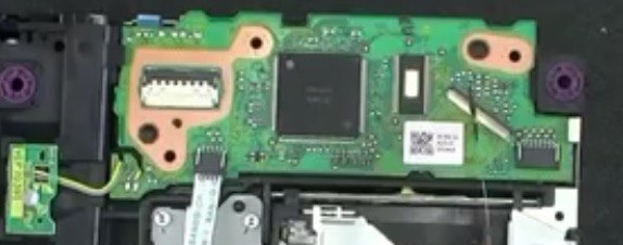

The driver board with the litle board ( 2 wires ), is what i have connected and never gotten a error, even when the wiiu knows the drive its faulty ( seen logs in the system )
As for more power, i added a wire from the ports in the front ;)
More pictures in the other threat.

Yes, the drive mobo with the litle mobo ( 2 wires )
Here is some pics

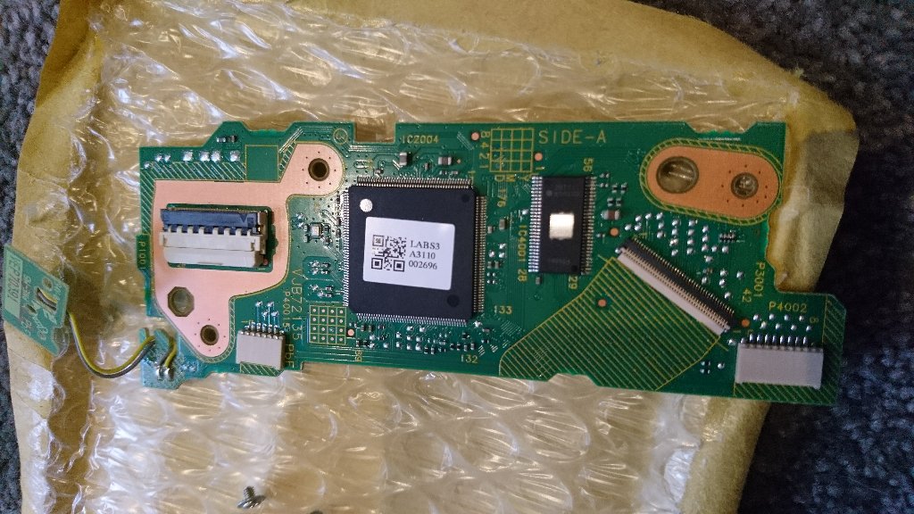

Ok I did this yesterday, I removed my disk drive from my wii u so I can sell it because I only play digital games.
The two screws holding the front panel (power button and sd card area), the two screws securing that to the drive brackets are very very tight and difficult to remove.
Thankfully I had some nice JIS screwdrivers that eventually got them out.
Here are some pictures.
The wii u with the drive:
The board removed from the drive:
The board covered in tape, connected to the wii u:

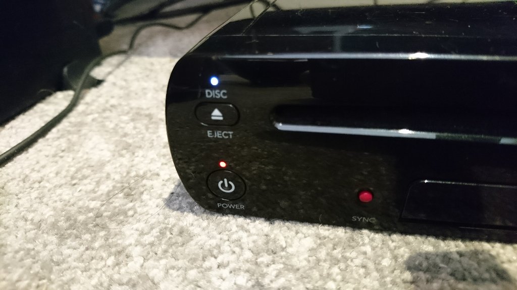

It works great! I like that I don't hear the drive when I turn it on, or go into wii mode.
One issue, I don't remember seeing this white led before, has this always been on? Is it on for other people who did this 'mod' too?
Thanks :)
Thanks :)
That LED indicates that there's a disc inside the drive. Must be a side effect of the "trick".

I got a system on ebay with a bad drive, modded it and removed the drive leaving the drive system board like Cearp did and everything works. FYI the white LED for me is only on when the system is off the light turns off when the system is running.
