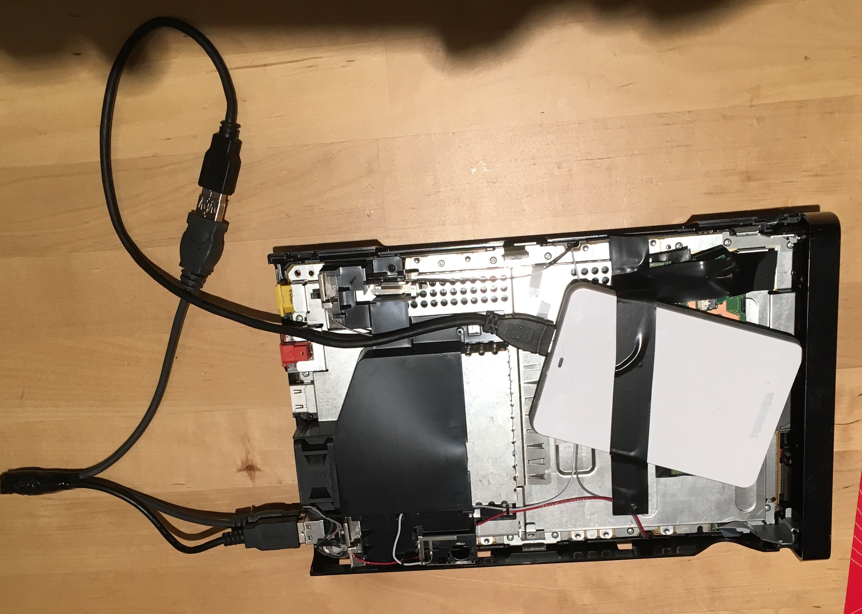

Sorry for bumpin, but i have been wondering about this for some time.
Today i did it, and it works :-D
Edit: im going to do this better, but now it just a proof.
One thing tho, i had to let the driver mobo connected

I have treid and it works
Have no error in the system menu or after, and it plays games from USB.
I did get error when i didt had the motherboard from the drive connected

Then its done, works also
Nice and then?
I going to install i switch, that would alowe me to just use one of the hdds at the time.
Becouse in vwii having two hdds gives error in nintendont.
One thing thats cool is that i think that i am able to connect the wiiu' now extra hdds to a PC with a male to male USB :)
