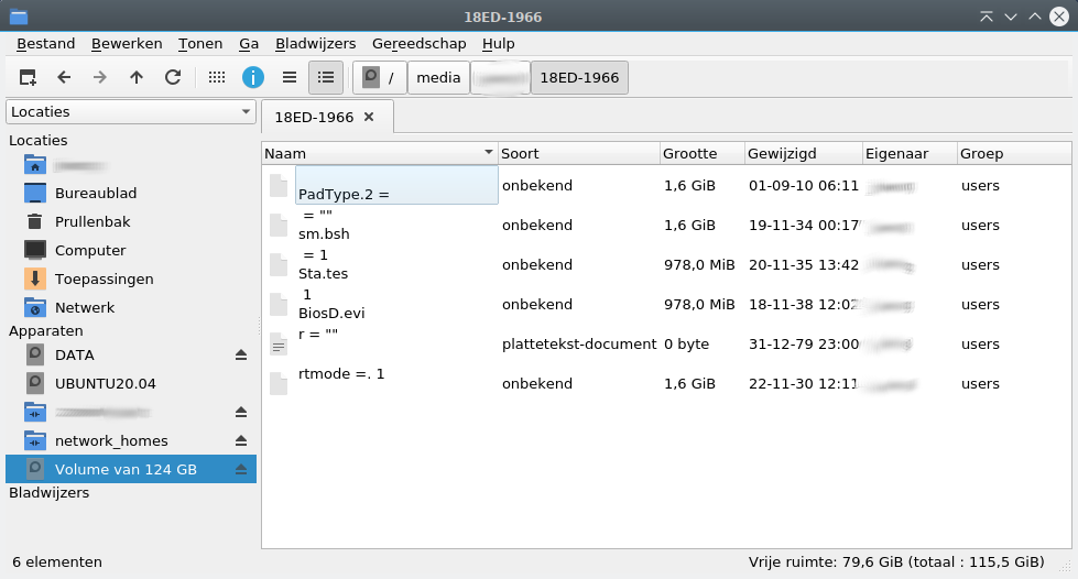

It seems like this emulator can corrupt the FAT32 filesystem on a USB-drive when saving settings to it :O
I was suprised to see a PSX emulator for the Wii and I decided to give it a try (playing Crash Bash), putting it on USB. But after hitting the button in "Settings" to save the settings to USB, it corrupted the filesystem on my 128GB USB-drive :O In just a couple of seconds 35GB of Wii-games are gone :cry:
The Wii didn't saw the drive anymore from that point and on my PC I see strange named files like "PadType.2 =", "1'$'\n''BiosD.evi", "= 1'$'\n''Sta.tes", "= ""'$'\n''sm.bsh" and "rtmode =. 1'$'\n" which reassembled words from the settings screen :wacko: The files seem to be 6,6GB but in total still 36GB is in use. The whole filesystem (at least the FAT) is messed up...
Maybe this is just bad luck or is it a bug?

My first reaction to any possibly corrupted partitions is to run TestDisk and have it scan and write the partition information that it finds.
The thing is, a lot of times the you can have a partition table that's corrupted without any of the actual data itself being corrupted, and so simply re-creating the partition table may be all that is necessary.

well flashdrives are never recomended for homebrew in general, either use an hdd or sd card.

After TestDisk the games gone back, but some filenames were corrupted. And the partition was shifted, left 100MB+ of unused space at the beginning of the disk :(
So I've decided to just repartition and reformat the drive... i'm now copying all the games back to it from the PC... very slow.

This right here is one of the big benefits of using an internal SATA drive with a known-working USB adapter or enclosure - you can instead just connect the drive via SATA, eSATA, or another adapter with USB 3.2/USB4/Thunderbolt/etc to facilitate much faster copying speeds (especially if it's an SSD).

Very bold claim you make there without reproducing it and showing video proof. :blink:
I have personally used generic flash drives (PNY, Kingston, SanDisk), failing 2.5'' and 3.5 hard drives through cheapo no-name usb to sata adapters, generic micro SD with USB adapter, branded micro SD with USB adapter (Samsung, SanDisk, PNY), not a single corruption ever with any emulator, specially WiiSXRX, whether on loading or saving settings. Ever. And boy oh boy have i obliterated all that media with tests, copying and writing.
Sadly, your USB drive is almost 98% sure crap, probably one of those rare cases of not being 100% compatible with the Wii, or suffering from a bad partition from before, who knows. Use a good partition software, and try to start fresh. Otherwise change to another brand.
